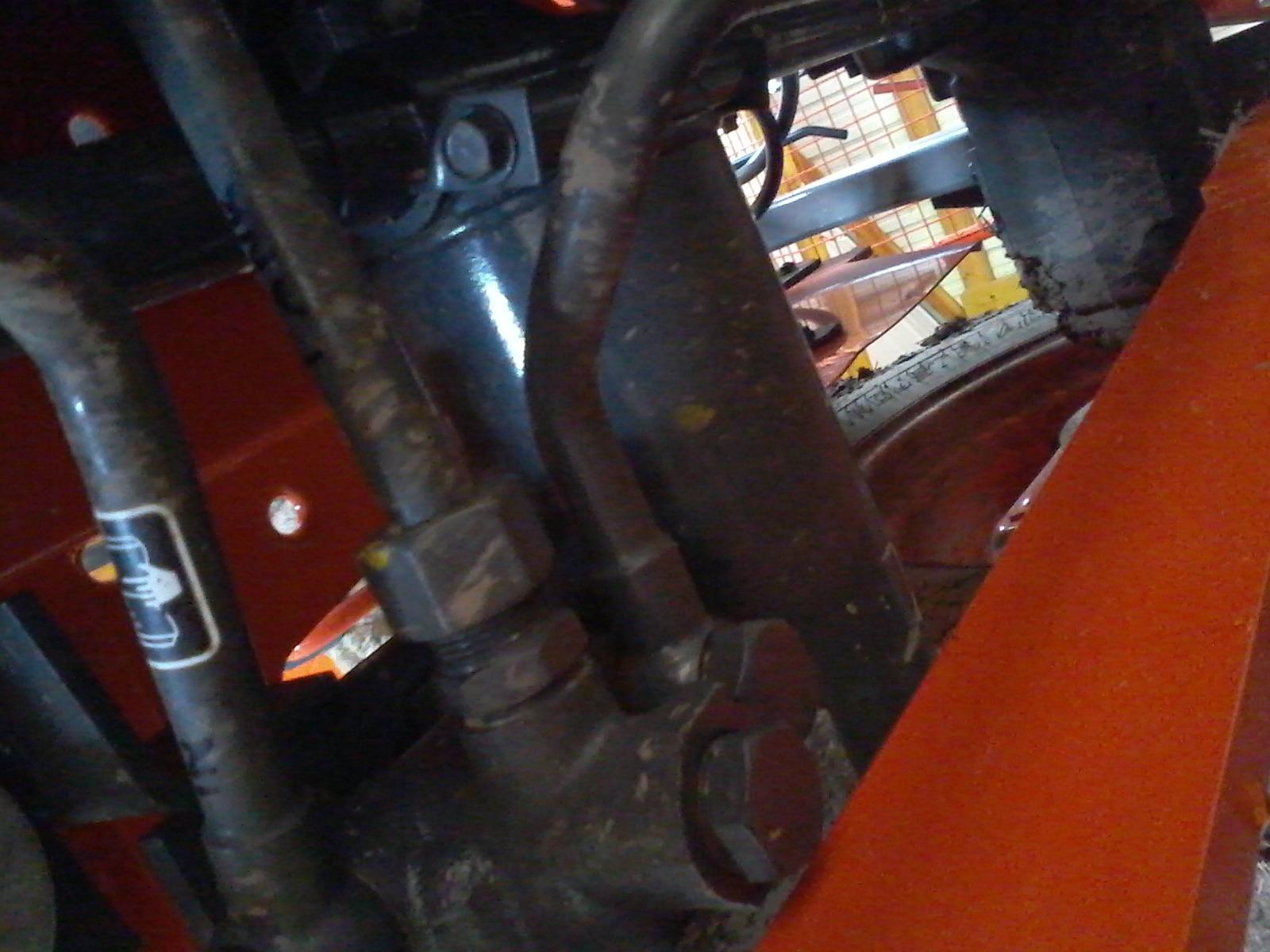

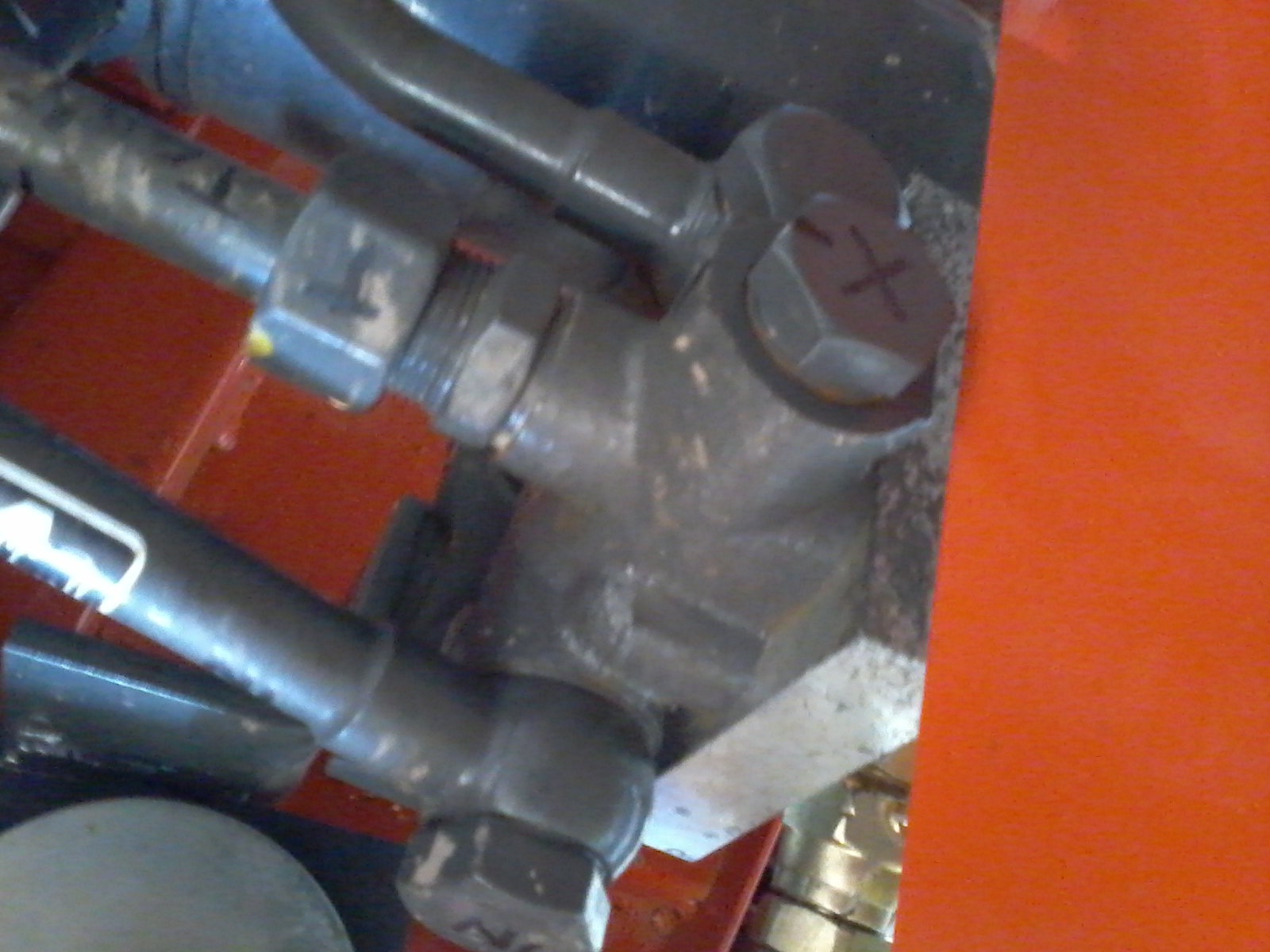

I am not so good when it comes to computers. Pictures are hard for me to do consitently. I apologize. Local kubota dealer told me that the "tractor relief valve" is where you say the saftey valve is. And that the rear remotes are tied in with it.
I took pictures of the under side of the hyd block, where you say the tractor relief valve is and also of the rear remote valve and loader valve.
I think I know where the relief valve is on loader valve.
I don't see anything like that by the rear remote or hyd block. The hyd block has those 2 larger bolt heads on the power beyond line and tank line are all I can think of could be a pressure relief?? Is it one of these bolt heads?
The larger bolt on the bottom of the rear remote valve was just a cap over the valve lever rod/spring. When I removed it I saw the spring with a nut at the bottom of it. I can try more pictures if you would like.

Bottom of the hyd blk is your relief, and it has shims for adjustment.

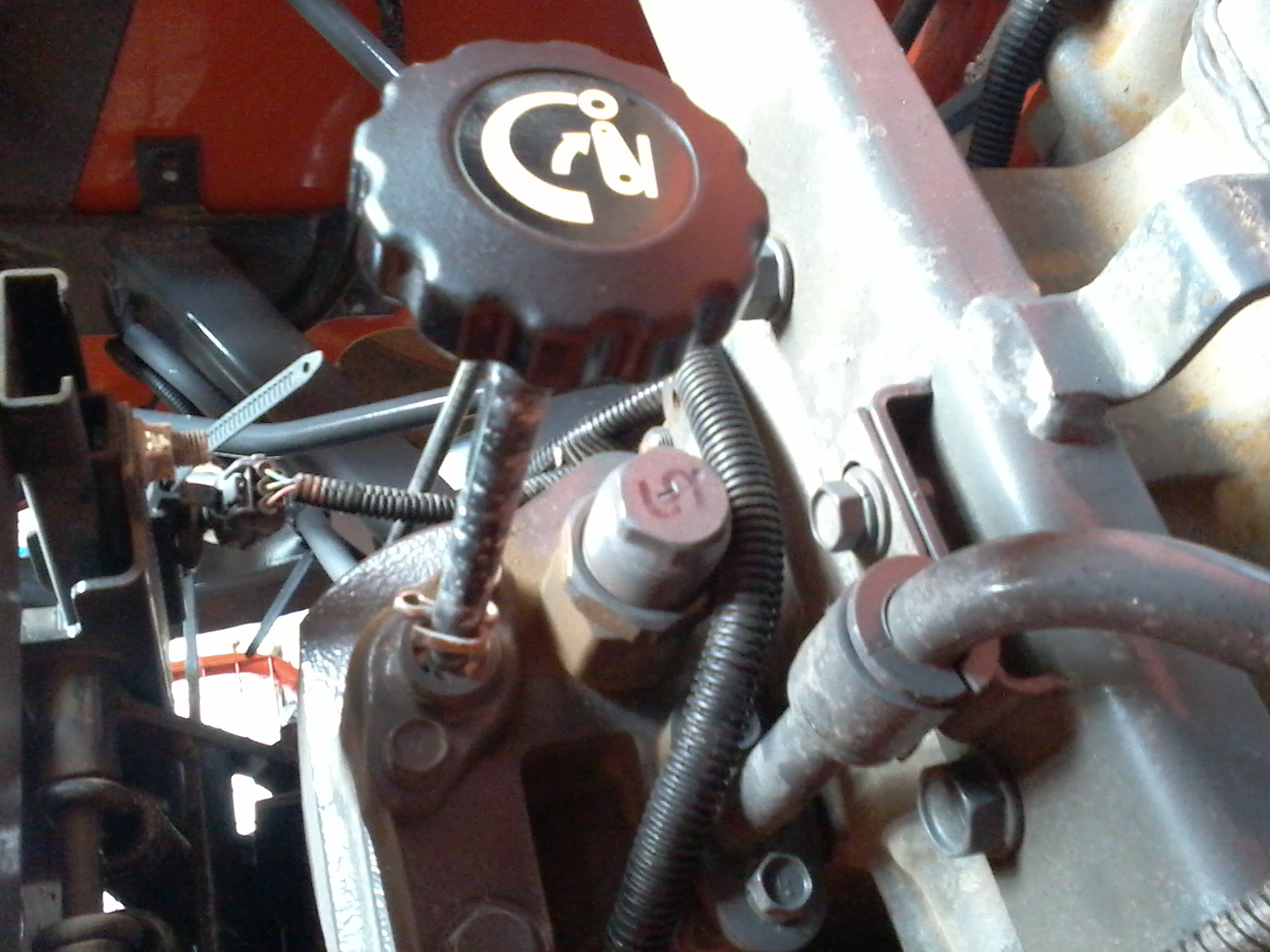

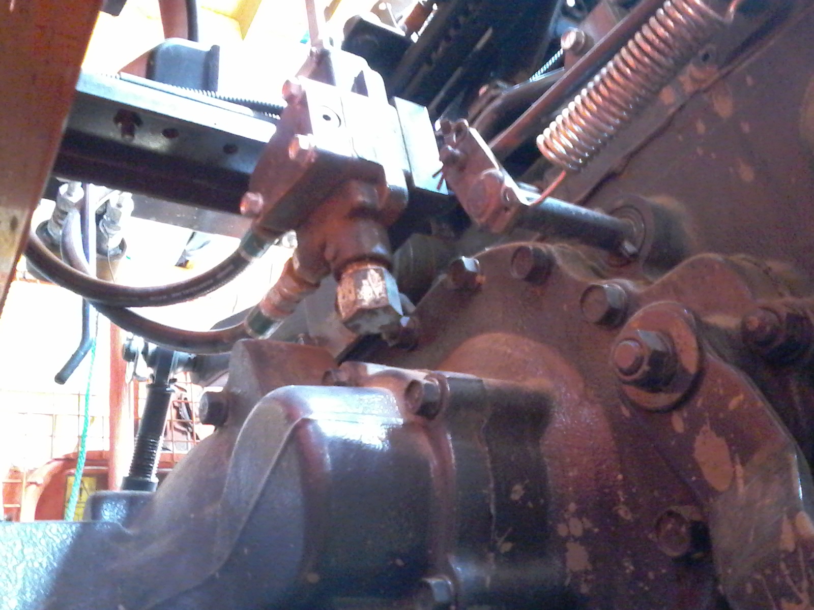

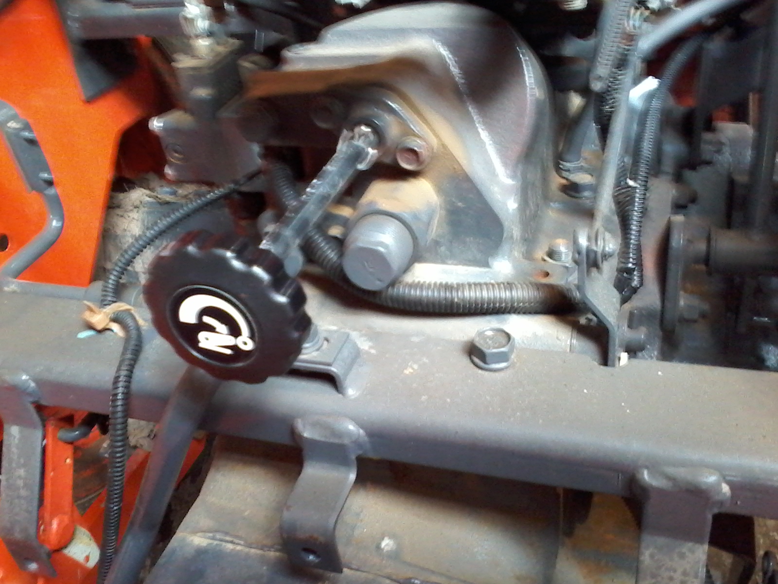

Ok, I removed some covers and have some more pictures of saftey valve and rear remote area. Hopefully better quality then others.

Large hex bolt on bottom of hyd blk is your relief.

If you look at the 3pt area. you will see the safety valve.

Ok, the large hex head on bottom of hyd block I believe we are both talking about the same one. It appears to be underneath or connected near tank line. The one I drew a black X on?? Do I just turn this to adjust relief?
The saftey valve on 3pt area is the one I marked with an S ???
The rear remote valve appears to be kubota double acting valve (L8303) with a kubota 1st lever and base kit (MX8451)

The hyd blk has shims to adjust the pressure.
You add the correct shims to adjust the pressure. They come in a shim kit pkg.
If a valve has a relief valve , it is usually on top by lever and close to the IN port.
Your tractor relief on hyd blk should be set to 2631 psi.
It may be hard for you to check the tractor setting as it is inline with the other reliefs.
