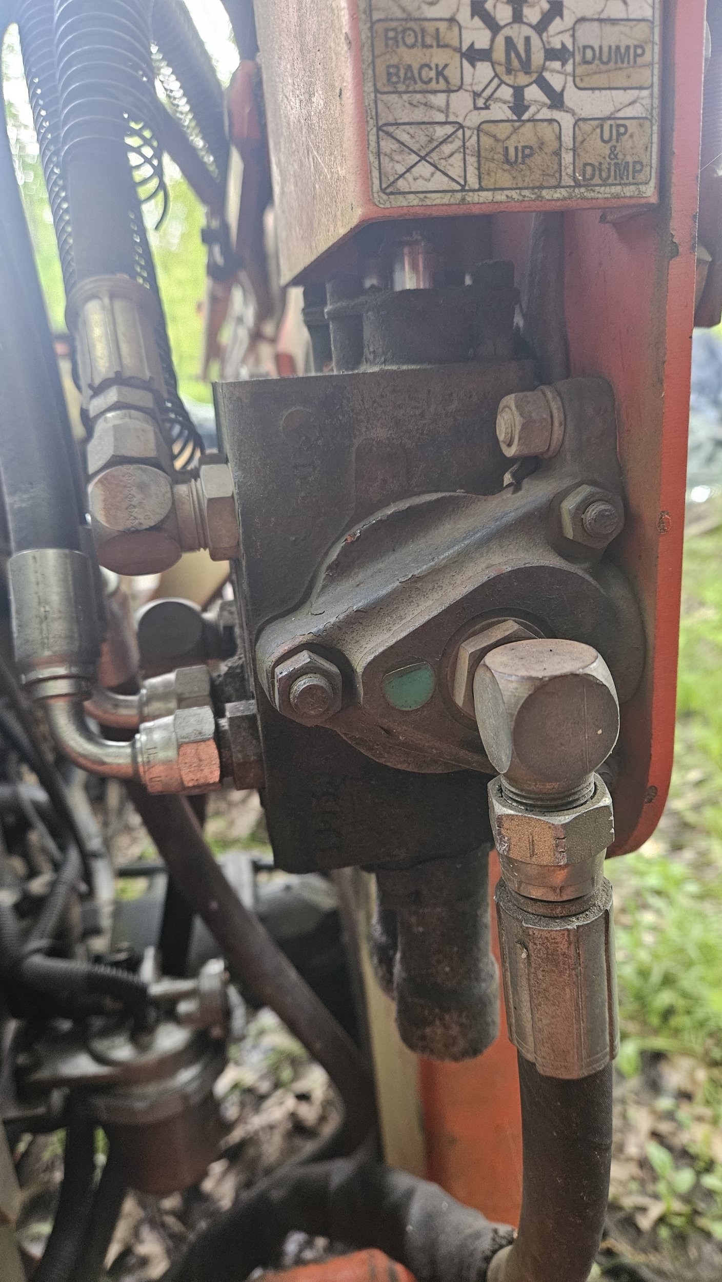

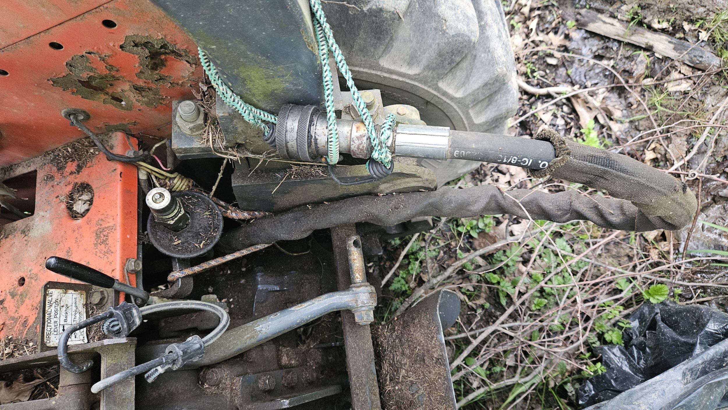

Okay, they had the two hoses left like this in the photo. I was wondering if one needed to plug the two hoses back together, as to close the loop or avoid leaking? I am not sure if what I am thinking makes sense. Could you explain how this works?

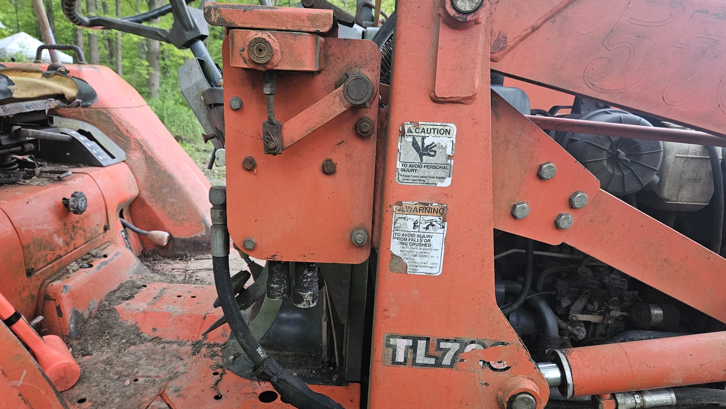

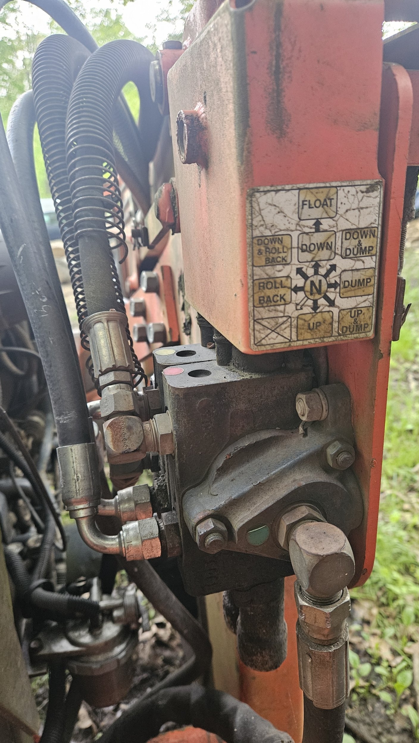

I have photos of the FEL control valve, because it was pretty wet right below it. I'll look at the manual for this valve. Is there a name for it?
The hose must be coupled to the connector as shown. Then the valve must also be switched as shown in the manual. Mine is a wire loop on the back of the tractor, has nothing to do with the FEL valve.
   / Possibly L35 Kubota? And where to download Manual or Service Manual? #13
You don't need to connect the hoses together just move that black lever to 3 point hitch from the backhoe position then take the hoses off and the backhoe off.....
If the hoses for the backhoe aren't connected when the backhoe is off, the power beyond circuit will be blocked and the pump will be dead-headed against the relief valve.
Also, no flow will be available for the 3ph.

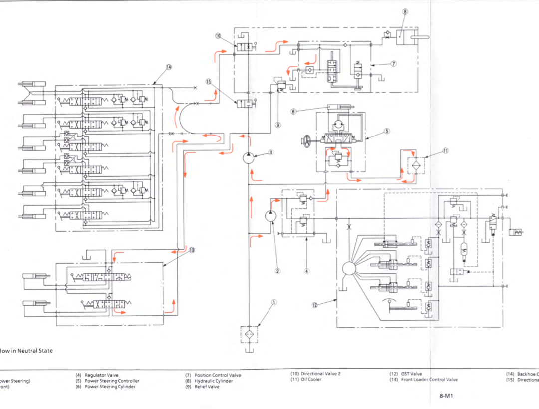

Most, if not all, Kubota tractors use what's called an open-center hydraulic system. Large equipment, including Kubota excavators, I think, use a different type system. The reason open-center systems are used is they are simpler and less expensive for small systems. There are some downsides, but they are manageable.
Here's a diagram of the entire L35 hydraulic system, with the backhoe installed. Pump 2 and the stuff on the right side are for the steering and transmission, so we'll ignore them. Pump 3 supplies the loader, backhoe and 3ph. The pumps are positive-displacement which means they try to supply a given flow rate, proportional to engine speed, regardless of the load or resistance to flow from their discharge. There are mechanical limits to the pump's strength, so a relief valve is used to limit the discharge pressure by relieving flow back to the tank. However, whenever the relief valve is discharging, power is wasted and heat is generated in the fluid.
So, in an open-center system the flow is allowed to flow unchecked through the lines and valves back to the tank. There is some power used and heat generated by the pressure drop in the hoses and valves, but it is minor. (This is the stated purpose of diverter valve 10. When shifted for backhoe use, it allows the fluid to flow directly back to the tank, bypassing the 3ph control valve. I think it also serves a safety purpose by preventing the operator from moving the 3 pt arms inadvertently while operating the backhoe.)
The valves are sort of diverters. When a valve is shifted, it diverts the flow to the desired cylinder. The flow from the cylinder is directed to the tank (for plain directional valves like on the backhoe, the loader valves both have special features). If a valve is held until the cylinder reaches the end of its travel, the fluid has nowhere to go and the relief valve opens to prevent overpressure.
As to your question regarding the backhoe loop, the red arrow actually shows the flow bypassing the bh valve. When the bh is installed, that U would not be there and the flow would go through the bh valve. There are spring-loaded valves in each connector that prevent flow when the connectors are un-coupled, so you can see when that hose on your tractor is left dis-connected, the loop is broken and your relief valve will have to operate continuously.

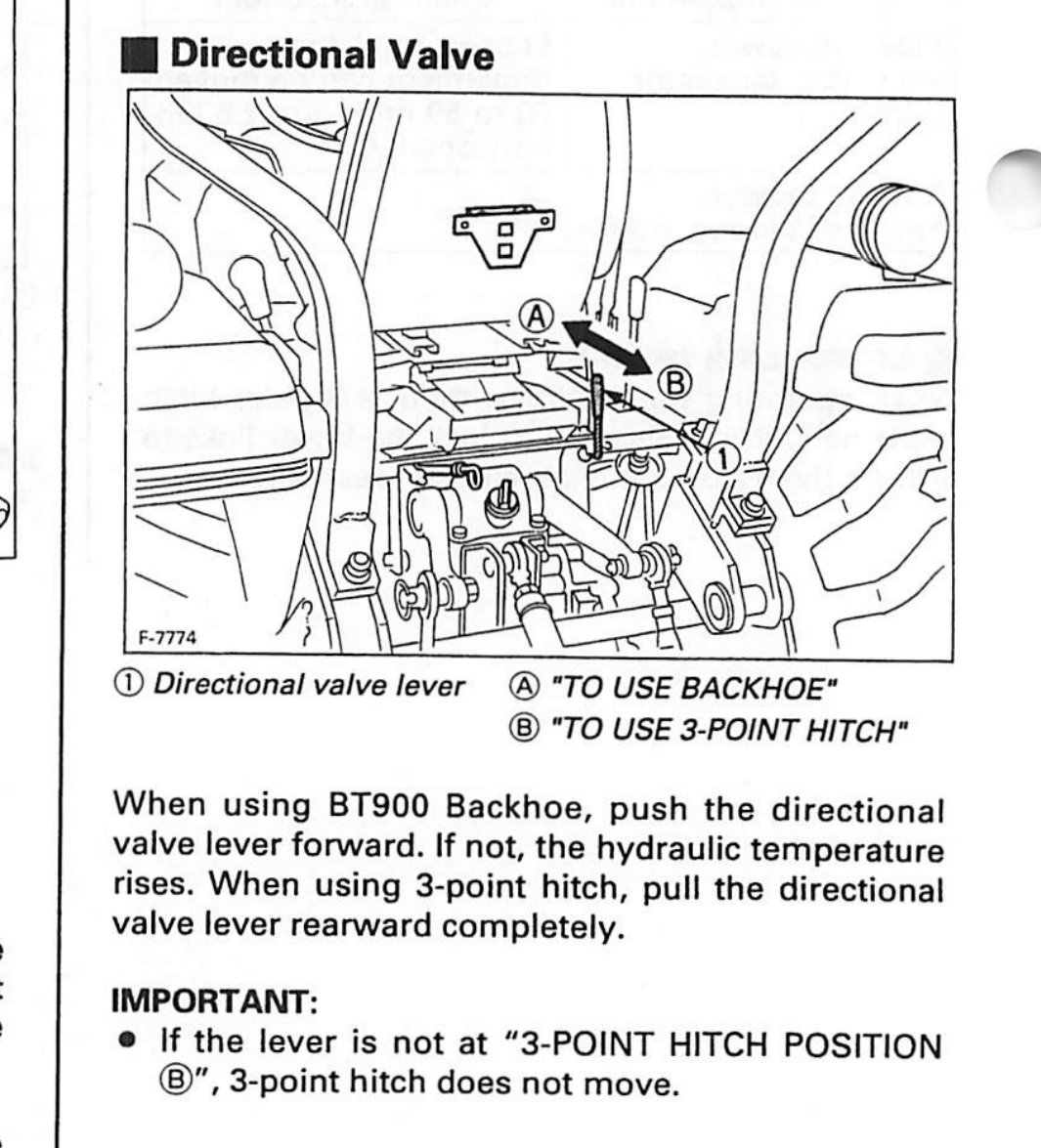

The other post got long, so here's the lowdown on the diverter valve, item 10 on the diagram. (There's another diverter valve, 15, whose only function would be if you removed the loader, which is permanently mounted, so ???)
This is a diagram out of the Op Manual showing how to use the diverter (directional) valve. You can see in the diagram in my previous post that if the valve is left in the backhoe position, the flow is diverted away from the 3ph valve so the 3ph can't raise.
