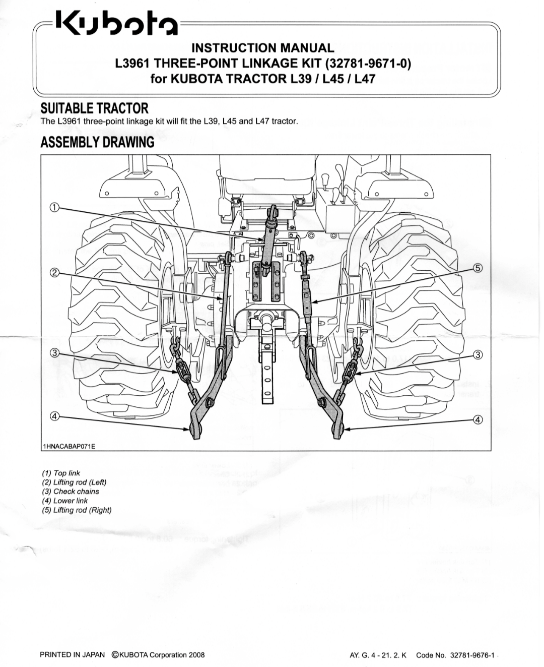

If the 3ph arms that came with the tractor have been lost, there's a kit L3961 available with all the parts shown in dark gray below. The L35 is not listed in the description because the parts came standard on the L35, but not the L39, 45 or 47. It's probably $7-800 now.
