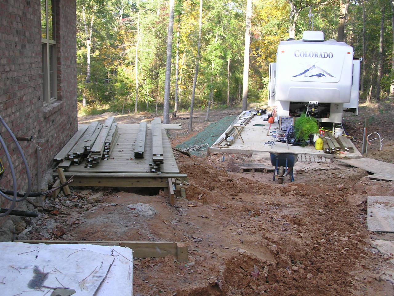

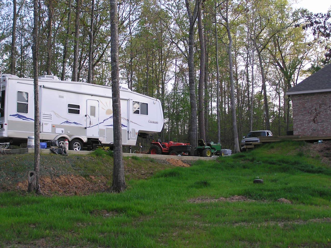

Thank you very much for all the comments and discussion. Here are a couple of old shots taken during construction. The slab does not have poured trenches around the perimeter. It is just a slab but it is 6" thick and has fiber and wire in it. I want to put a gable shingle roof over the existing pad which will have a 12' inside ceiling height clearance for the RV. Then come off the right side as you are looking at the pad with a lean-to roof which will be the tractor shed.

I think you should reconsider the plan. A 16x40' roof structure that is sheathed and covered with asphalt shingles has a lot of weight. Building it open sided like a pole barn transfers all the weight to the individual posts, as you know. These individual point loads are now going to rest on the edge of a 6" slab. Even with a strong slab like yours, it is well under the standards for a point load footing, particularly setting on the edge of the slab.

Suggestion; Place your posts outside of the perimeter of the present concrete. This will bypass post to concrete connection problems. The size of the structure will change somewhat but benefits should outweigh negatives.
If it is to be an enclosed structure then filler concrete can be added later.
Getting a good connection to the slab is possible, but too thin a slab with concentrated loads could be a problem.
I've used a core drill before to go into existing heavy concrete, and then set all thread bars in epoxy (masterbuilder's) grout to hold down large vibrating equipment ( wood chipper). Same method will work for relatively static loads that can have large uplift forces.
