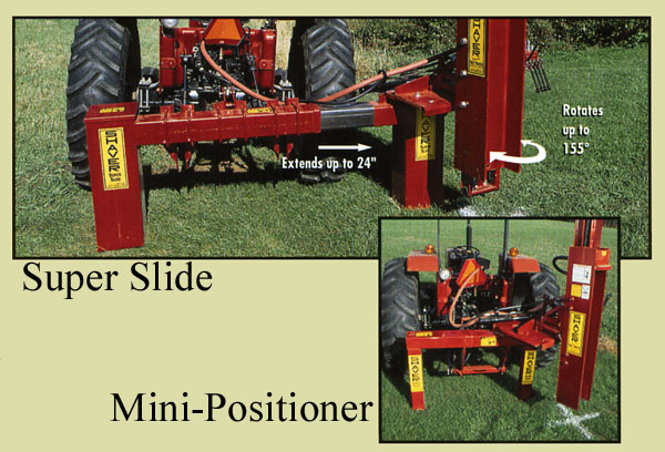

I have now been tinkering with the post driver for a couple of days and have some observations that may be of use to others.
Postdriver: Shaver HD-10, standard positioners (i.e., not hydraulic) Shaver post driver, hole digger, stump grinder, log splitter
Tractor: John Deere 4300 HST (32hp diesel, less at PTO), 8.8 GPM hydraulics for attachments (Note Shaver lists 12 GPM needed, but less will simply slow rise by negligible amount; just make sure that PSI requirements are met)
Posts driven: New posts, 6"+ x 8' (American Timber and Steel these are turned, not "bark-stripped" posts -- very nice, very straight. Download their catalog at this URL for an informative read.) and used electric company poles (up to 8 & 3/4")
Observations:
1. There must be some sort of what we used to call in the Southeast "English" (like putting "English" on a pool ball) that needs to be done to ensure that the posts drive straight. Note that I am talking about straight, even ground, without rocks. And -- the offset is about 2 degrees in one direction, but it's there (note: get about a dozen of the magnetic angle indicators from Harbor Freight when they are on sale for $2 or so. They are great for leveling drivers and posts and very precise). What I'm saying is, that when you have the driver perfectly aligned at both directions, your post is perfectly aligned under the driver in both directions, you drive and, when finished, the post is slightly off in one direction, about 2 degrees. Any help from those who have doing this from a while?
2. There is a serious tendency to splinter the posts -- both new and used ones, but more on used. The reason is that, when the driver comes down, if it does not hit the post square in all directions, it has a tendency to "deflect" and hit anout 2 inches off center, which causes the force to be applied differentially to the post. I worked up a solution last night, I think. I made a post "cap" to be put on the top of each post prior to driving. The outer dimensions are exactly 8 & 3/4" so it slides easily in my driver and the pipe is around 1/4. I made two round tops out of 3/8" flat and welded them together for a 3/4" driving surface. Will try it out today after grinding a bit but I think that it is going to accomplish two things: 1) reduce/eliminate splintering and 2) even with off-center hits, the post will still receive the full effect. We'll see.
3. The time savings with these things is immense. Once everything is aligned, less than 2 minutes per post to drive a wood post 3' in. Amazing. And you would not believe how tight the post is -- and you're completely done.
4. The biggest time spent is aligning the tractor to the precise driving spot and dropping the driver to that spot. That is why, I'm sure, that Shaver sells the positioners an mini-positioners shown in the enclosed attachment, If you are running a lot of fence lines, this would be the way to go. Unfortunately, they are very expensive attachments, so I will probably just build one down the road.

reasley,
Take a look at my photos for Apr 30 2007. This clamped on assembly does wonders for keeping the post under control and should benefit #1,2. For additional anti splinter I crown the posts very slightly. I find also that usually small corrections - sometimes even slight tractor moves, must be made as the post starts in and progresses thru the 1st 6" or so. A little front/back, left/rt, and angular adjustment is effective and easy in this range. I give the post a critical look after each hit in the early stages of a drive.
I added about 50 lb to the driver on my HD8. Our ground can get pretty hard. The added weight makes a tremendous difference in driving 8 to 9" posts.
larry
My Worksaver has a bubble level that made it a lot easier to align the driver in both directions at once. Being off 2 degrees, more when it hit a rock, didn't bother me.
I drove 4" x 4" x 8' and the only time this happened was when there was a knot or a weak spot on the post.
Amen! Turns a multi step job using a phd into a 1 step job.
I drove all my posts by myself, so I agree. I loaned my driver to a friend and since he had a helper it didn't take as long.

Good afternoon, Larry --
Incredible tips, all! I like the "tensioning rig" that you rigged up -- like you said, it's gotta work.
I agree on the crowning idea -- that should fix the problem. I just got in after using the driver again and I tried the metal "cap" that I mentioned earlier. It works great at concentrating the force on the top of the post, but the posts are still splintering a bit, even with it in use. So, what I think that I am going to do is a slight modification of your crowning idea. Instead of driving these 8' posts so that the height of the top of the fence post is where it needs to be, I think that I'm going to leave them about 2-6" long (depending on amount of splintering) and, before installing the horizontal boards, run a line and trip the tops.
I also think that the additional weight added is something that I need to do. I've got a 5 year old son that loves amusement rides, and he weighs about 50 pounds, well, anyway . . .
Again, thanks!

Again, Mike, thanks so much for your previous post driving posts -- they helped me a lot even before I got this driver.
On the bubble level, mine does not have that feature. However, I have found myself using the Harbor Freight magnetic angle indicators for pretty much anything that I used to use a level for. I don't have the confidence to read a bubble level within two degrees, so the HF tools enable me to do it better than I could do myself.
As I mentioned in an earlier post, I feel certain that I am going to go ahead and build the positioner for my driver that Shaver sells (see attached, but it is incredibly expensive to buy). Doing posts by myself, I think that this attachment will aid considerably in time and accuracy savings. My only concern with it is balance on my JD 4300 compact tractor, but I see two ways to reduce the potential for imbalance (take a look at the top picture and you'll see what I mean). The first way is to beef up the left "foot" with additional weight and the second way is to put a foot of some type there, but make a metal basket to hold the posts. Thoughts/comments welcome . . .

I believe Shaver mentions that if you are having troubles with the top of the posts moving "away" from the driver during pounding, you are to put a little outward tilt to the top of the driver. Basically, when the head of the pounder comes down, it has a tendency to hold the top of the post "inward" towards the inside channel. My dad always has the top of the pounder tilted towards himself(stands on front of the post). Now, his post driver is over 30 years old and has a lot of "play" in it, too. I have read about this procedure on Shaver literature before. Maybe you already knew this, but you purchased this used, so you might not have received and paperwork with it.
Thanks so much for the tip, Catman. I do have the Operator's Manual, but I just checked and it doesn't say anything about angling the driver, but it makes sense. Now that you've mentioned it, I remember that I have been doing that after the start of driving but it is probably too late at that time . . .
