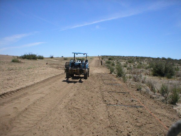

Neil L said:
Pat,
Thinking about T-post installation. Need to have ability to go over uneven ground. Looked at Shaver ( nice ), dedicated to post driving and no other use.
Any thoughts about a Hydrolic hammer or drill (reversable, several other uses) so you don't need electricity, have 7.5 GPM at 2100 PSI? Any cost thoughts, sources?
Could it be mounted on a boom pole? Still may need two people.
Can you add weight or down pressure?
Looking for an easy answer to fencing for goats, May need to install a few wooden post here and there, so probably need a hydo digger as well unles you all have a better solution.
Thanks,
Neil
Neil, I have no experience beyond the three T-post driving methods I personally have used: 1. manual with closed pipe style driver (spring loaded type, I like it better), 2. FEL (with or without gauge and bend preventer with post holder. When have a second person I just use FEL.), 3. Electric demo hammer with chisel replaced with elongated metal cup to keep tool on the post. (Cheap on sale at HFand will run from modest generator.)
I have a friend who has had a fencing company as a sideline for over 40 years and he uses the closed pipe with handles (no spring) type driver but I have got him to tolerate me using the FEL when we do fence together since it is so much faster and easier.
I have never personally seen a hydraulic post driver in action or up close when not in use. Seems to be too expensive for something you won't use all the time but something that renting for times of intense use could make sense.
With one guy driving the tractor with FEL and the other holding the t-posts till the FEL touches them and then holding a wooden wand under the bucket to act as a driving depth gauge, you can drive an awful lot of posts in a short period of time and get them to the same depth. My friend insists on a STRAIGHT LINE OF POSTS so he hand tweaks any posts that lean out of perfect alignment.
Left to my own devices, I stretch one strand of wire (wire fence not field fence or whatever) to get a straight line. He drives posts and gets the line by sighting along them. His results are as good as it gets.
The other topic: Containment of cattle at the feedlot requires a different solution than for pastures. I am putting graduated field fence with a strand of 4 point barbed wire at the top along my highway frontage for the part of my land that will have a high number of newborn calves. Between pastures interior to my place and at boundaries with neighbors as well as along section line roads, I use 5 strands of barbed wire.
I find that 5 strands of 4 point barbed wire keeps grazing stock just fine with the exception of certain incidents when bulls are in adjacent pastures. Bulls on opposite sides of the fence will get to contesting each other across the fence and one or both will walk right through a good barbed wire fence to get at the other. Later my neighbor, myself, or both will find and fix the damaged area. I have neighbors with cattle operations on my south and east sides with 1/2 mile of common fence in each case. We have had 3-4 breakthroughs in 5-6 years.
Pat

I found the big electric demo hammer reduced on sale. It is not particularly faster than a motivated guy with a manual driver but is easier on the user. It is a handful to hoist up in the air to put on a post so I put the "cup" on the top of the post, the end of the post on the ground, and then stand the post up vertically and turn it on. If you drive tall posts or are less than about 5'10" or so tall yourself (I'm 6'2") you may need a small step stool. I expect I will be trying to find a way to automate its use a bit. Probably a holder on the FEL and the generator on a carryall on the 3PH or some such.
