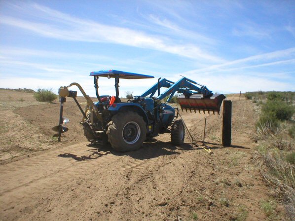

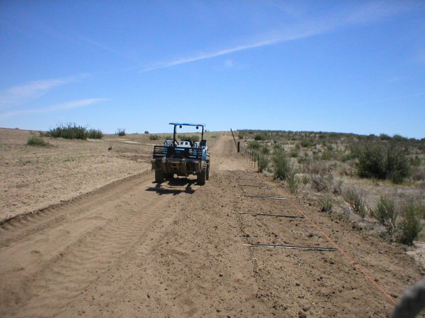

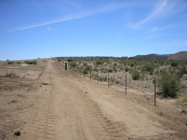

:( I am able to put in T post fencing with a few poles and range fencing at a rate of 1/4 mile in 2-10 hour days. The last stretch that I did, I figured that I had to make 14,000 strikes with my hand post driver.:eek: My arms were tired for a few days after that.:D Here's a few pics of some of the fencing that I have put up recently. Doesn't look as nice as your type of fencing though.
Wow! That is a nice straight line. Ive used the pounder on T posts with good results. Just short stroke it. Id never get it that straight tho with just me unless I hand set them first and then came back and nudged them to depth. Saves a lot of arm, but makes pretzels if you hit a rock.

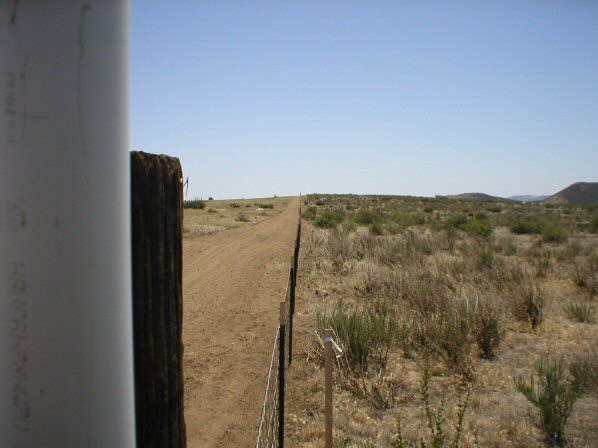

Larry, I pull 600' of weed eater line to get my lines straight. I figure that nothing varies more than 2". T posts are 10' apart with 40" range wire. I should have used 48" wire, but oh well. My fencing is mainly to keep motorcycle riders out.

Thanks for the complement.
This type of driver would be good when you have very hard or rocky ground to work with. But for me it would take so long just to position the tractor each time that it would take for ever to get much done. Plus when you are working by yourself, seems to me that it would take a long time to just get set to be able to pound the post. A lot depends on what type of fence you put up and the ground conditions that you have to work with on how is the best way to get it done.
