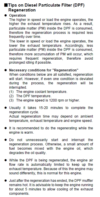

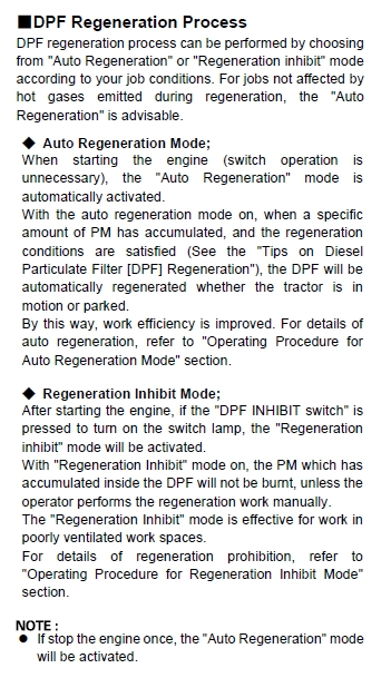

Did a little research on the Kubota M7060 and found this on another forum:
There is no DEF on a M7060, there is no OBD port to hook a scanner to, and there's no modification to raise the idle with a switch like there is on a OTR truck.
When it calls for a regen, you will have to manually raise your RPM's until the light with the arrow pointing up, goes out. You can continue to use the machine, just keep your RPM's up. After the regen is complete, all the corresponding lights will go out, and it's done. Takes anywhere from 25-40min. On the occasion that it calls for a parked regen, you'll have to put everything in neutral, turn off the PTO, set the parking brake, and keep the throttle down to an idle. Then you will push the regen switch with the "P" next to it, and the computer will take over and allow it to regen. At that time, you can not use the tractor, allow it to do it's regen and go do something else. When it's done, the lights will go out.
So, if this is true then the M7060 does not have DEF. That's good. I'd hate to have to mess with and pay for that stuff. But, if the part about regenerating is true them I'm out. My work/project time is limited to weekends and is of great value to me. I do a lot of low rpm work where running at higher rpms is just not an option (dragging piles of logs over rough and hilly terrain, lifting logs onto sawmill, etc) so doing a 25 minute high rpm regen would essentially bring work to a halt. The post above does not say how long a "parked regen" would take but if it is 25 minutes or more I would lose my mind. There is no way I'm spending big bucks on a machine that essentially has to stop and rest.
But, that brings up a question. Can you do preemptive regens? In other words, if the filter is not full of soot and I'm doing something that does not require the tractor, can I have it do a parked regen and thus avoid having to do it while I'm trying to work?
