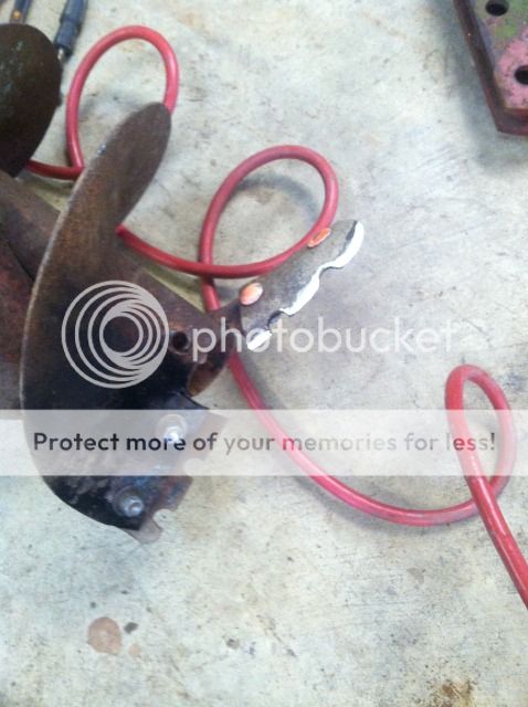

the very bottom "point" on the auger. looks abit worn down.
and what really looks worn down is the "meh don't know what to call them" the teeth on the wider outer edge.
while the point ya want sharp, i can get held up easily with sharp point, and dull teeth on the wider outer edges. in dry compacted dirt (more so dry clay). a dull point, and sharp outer teeth, more likely to keep ya going. having both sharp ya is a good thing. but if cash is tight would choose the wider outer edge teeth first.

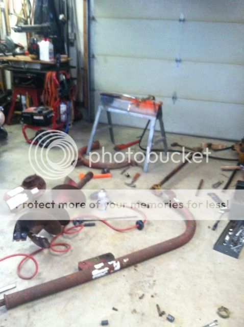

Got some work done on it today... The oil was clean and full, it does not appear to be leaking. I got the bent auger edge corrected, and sharpened both cutting teeth and the tip. I had to use a rosebud on the oxy torch to get the auger blade bent back as close as I could, and quenched it as quick as I could get water on it, so hopefully I didn't soften it up to much. Picked up 8 grade 5 3/8x3 inch bolts and nuts for the shear bolts. My input shaft has a groove, but has a spring loaded locking pin on it that fits in the groove, so no need for a set screw. Pretty nice set up really as I can store the shaft indoors and that's the part I need to protect from rust the most.
I did have to heat the PTO shaft up REALLY hot, and slam it with the truck many dozen times... then we put some SOLID pressure on it w/ the truck and beat it with a hammer, sprayed it with PB blaster, and heated it some more... Once it game free I cleaned up as best I could and greased the crap out of it.

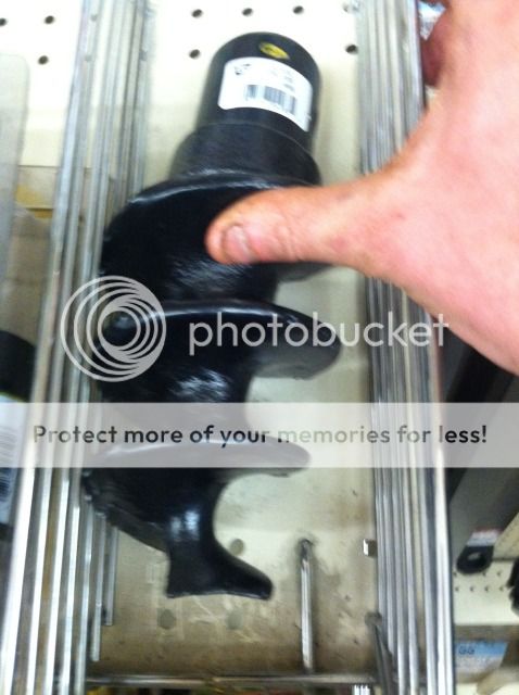

Is it worth the 40 bucks to pick up one of these?
   / Post hole auger, What did i get? #15
Is it worth the 40 bucks to pick up one of these? IMO yes considering the PHD was giving to you. However I would look in CL adds for whole auger units before I bought. A new 9" complete is probably $140 and a 12" $160 plus. Sometimes the big box stores run specials and augers come down in prices. Just some more thoughts. Thanks for update ! :thumbsup:

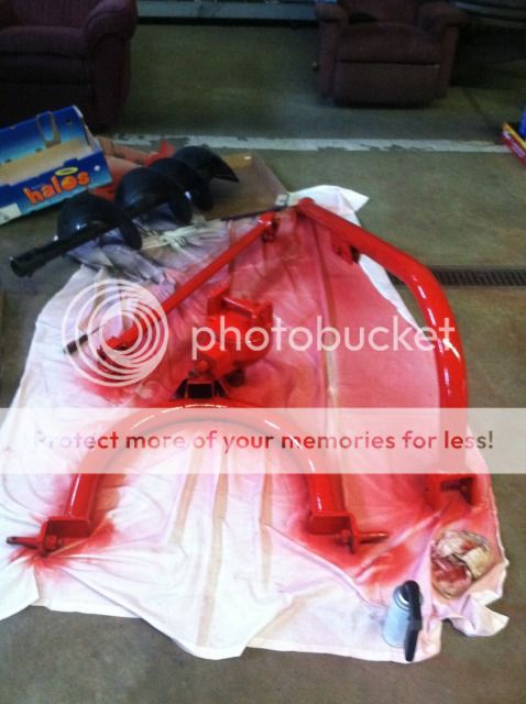

thinking about it... the tip is 40 bucks, and I already have an auger that I cannot get easy replacement teeth for. SOOOO I think I am going to try it the way it is. If it works them I am money ahead, and if it doesn't and I would have bought the tip anyways, then that 40 can go towards a new auger which would then only cost me 110 bucks since I didn't spend the 40 I would have otherwise. Ill get it painted up tomorrow while I am at the firehouse, and hopefully get to test it out sometime this week.
Do you have any idea where I can find pictures of the original? I bought ford red enamel from TSC and one of the hand held sprayer attachements, but I have a can of black as well. I am thinking about painting the auger itself black and everything else red because that seems to be the norm these days.

Also, I think your auger and mine are different. my "spirals" continue past the tube in the middle, yours stops flush at the bottom and has the triangle reinforcement added that I see from the augers at TSC... I wonder if yours is actually a newer auger added to the older digger?

I already have the PTO shaft as close to 100 percent as I believe its going to get. I am going to store this thing outside, so it needs paint otherwise it will be worthless in just a few years. I have few really old implements and all of them are going to get wire wheeled and painted at some point. It just so happens that this was very easy to work on and the place I was messing with it had all the tools to get it cleaned up so I went ahead and sanded the rust off. With the amount of time I have getting to this point it would be silly not to paint everything.

Mostly painted... I am using tractor/implement paint from TSC. I wish I would have used rustoleum painters touch instead. That stuff fills in pits self levels and goes on one coat MUCH thicker. This stuff is produding a TON of overspray and is going on really thing. Wont use the stuff again. Have to let it dry, flip a few of the pieces over and paint the bottoms and its ready to be tested out.
