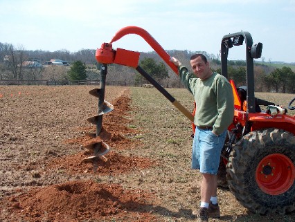

We have a B2910 with a Befco Mole PHD and a 12" and 6" auger. Our soil sounds similar to yours. The Befco is a heavy duty machine and we have already gotten our money's worth !
We installed over 90 posts last year (during hot dry summer !) for our deer fence.
You can see in the attachment that we are now in process of installing first two acres of our ten+ acre vineyard. Planted 70 end posts last weekend, with over 300 line posts to go in by next month.
Good luck.
