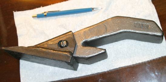

My first tooth came in.
I will make a tooth bar with it. Foundd it on ebay. One TBN person emailed me and asked me to post an ebay link. This won't work well on TBN because ebay closes listing links after a few months. You can search for "bucket teeth" and make sure the ones you order are for a tooth bar. You can also search for the guys phone number "866-222-2557". Note the- instead of + in the area code. Be sure to click the "Search titles and descriptions " box under the search field.
You could also call him direct.
I wanted to take the bucket and tooth to the steel store ato help me select the best fitting steel. After I make a tooth (single tooth) bar and make sure every thing fits well I'll order seven more teeth and turn it into a teeth bar. /forums/images/graemlins/grin.gif

The tooth shown is pretty big. I have a 68 hp M6800. Must CUT's probably could use the smaller tooth/teeth.
   / post your pictures of teeth bars #37
That tooth looks identical to what came on the toothbar I bought for my TC35
   / post your pictures of teeth bars #38
Yeah well it was the wrong one...How do they do that?? /forums/images/graemlins/confused.gif I mean I bought the tractor at their shop...had the specs for the loader they put on!!!
