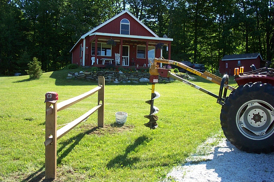

Good Evenin magyarbacsi,
I bought the L7300 this past spring and am very happy with it, although admittedly havent used it alot ! I did some fence posts and a bunch of seedling holes and thats about it, but it worked great other than shearing one shear bolt. I felt for what I payed it was a quality unit ! I would advise to go look at the units your interested in and go from there !
