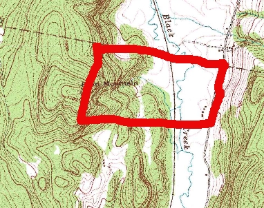

I was a Vermont resident from 1958 until 1979 and still have a 73 acre piece of it in East Fletcher. An open station tractor may make you reluctant to operate during "snow season". Sure you will get out there and blow snow but a lot of other chores may get "put off".
Now I realize Vermont has warmed up since I left, but "snow season" used to be September through May.
Unless you have a great need/want for a backhoe I suggest a cab would be worth far more, just be careful of the windows.
I purchased a home last fall with 27 acres of land (5-7) acres of open meadow (potential to add another 5 acres of meadow and 12acres of pasture/woods), and 20acres of mixed woods. I知 looking to eventually start my own small farm (vegetables, fruit trees, xmas trees, few beef cows, chickens, etc) to carry me into retirement. I知 hoping this tractor will be my do all tractor, but understand it would be best to have more than one. Below is a list of items I will be doing:

Well then I know your territory. My land is on the west of RT 108 and the Bakersfield/Fletcher Town line is the northern boundary.
I wasn't trying to indicate that snow blowing would be a problem, but I've noticed as I get older things like sleet and cold affect my joints more. Thus when those conditions happen down in Mississippi I'm more liable to put off non-critical "tractor chores" (which only occurs a few times per year).
