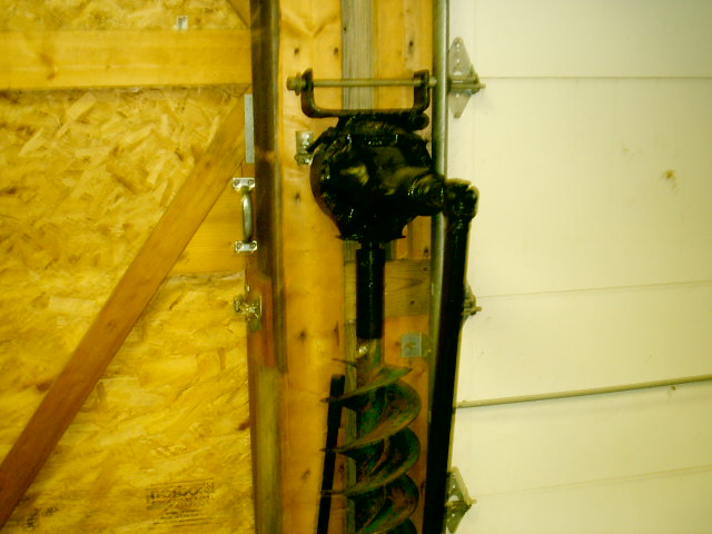

any chance to get a few pics of this beast... have a few 9's hanging around looking to make themselves useful:D
Here is a pic. It mounts to a modified boom pole you can get from any TSC or similar store for $100 or less. To modify it all they did was weld a tube across to accept the pin that connects the gear box. I cant get a pic of it right now because its on my other tractor at another location being used to pull shrubs.
