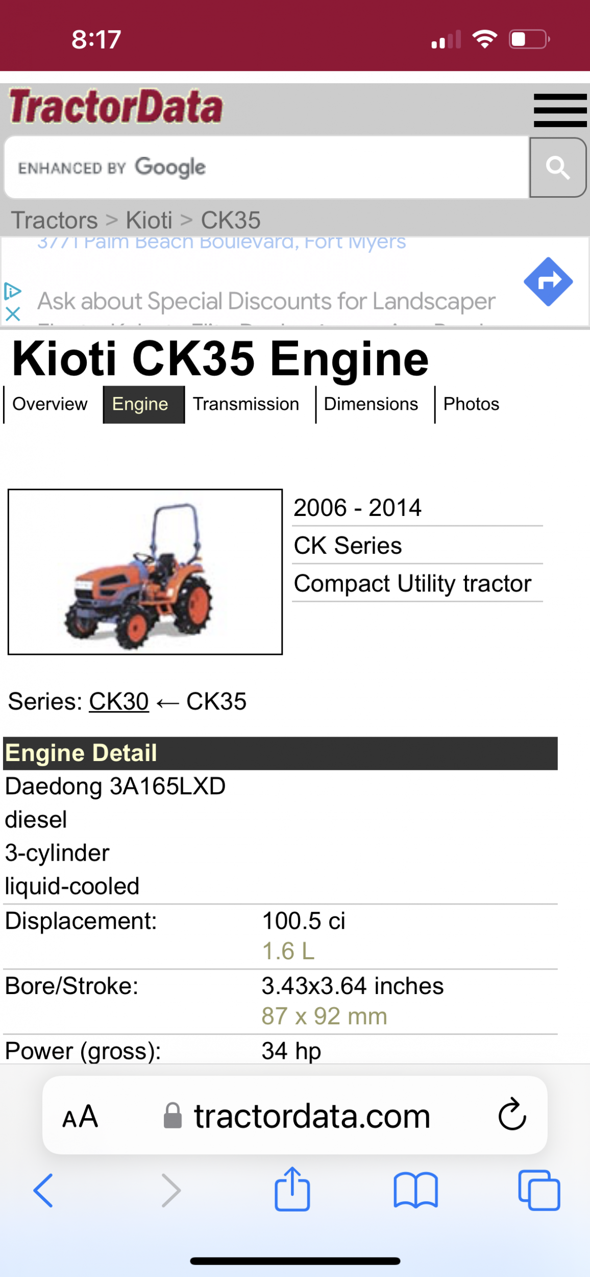

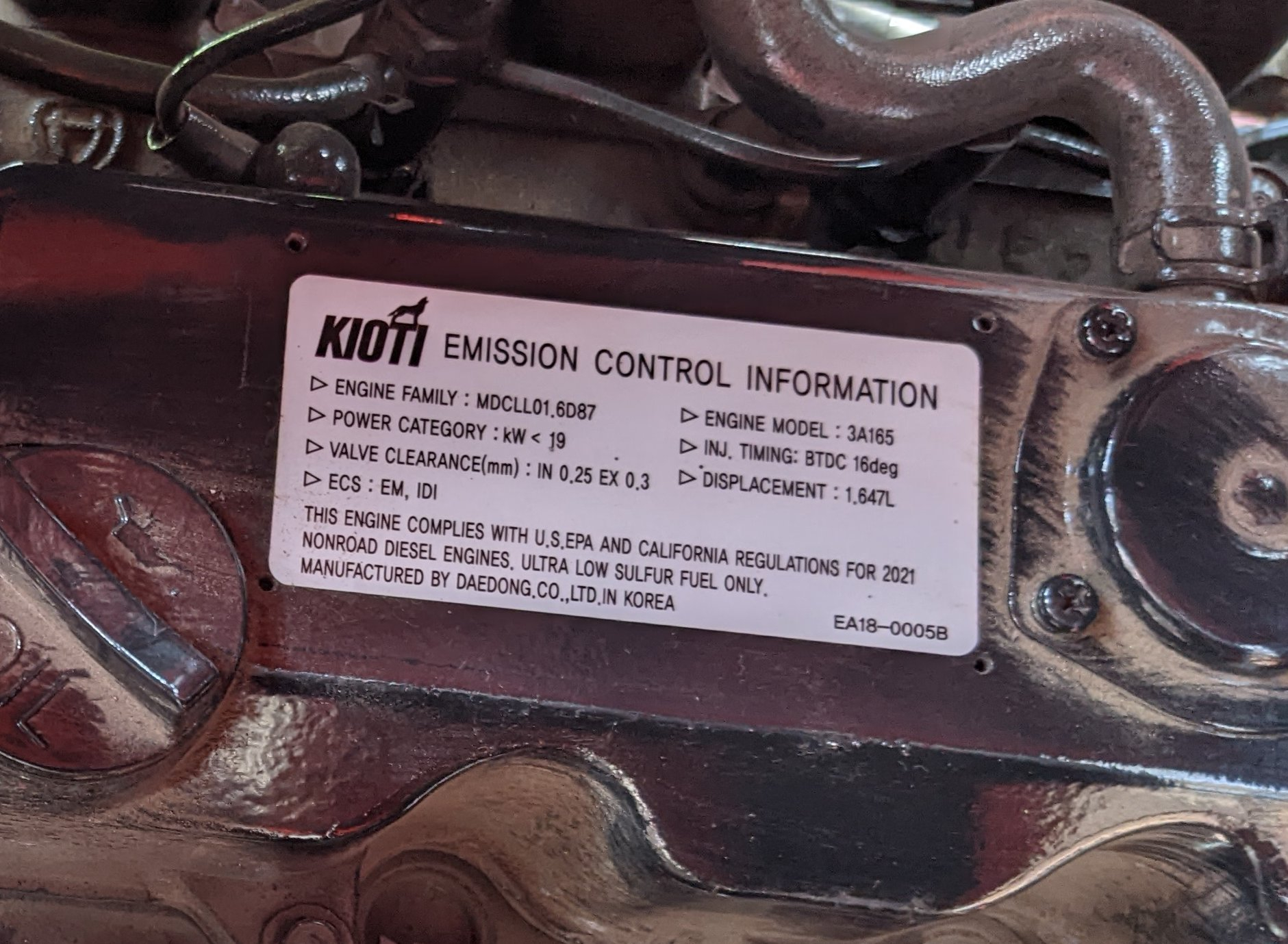

I am trying to compare engine, cooling, etc details between the ck2610, and the previous models that this thread mentions had the exact same engine, such as the CK35, to gauge how comfortable I am bumping up the power. I have the service manual for the ck2610, need confirmation of what other models had the 3a165
ck2610 hst (mine is 2021; presumably this is the same across years?) is
engine model 3a165
engine family MDCLL01,6d87
displacement 1.647L
can anyone positively ID the CK35 or similar as sharing the 3a165 1.647L engine?
EPA sticker is on the top of the valve cover (eg ~very top of engine)

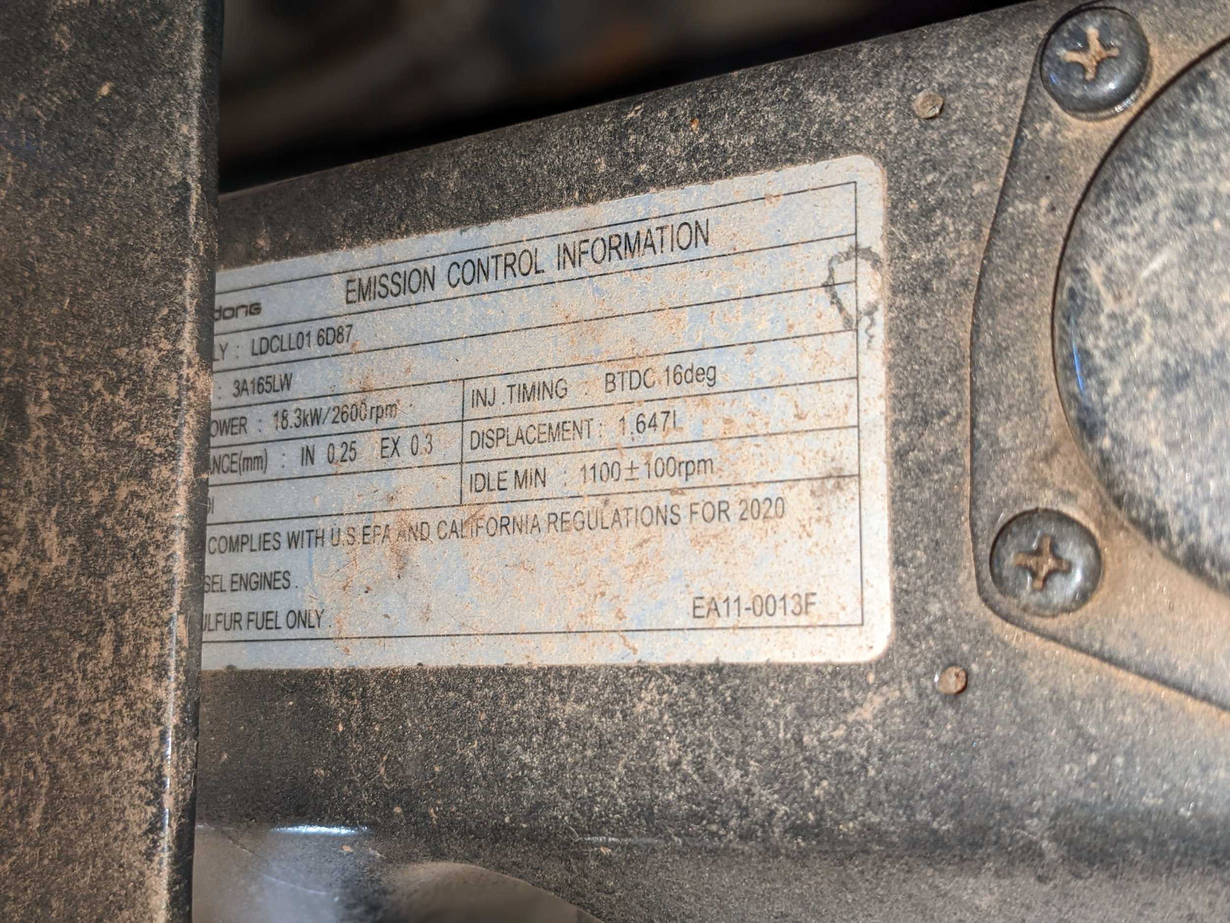

My CX2510. Clearly I don't wash my tractor. :p
   / Potential power increase for CK2610? #98
Thanks - I'm looking for confirmation of models with MORE horsepower but the same #3a165 1.647 L engine - eg the pre-ck10 series like the ck35 (so i hear).
with a known 3a165 model of higher output, i can compare the parts diagrs to see what (if anything) is different to tollerate the higher power.
