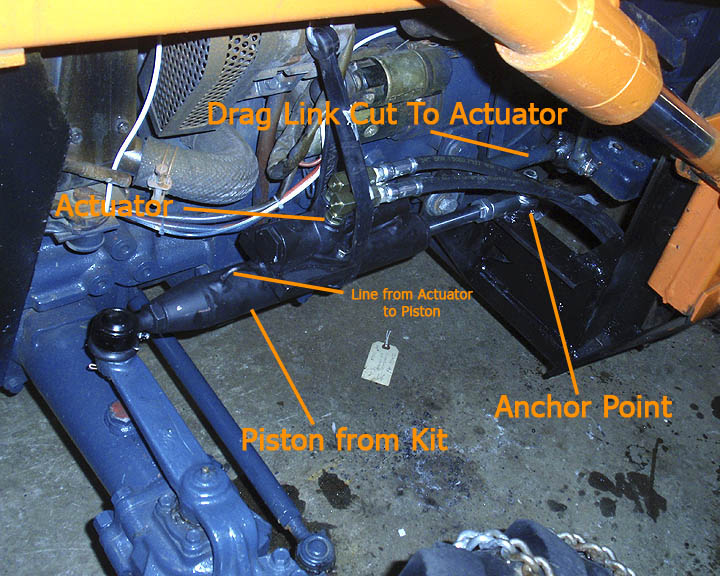

So how was the steering wheel and controller to install? Do you notice an binding or limit to the degree of turn you now have?
Hi Woodlandfarms!
There is no controller, you cut the drag link from the pitman arm to the wheel and replace it with the provided parts. One end goes to the wheel and one to the frame. The old drag link goes to the actuator...when it pushes forward the piston extends, when it pulls back the piston contracts. I have a full sharp turn, it goes all the way, no binding, it feels just like factory power steering. I couldn't be happier! :) Thanks for the post!
   / Power Steering in 90 Minutes!
#12
Looks like to me that there is no steering wheel / rotory vavle installation / modification required. Looks like the steering linkage now hooks up the valve on top of the cyl. and that is how the cyl. is actuated?
That's my gues based on the pictures and the link to the supplier's site.
If that is the case, this is a super cool set up.
I did notice as the poster stated that the cyl. looks like it will want to fall to one side or the other due to the tie rod ends.
As I think about it, because the cyl is mounted between the axle and the tractor frame, there are a bunch of angles that could occur and therefore tie rod ends are required. On my tractor I think it is all mounted onto the axle itself, therefore less angles.
Not sure there is an easy solution other than bungy, which will probably work fine forever.
Joel
Joel
Hi Joel!
You got it! The drag link is cut and now pushes the actuator (valve welded to piston) Turn the wheel one way and it extends the piston, the other in contracts. There is a spring detent in the middle. It feels smooth as silk, just like a modern vehicle. On the bungy, I could replace it with a spring to a center point...maybe when it's warmer. For now it's working and a joy to drive. Thanks for the post Joel! :)

Here's a photo with text tags.

Hi Darryl,
I was surprised on many levels with this project. The cost, the easy install, but most of all how natural the steering feels. I thought there might be some slop in it since there was without the mod. Somehow between the strong center detent on the actuator valve and the design it feels tighter than before. I was going to take off the "suicide knob" but found it's even better with PS. I had it on there to help the hard steering.
As to "arm-strong" steering with a load, you know it. There were times when I could hardly move the wheel with my snowblower attachment or a full load in the bucket. I had learned to make long 3 point turns and 5 or 7 point turns to save my arms. The lack of PS really dictated how I drove, and how about almost breaking your fingers when you hit a curb or rut...as the devil takes over and spins the wheel faster than you can see? No longer a fear.
I'm betting all the folks that always had PS can't relate to this...but those in the Armstrong club know EXACTLY what I'm writing.
Darryl, good luck with your mod, you will LOVE how it drives after.

Hi Darryl,
I was surprised on many levels with this project. The cost, the easy install, but most of all how natural the steering feels. I thought there might be some slop in it since there was without the mod. Somehow between the strong center detent on the actuator valve and the design it feels tighter than before....!
Boston,
Regarding the slop: Since your conversion retains the factory steering gearbox, you should still be able to remove (or increase) the slop in the steering wheel by adjusting the worm gear adjuster on the side of the original factory gearbox if you need to in the future. At least this is the way my Kubota L285 works. The adjustment procedure is covered in the Kubota Service manual.
Great Post: Your install and feedback has inpired me. I have been contemplating getting rid of my otherwise perfectly good L285 with FEL for a tractor with power steering. I think I will now opt to do this mod (when it gets a little warmer outside) and simply keep my current tractor as this mod is affordable. Furthermore, I have owned my current tractor for 10 years and it is in otherwise perfect mechanical condition so I know what I have. If I were to trade it off, I might end with a pile of junk as a replacement as I could only afford to replace it with a used tractor. I think this will be $500 well spent.
Questions: Do you know happen to know what the priority valve will cost me? (Could you post pics of the valve and its mounting location?) Also, Would substituting a tie rod end in place of the rear swivel stud on the bracket you fabricated eliminate the need for the bungy?
My tractor is almost identical to yours except that it is only slightly bigger (not much bigger) and I have 2wd instead of 4wd. I even have the Kubota factory FEL so the rest of my install should go pretty much like yours did if I opt to make my rear rear mount attach to the FEL like you did. (Since my tractor is a little bigger, I might even have just enough room to alternately make my rear mount attach to the motor instead of the FEL frame so I could still remove the FEL if desired. I have never removed the FEL in 10 years, but I still may opt to attach to the motor, if I can do it easily, so I would at least have the option of removing the FEL if i ever wanted to).
