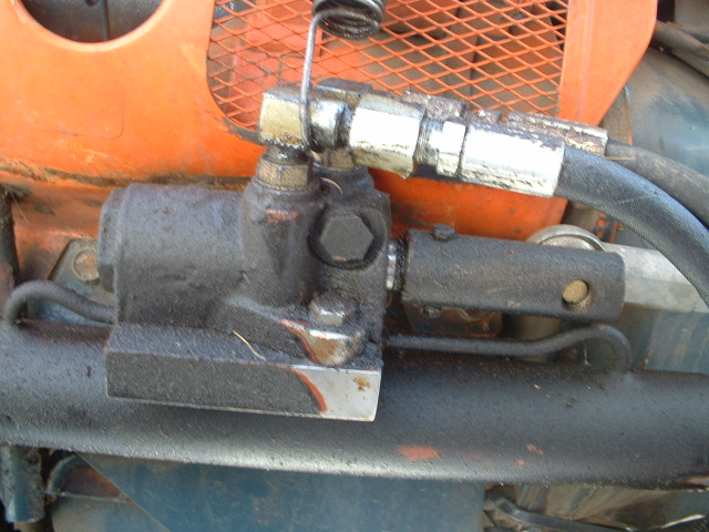

That is the same system that was used on some Ford cars in the 50's & 60's the valve was built in. If you could find one in the junk yard might be able to adpt to tractor.
The ford valves on many of the 60-late 70's models seem to be one of the best ( common and cheapest) examples I have found so far.
I think the kit R.Davis sold was simply one of these automotive valves mounted on a steering cylinder. Maybe that was already obvious to some.....I can be a little slow :eek:
Today 50's ~ 60's Ford components might be the best alternative to add power steering on any tractor.
Long ago I had a Willys Wagon that an owner of a body shop had modified in his spare time. 292 Ford V8, and the air conditioning and power steering also transferred over from a late 50's Ford. The steering components were a simple bolt-on similar to the Yanmar PS kits. This worked well.

It is a shame that the guy that sold the actuator and cylinder assembly on the original post stopped selling them. I am putting a new sector shaft and and ball nut and shaft in my L185 kutbota and power steering is next on the list.
/ Power Steering in 90 Minutes! #88
Seems like it might be easier to get an electric power steering unit out of a junked car than to try to gin up a hydraulic one, particularly if you have a small pump. https://www.youtube.com/watch?v=BuShsA_cqNk.
That's a good point. I'm not real happy with the power steering (Yanmar-USA option) on my YM186D. Digging into a gravel pile etc with the loader, its natural to go into the pile until the engine starts to bog down - and at low rpm I can't raise or roll back the bucket to ease up on how big a bite I'm taking. I think the diverter to the PS is stealing hydraulic force. My larger YM240 (manual steering) has the identical hydraulic pump and a 5 ft bucket, compared to the 4 ft on the little tractor, and its hydraulics work about the same at any reasonable rpm.
Think of how a Caterpillar operator eases up on the bite he's taking, raises the blade, as the tractor slows down. I lose that ability to ease up, as I lose rpm. Not ideal for a little tractor that is set up primarily for landscaping, moving dirt around.
I love the little YM186D but I think this dealer add-on PS kit isn't up to the top quality of the rest of the tractor. Also - Yanmar parts remain available for this early-80's tractor, but the American PS kit supplier is long gone and there are no service parts for it. A Ford-based kit could be maintained nearly forever. I may eventually have to replace the kit with a manual-steering drag link.

I have mine plumbed in series after the loader. I do lose power steering when I'm using the loader but not too big a deal. My plan is to mount a belt driven pump from a small foreign car with a remote reservoir so it's independent. Others have done something similar here at TBN. That may be a workaround for the diverter valve issue.

I bought a kit for a Ford and adapted it to my Kubota L285, now my 3 point don't work. Any ideas?
/ Power Steering in 90 Minutes! #99
Would need to see how it's plumbed. Hydraulic fluid takes the path of least restriction.
