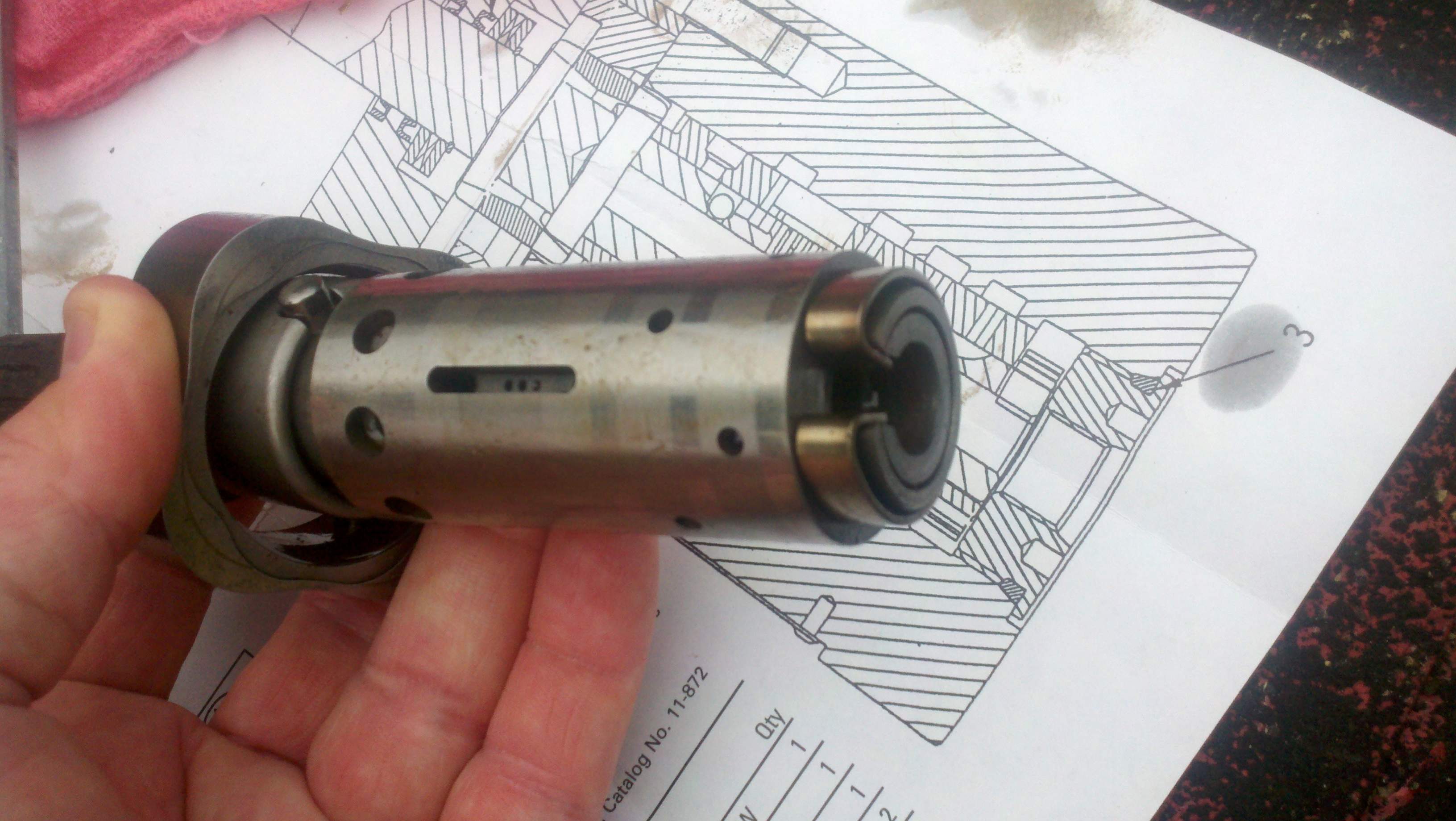

Thanks for the information. I finally got it off. Now I have the o-ring kit to install. I know where o-rings 1,2 & 4 go but the 3rd one is a little bit tricky. I have added some pics for reference. Does the 3rd ring go inside the bottom of the unit or on the end of the gear shaft? Any help would be appreciated.

Hey man, I'm sorry for your trouble with your tractor and hope you get it quickly resolved.

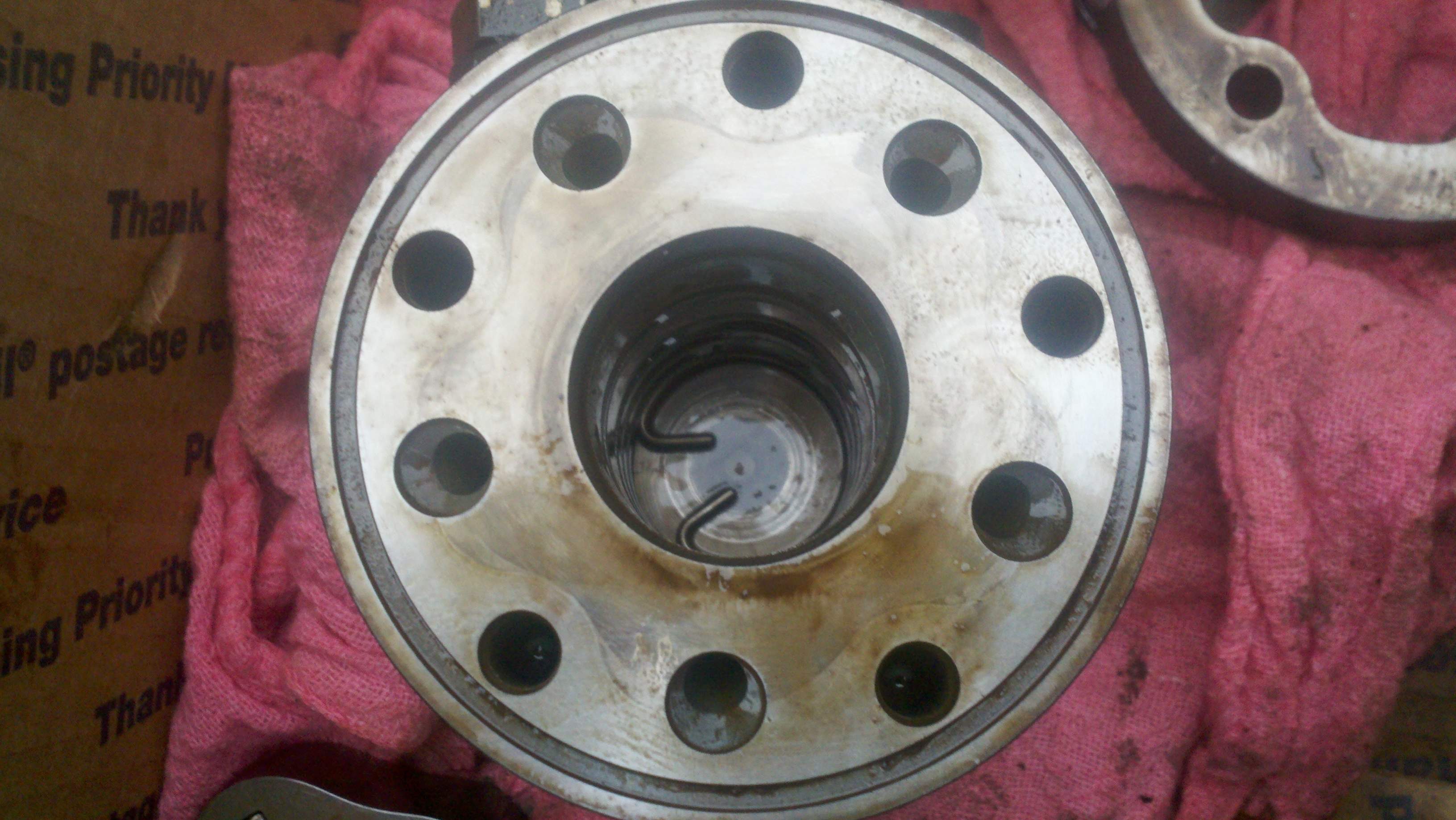

All, I finally got the diagram of the HSU that I needed from Lawallstractor. He has been a great help but I need some more advice. I don't have wrench needed to remove/unscrew the bottom of the HSU to install the bottom o-ring. I have seen a wrench like this before but I don't know what it is called. There are 2 holes around 15/16" apart. Any help is appreciated.
