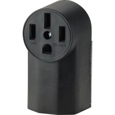

Basically What I mean is something Like this Plug or similar that your welder would plug into :
Home Depot , Lowes , etc.......
Appropriate size cord , similar to what is on your welder . One end of is left bare with wires out while other is fed into recepticle and wired up . If welder is 3 prong , then get 3 prong box . Just remember Which wires you use on the 2 side blades and the wire for the ground . Thus the 2 wires you have in box on the side blades go into the breaker and the single wire at top is for ground .
Say Black on one side , White on other side and the Green at the top . Colors may vary , Just keep them the same in box and on breaker .
At the least , it should isolate what section of your grid is the problem . May not diagnose the issue , but may narrow it down to were .
