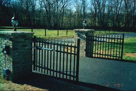

Here's my system: GTO Pro 1000 Low Voltage operators. Low voltage wire can be run up to 1000' from transformer.
Installed myself along with gates in about 4 hours. Including vehicle exit loop detector buried in new asphalt driveway. Ran 400' of AC through buried conduit down to columns providing AC for lighting AND wireless surveillance camera mounted on column. Camera is part of system which runs through my home PC continuosly and I can even remote access from web!
Wife wants the intercom so will add a wireless one soon.
We plan on installing matching fence this year now that we have our new Kubota with a PHD!
Purchased from www.hooverfence.com . Great people to work with. Extremely professional and helpful to the DIYer!

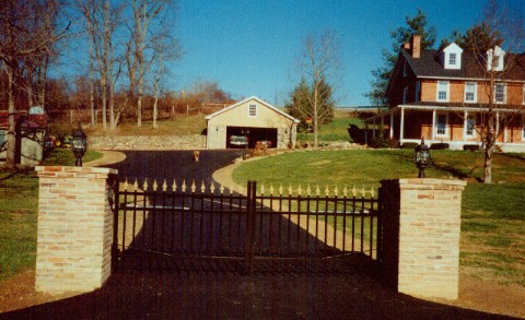

   / Power To Auto-Gate Opener #15
More photos
