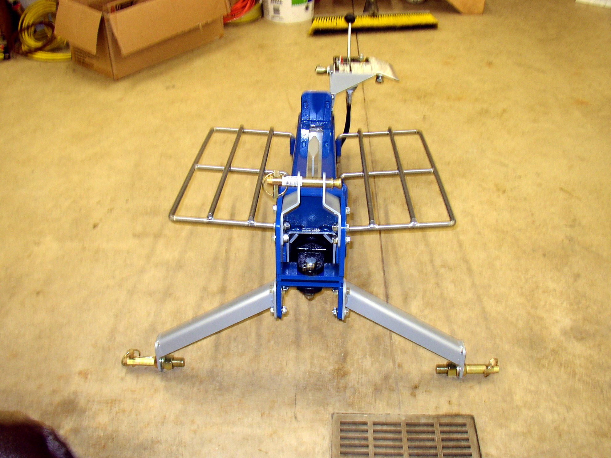

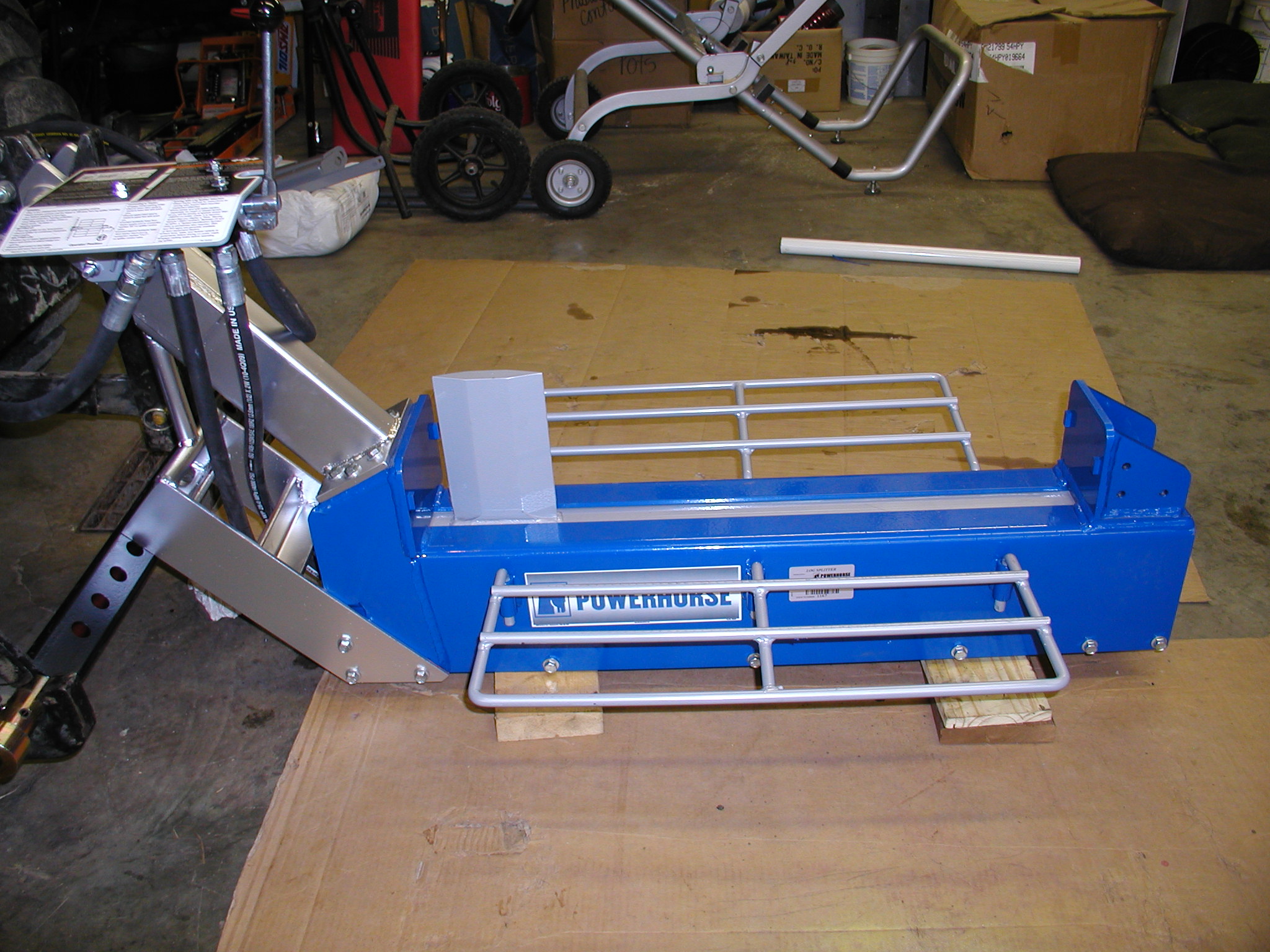

I just put my new powerhorse 3 pt. log splitter together. I took a look at it when it was all done and thought, why does it not have legs or something to keep it up higher off the ground so that when you back up to it you can attach it to you lift arms? Take a look. The lift arm pins are on the ground. How have you guys dealt with this? I don't have the hoses to the tractor yet so I can't tell you how well it works but I will when it is all hooked up. Either I have to make a cradle for it to sit in when stored or make legs for it I guess.

Can you turn the lift arms over?
   / Powerhorse 3 pt. log splitter design flaw
If I did, you couldn't rise it up high enough for a comfortable working height. Also it would not take care of the problem of attaching the top link. But that was a good thought. Thanks! I know that someone on the TBN network has solved this problem. TBNers are incredably resorceful.

I think I would build a carriage that the whole thing could be set in so the lift pins were high enough to hook up. Might even add some casters to it so it could be stored out of the way easily being more of a seasonal use attachment.
I never liked the working height of my 3pt splitter so I permanently mounted it to a stand and use longer hoses. Now I just pick up the whole stand and splitter up with forks to move to different areas.
MarkV
   / Powerhorse 3 pt. log splitter design flaw #5
Just block it up when you park it.

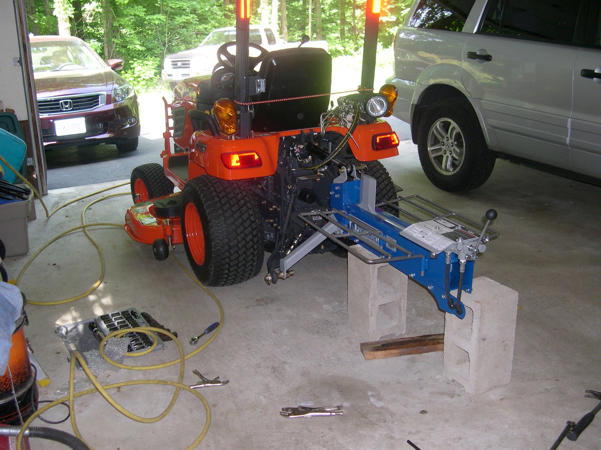

Just bought the same unit and put it together last weekend. Here's a pic of what I did. I built it on cinder blocks so I could hook it up easy to measure the hoses, which I ordered and just received for install this weekend - can't wait. Haven't decided yet how I'm going to store it but the blocks will work for the time being. I do agree two swivel down legs would come in handy.

That's what I ended up doing for now too. It's sitting on a couple of concrete blocks. I probable will build a cradle for it. Putting casters on the cradle is a good idea. Thanks guys.

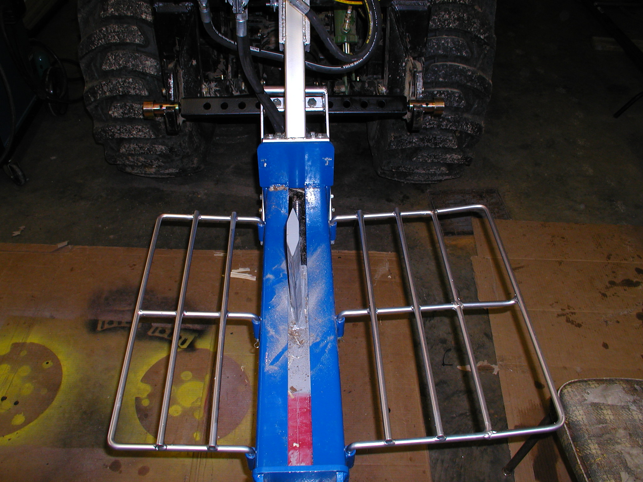

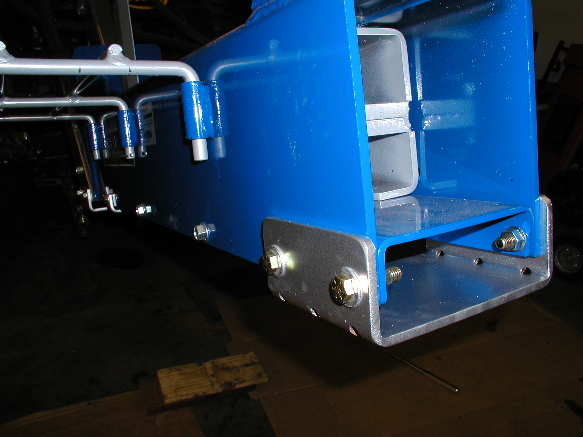

Here is how I dealt with that problem (see pics). I wanted it to have the range of working from ground level to about 30 inches. Also, wanted it to be quick hitchable. And later found it needed a wider work tray on the one side.
Now after using it a while, I find it to be a very capable splitter. I may move the control lever to the opposite side of the splitter now to get it on the same side as the throttle and three point lift lever.
