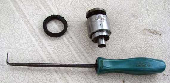

After having a slow diesel drip in my beloved 1995 F250 powerstroke that I keep in mint condition, I determined that the chances are 99% that it is leaking out the weep hole in the fuel pump and decided to change it. The dealership wanted $1025 to change it and I was able to get all the parts for about $140 so I decided to do it myself.
The pump is in an extremely crowded area in the valley of the powerstroke where you can't even see it without a lot of trouble. I found good instructions on line and went and bought all the parts I needed ahead of time.

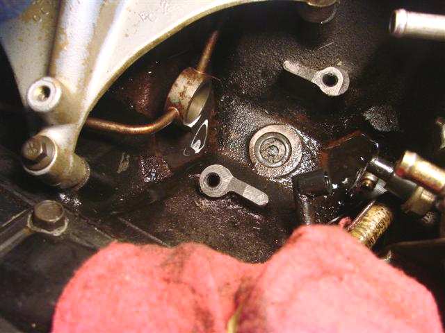

I followed the instructions and everything seemed to be going perfect when I finally started pulling up on the pump very hard to remove it from the valley. I thought I was pulling it straight up but must had pulled it sideways a little because the bottom of the pump broke off flush with the valley and remained stuck in it while I removed the pump. (see first photo)
When I saw what had happened I immediately had visions of drilling and ez-outs and metal filings going in my crankcase or a multi-thousand dollar repair job. (See second photo) I lost control and yelled a few choice words and caught myself just before I threw a hammer through the windshield. :(
After I calmed down I realized that it might not be as bad as I thought. First, I turned the engine over to see if the cam would push it out. No movement. Then I realized that the outer ring was a rubber o-ring and I got my snap-on pick and was able to remove it. Then I was able to push the outer part down a little so that the tappet shaft stuck up a little where I could get a small vice grip on it and pull up and remove everything. :) (photo3)
I was so thrilled that a calamity had been averted that I decided to have a couple of adult beverages and quit for the day and unwind. Everything is out now and so tomorrow I will have the whole day to see if I can put it back together again. Wish me luck!

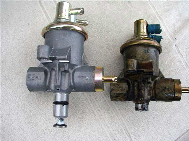

I'm about to do the same job. My Fuel filter canister had two pin hole leaks of which I fixed thanks to Mr.JB Weld. Can you tell me what kind of wrench did you used to undo the banjo bolt behind the fuel pump without removing the turbo bracket.Thanks Just Dave

The photo is the wrench I used to undo the banjo bolt. A 3/8 drive air ratchet with a short flex extension and socket and adapter.

One would do dickall with that itty bitty air ratchet on the one i did last year.Took a big *** combi wrench to crack that bolt loose.
I wouldn't wanna own one of these 7.3 contraptions if the gave it to me,what a PITA to work on:mad:
