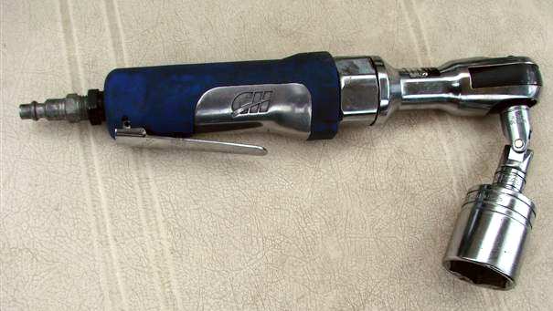

I'm about to do the same job. My Fuel filter canister had two pin hole leaks of which I fixed thanks to Mr.JB Weld. Can you tell me what kind of wrench did you used to undo the banjo bolt behind the fuel pump without removing the turbo bracket.Thanks Just Dave

The photo is the wrench I used to undo the banjo bolt. A 3/8 drive air ratchet with a short flex extension and socket and adapter.

One would do dickall with that itty bitty air ratchet on the one i did last year.Took a big *** combi wrench to crack that bolt loose.
I wouldn't wanna own one of these 7.3 contraptions if the gave it to me,what a PITA to work on:mad:
