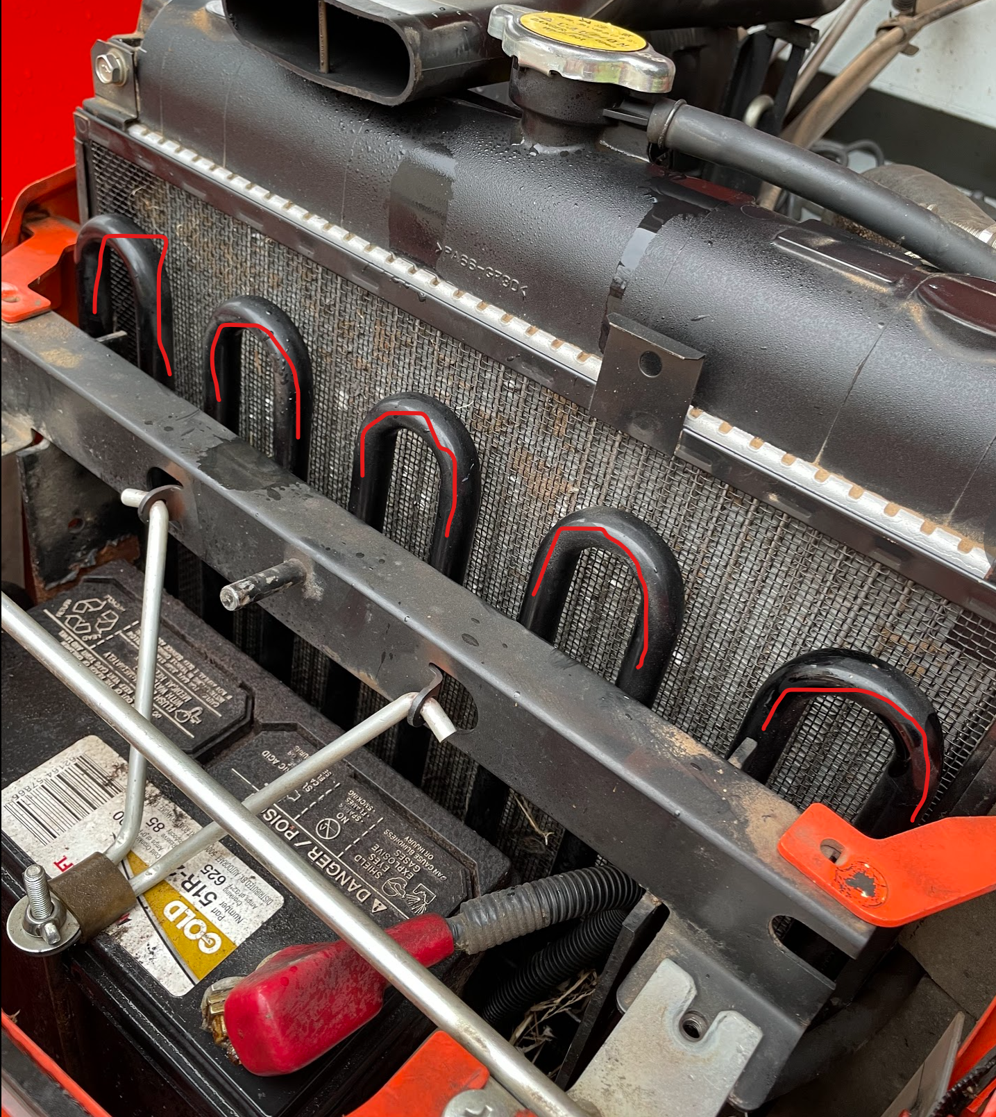

Yeah, you would more likely overheat the engine before the hydro, which is why the manufacturer provides a gauge for engine temp. As you said, the entire case is acting as a heat sync and there should be hydro cooler coil in the fan stack as well.
