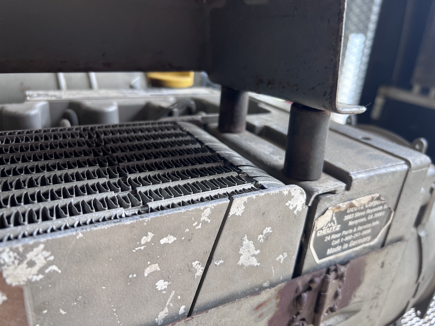

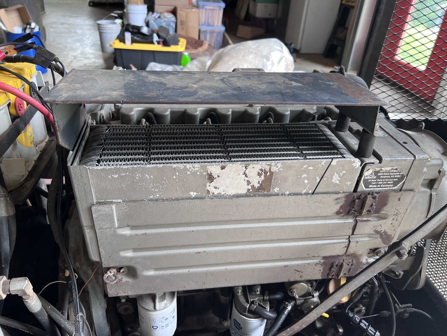

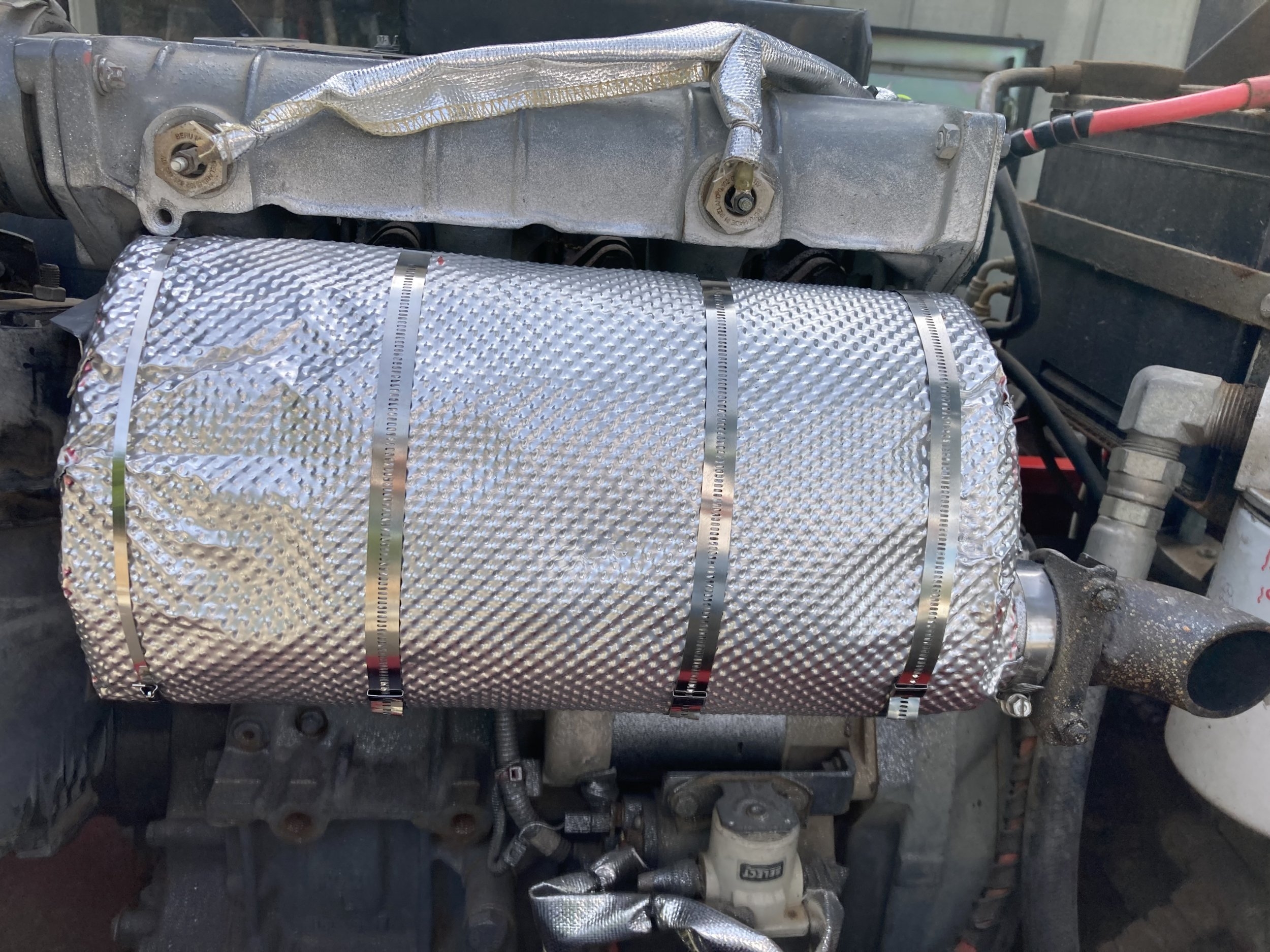

Aluminized wire loom protecting the glow plugs on the 1445 Deutz BF3L2011 engine.
In hindsight, I probably made the heat issue worse by trying to prime the muffler with Rust-Oleum Rust Reformer, which I found out later has an upper limit of 200F. It turns black as it dries. It then proceeded to flake off in the first hour, leaving rusty metal underneath, so I am underwhelmed at its rust reforming abilities as well.
So yes, sanded, prepped, and painted twice; once with the rust reformer and then sanded it down with an abrasive disk (way better than rust reformer or sand paper)
I used silver "high temp" paint the second time, but one that sets at about 400F, which is about all the Deutz can generate.
Did I mention that I love the intake heaters? They really help cut down the black smoke on starting below 40F for me. (Thanks @SpringHollow!) I am not sure that I need two, but they certainly work.

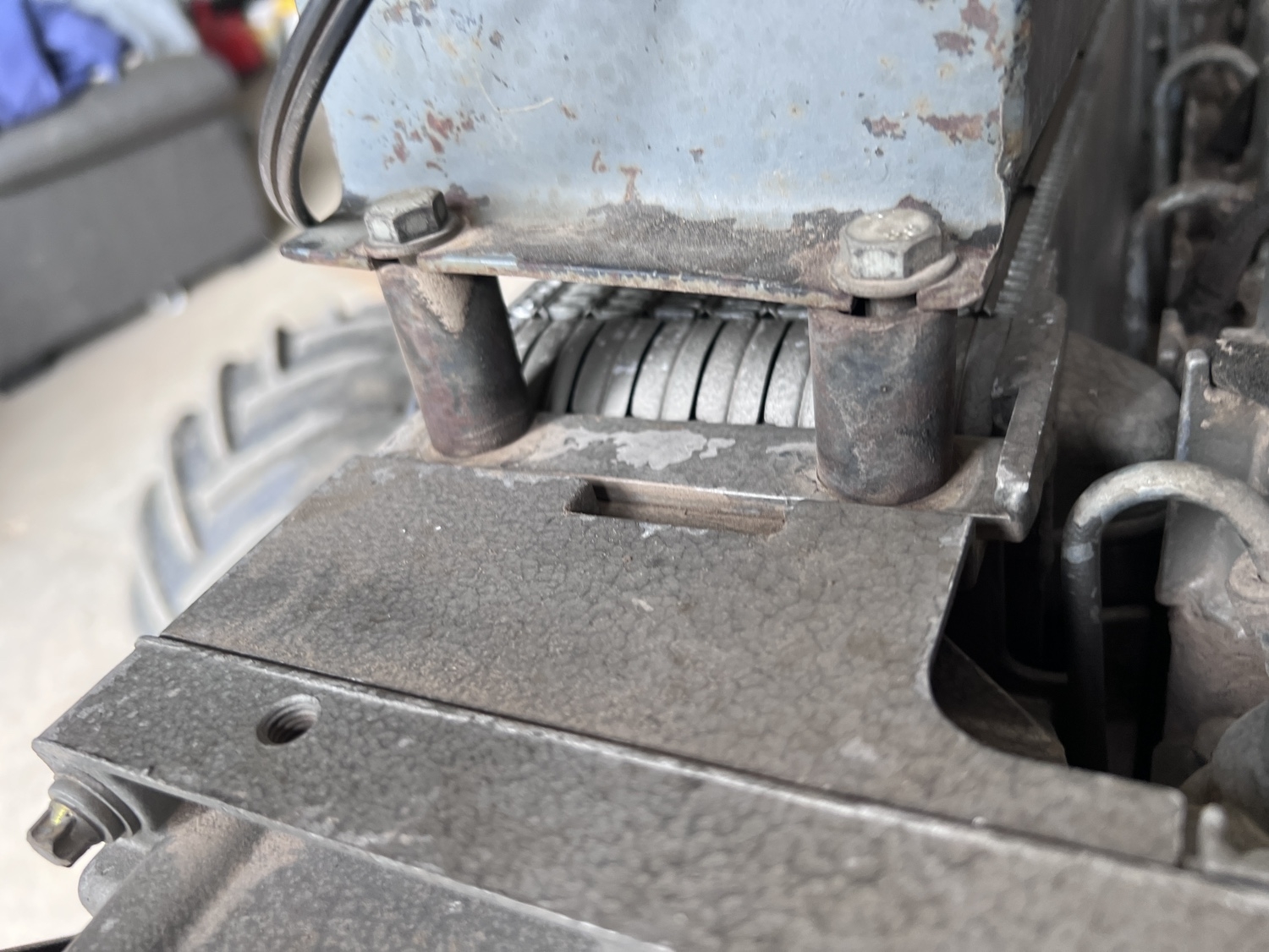

Might be better if you lowered the backside of the deflector so the air stream hits the shield at an angle and not straight on.
/ PowerTrac Specific Modifications #138
Can you tell any difference in the noise level after the wrap?

I'd be curious to see if that would make a difference on my 2001 PT425. Anything to reduce the heat under the hydraulic cooler would be a bonus, as long as it doesn't build up heat somewhere else, in my case.
/ PowerTrac Specific Modifications #140
Nothing too obvious to me, but the muffler didn't rattle beforehand, so I would not have expected a change. I guess the hotter exhaust gases might sound different, but I also wear Howard Leighton Leightning L3 (30dB NRR) ear muffs, so I don't know how reliable I am on this one...
All the best,
Peter
