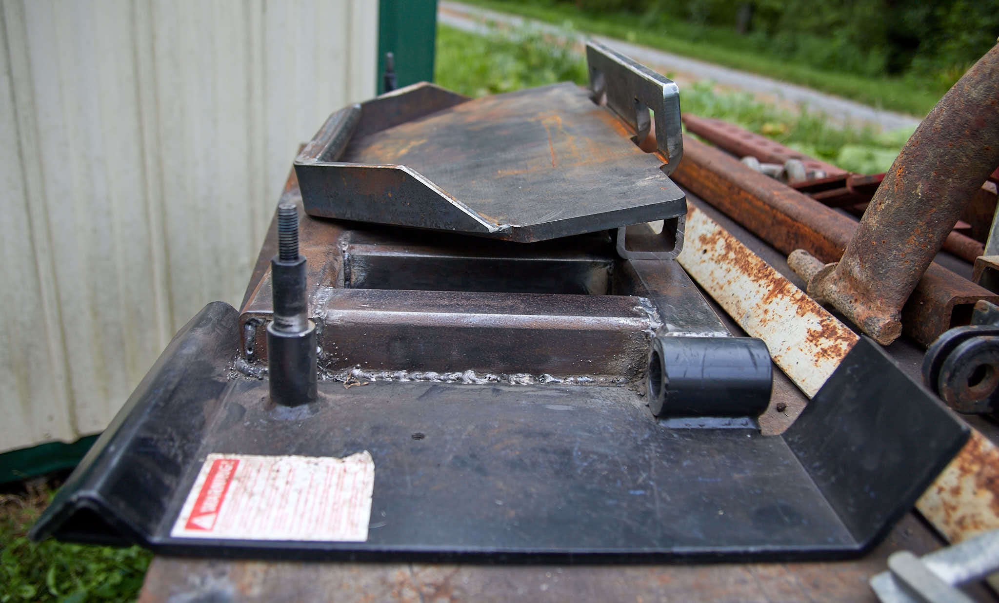

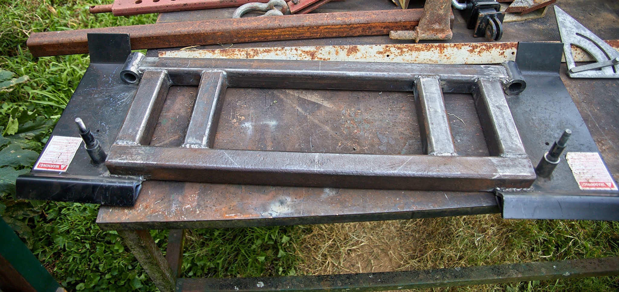

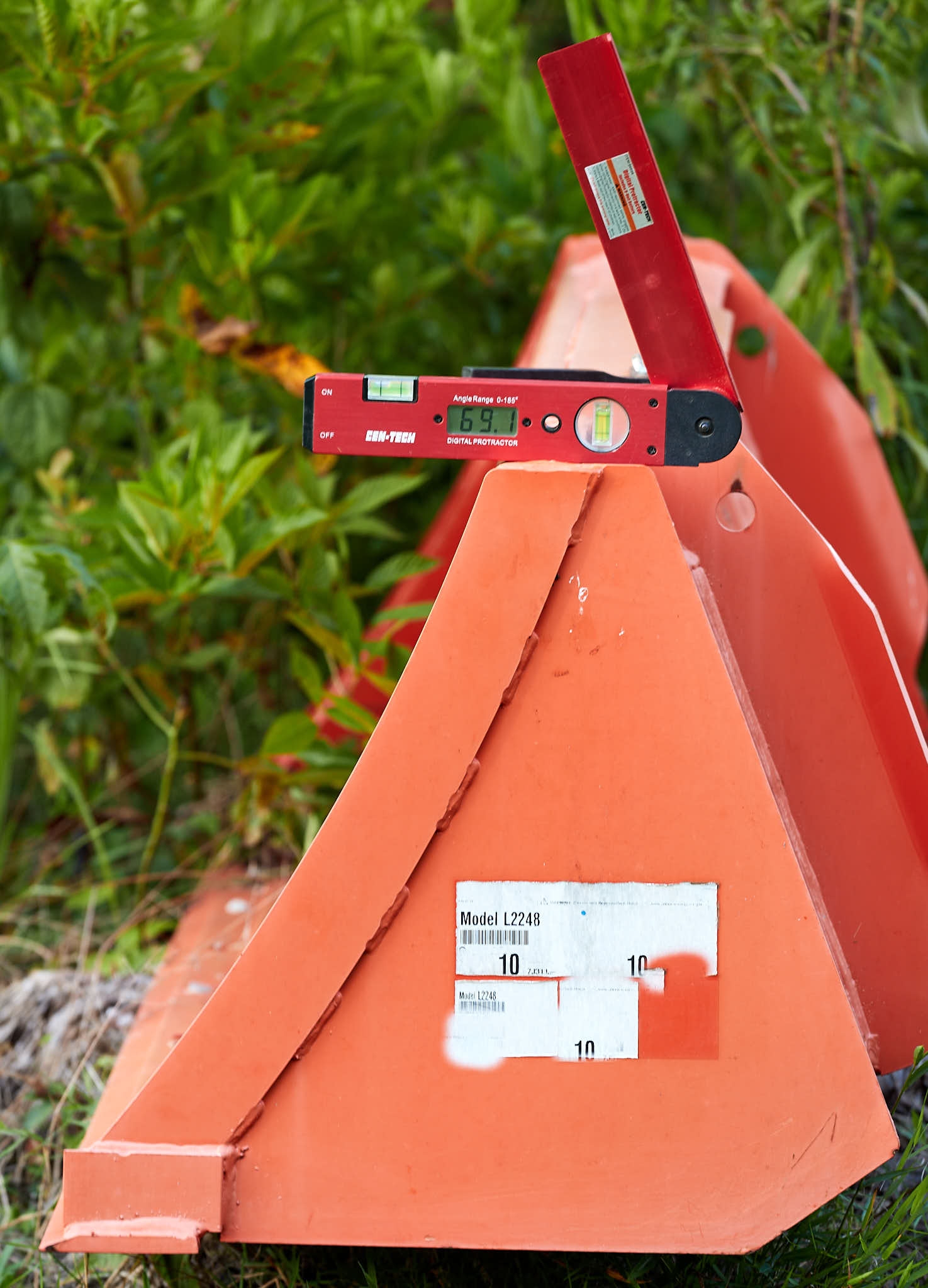

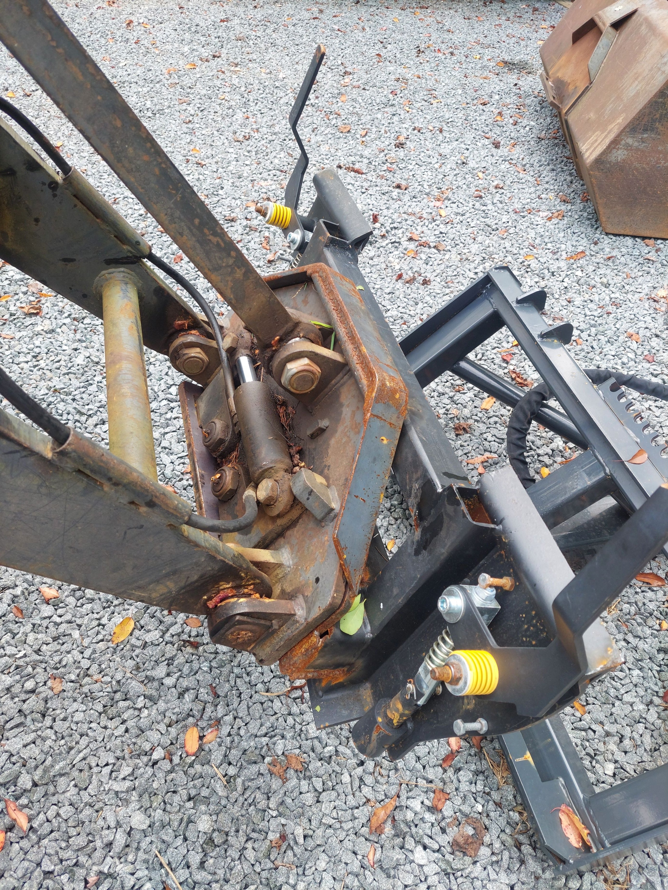

10.8 degrees which I roughly copied from ponytug's adapter in the sense that he used 2x2 tubing at the bottom to establish his angle. I couldn't find enough flat plate in the dimensions needed to totally copy his adapter, but I had enough 2x2 heavy wall tubing on hand to make this version.
Already seeing things I wish I'd changed. If I had used two vertical tubes in the very center of the adapter, I could have sandwiched a receiver hitch tube between them....
Overall, I suspect PowerTracManiac may have the better approach because the basic SSQA adapter he used as a starting point is already completed, and he didn't have to source a lot of other materials other than the angle his welding shop was able to provide.
   / Powertrac to ssqa adapter #42

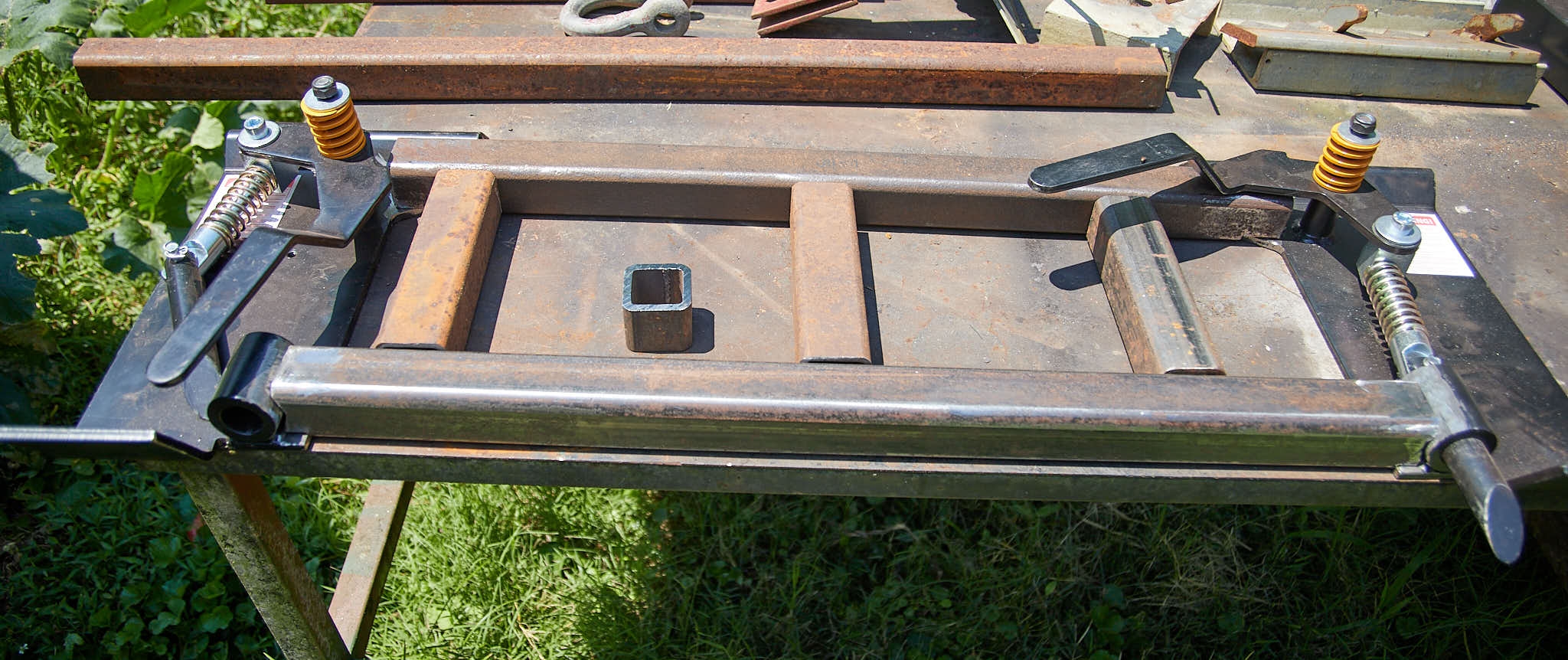

To illustrate the missed opportunity, I think I could have welded in a receiver tube between two tubes spaced in the center if I had thought of it before welding this up.

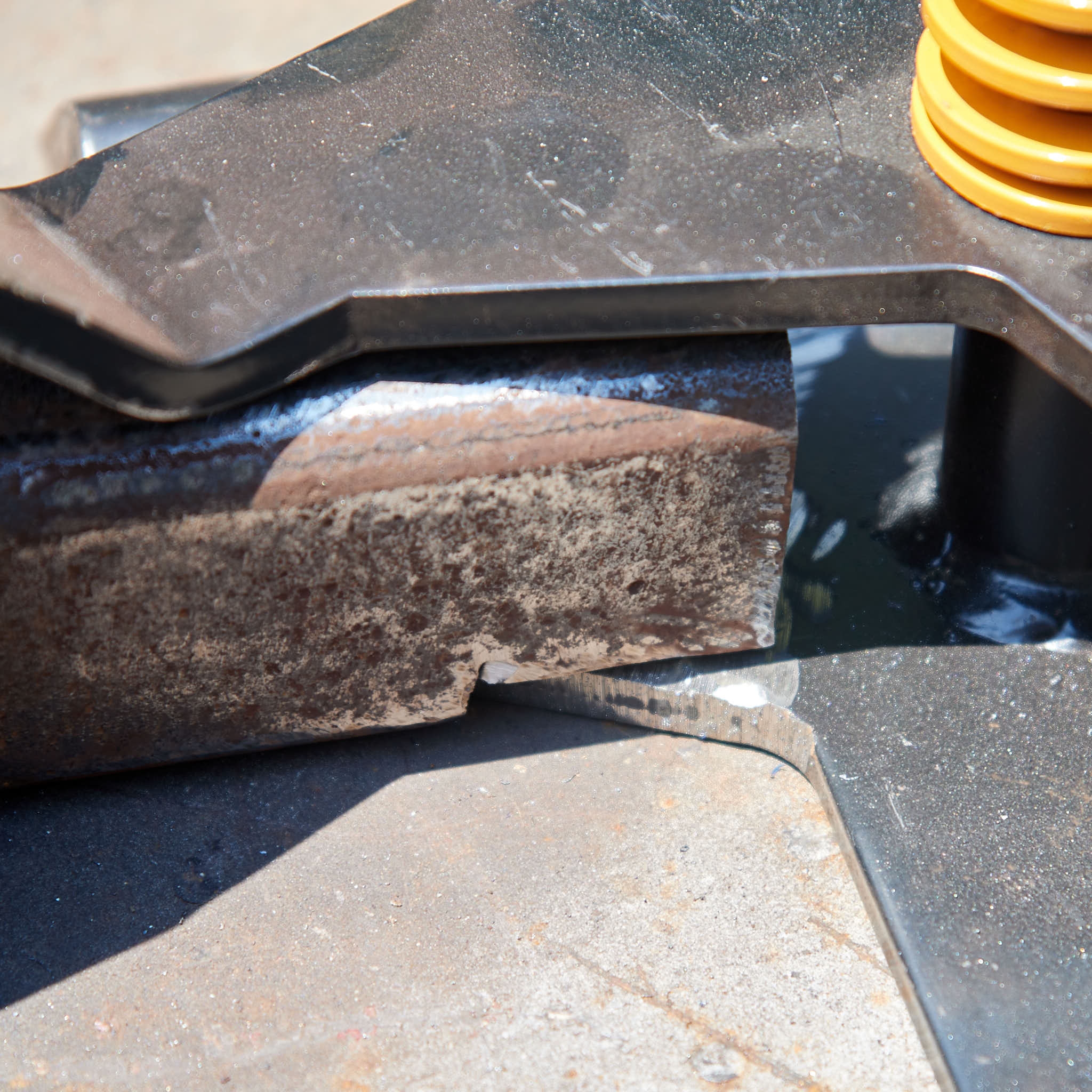

The latches don't seem to operate that smoothly compared to my Kubota (grease will help that). I welded in a couple of stops and a guide plate. Had to cut the latch arms down a bit to clear the PT plate.

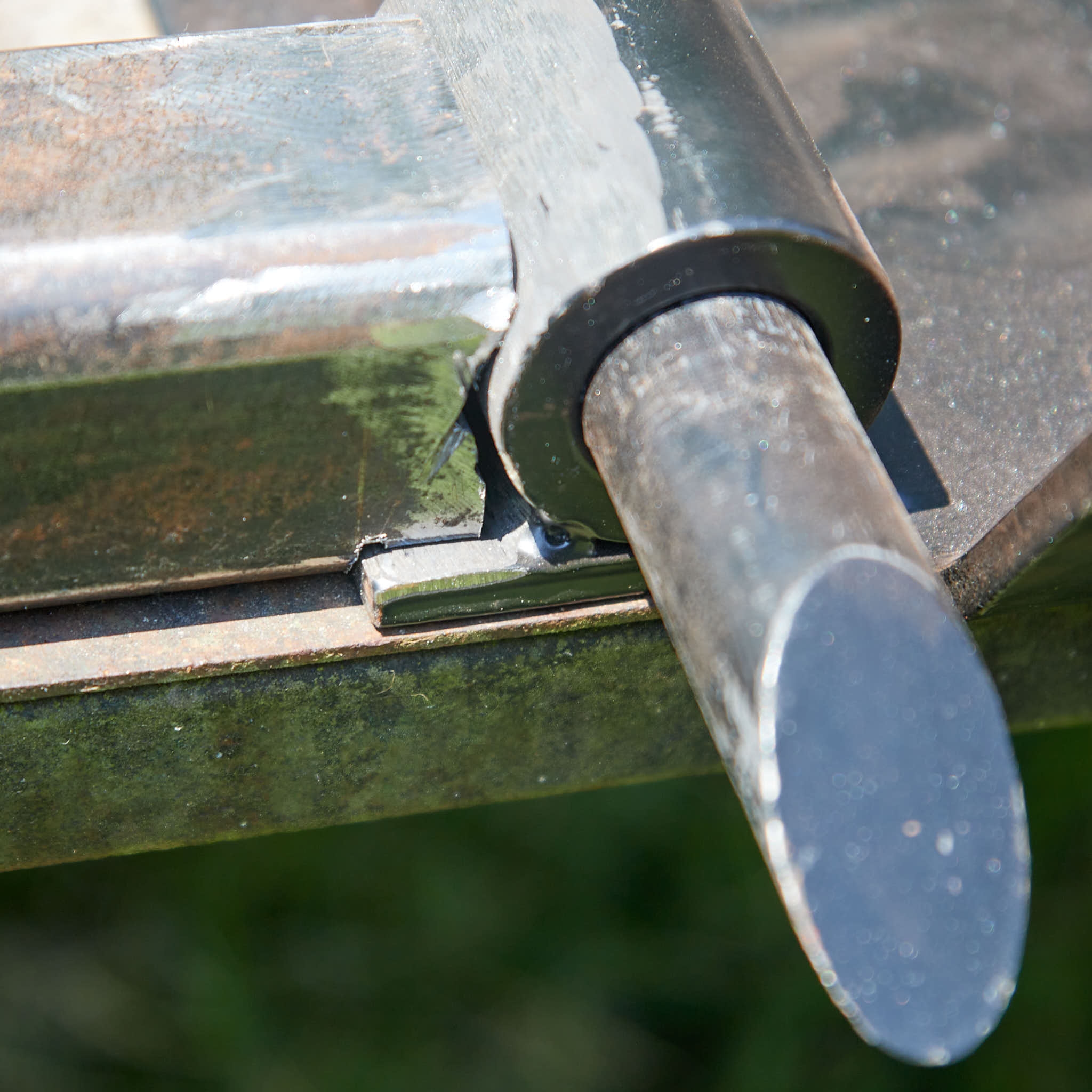

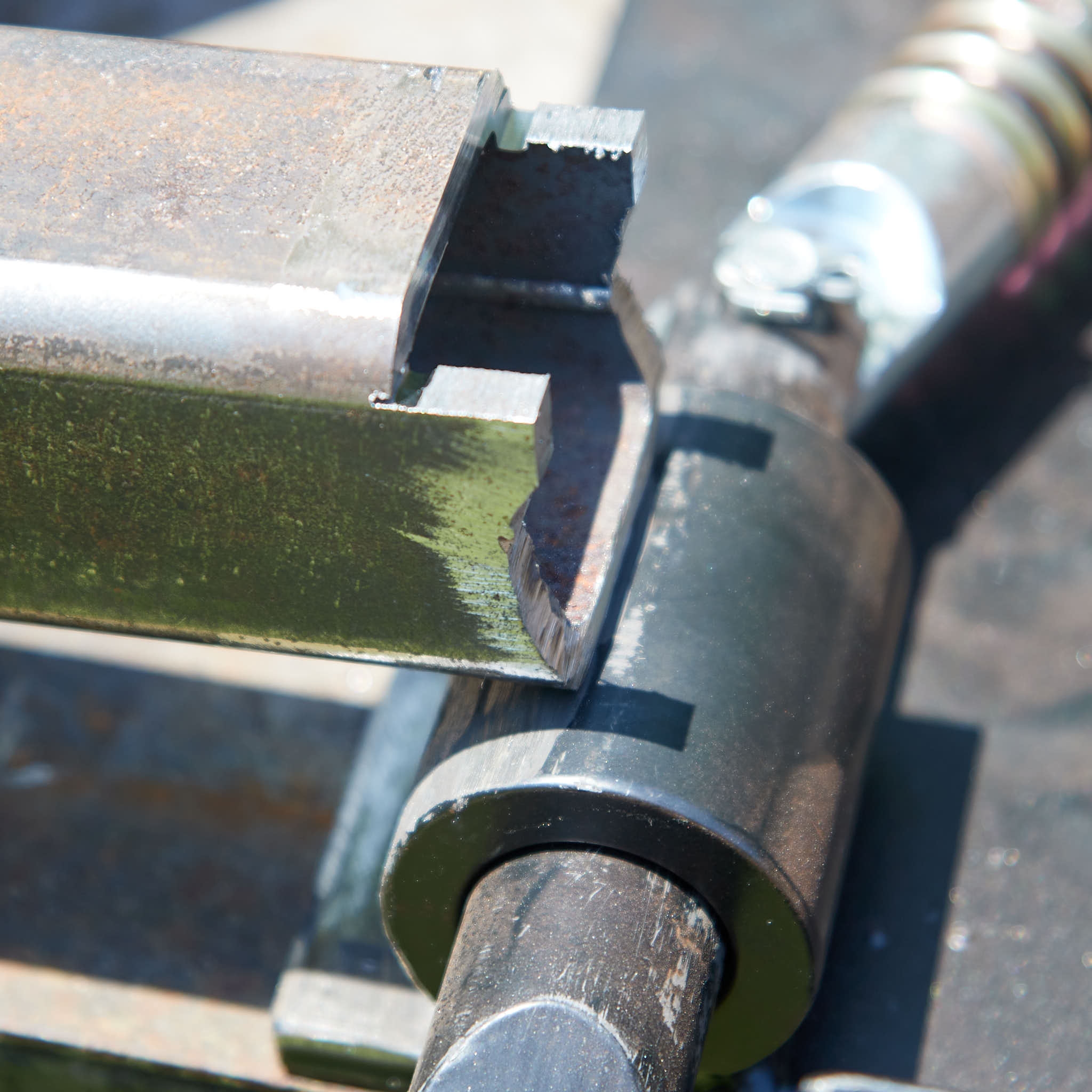

Make sure they go over center when the pin is latched down with the lever pulled up in your case:
   / Powertrac to ssqa adapter #44
Thank you. Is there a way to know when the latch spring is correctly tensioned?
   / Powertrac to ssqa adapter #45
I guess it is correctly tensioned when the latch pin stays down and latched.
What is the reason that your levers work backwards to latch and unlatch?
This is normal:
   / Powertrac to ssqa adapter #46
You are correct. I installed them the wrong way after I took them off to weld the adapter. The latch arms should push down to engage and pull up to disengage the pins.
It looks like I have full engagement and disengagement, but it would have been better not to have reversed the manner of engagement.

Also, as suggested above the adapter angle is a compromise. The curl is somewhat limited at full extension in either direction on my PT1460-even with stock implements and no adapter. Since most implements are usually run in the middle range of the curl and not the extremes, I think your angle will prolly work out OK.

   / Powertrac to ssqa adapter #54
This is normal:
Returning to this subject, the stops that I welded in place prevent the latch pin from going over center, and I had to cut them out.
I very much appreciate your keen eye and pointing this out to me before an attachment could fall off.
   / Powertrac to ssqa adapter #55
You are welcome.

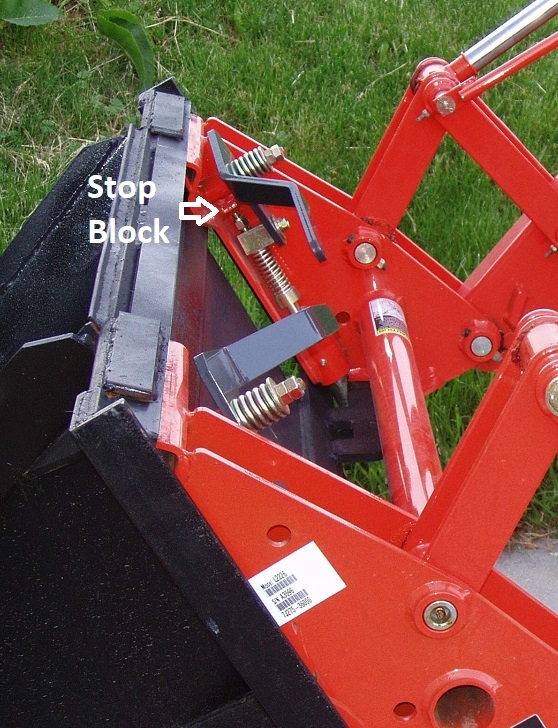

Some guys have added a stop block to prevent the pin from getting pushed up even though the linkage is over center:

How is the top of the Q/A attached to the SSQA? I had to re-weld my first attempt due to a few cracks, so I added reinforcements. (Bad design/ bad welding)

I kept meaning to say that on mine, I kicked the bottom of the attachment plate out ~5 1/2 - 6" with a plate of steel and welded sides to it as well. It has worked well. I can tilt my bush hog down over the edge of a steep bank and reach down about 8' from the top. So far, it has worked well with a finish mower, bush hog, and grader.
