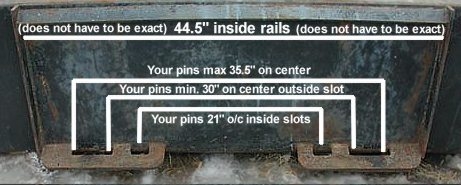

So if your implement plate is 44.5in wide like in this diagram at the top and your ssqa plate on your machine is only 39.5in wide at the top do u need to weld some blocks on the sides of the implement plate at the top bracket to make the spacing less wide at the top to keep it from moving side to side or do the bottom pins pretty much hold everything in place?
It seems that there are slightly different sizes of ssqa plates and implement backing plates? I would never have thought that it would be the possible to have slightly different sizes because I assumed that ssqa was a standard for a reason and that all this ssqa shizzzz would fit each other perfectly?
   / Powertrac to ssqa adapter #23
Isn't it wonderful when a "standard is "kinda, sorta"?
The image you posted sums things up, but yes, there variations on the original BobCat design. The inner pins are for smaller variants, and the 1m vs 43.5" upper plate is, I think, manufacturer variations for patent and strength reasons. A wider plate can transmit and receive larger forces without damage. While the variations may be somewhat to try and keep customers within one company's products, I think that there are engineering considerations as well.
Bottom line there isn't just one SSQA, but 1m wide, with wide pins will fit most implements.

   / Powertrac to ssqa adapter #24
Keep in mind that I don't actually know. My guess is you should test fit your adapter on the attachments you intend to use. While my MTL grapple has the extra pin slots, my Kubota bucket does not for example.
I suspect that the SSQA is locked in place whether it is the nearly 45" width or not because the angle of the top mount and the angle of the bottom plus the pin wedge the SSQA in place on the attachment. But....extremely important that the pins are properly locked in place.
   / Powertrac to ssqa adapter #25
Width can be an advantage as it gives the attachment and skid steer or tractor more lateral engagement.
The Bob Tach is technically an ISO standard, but many manufacturers do not adhere to it.
All the best,
Peter
   / Powertrac to ssqa adapter #26
I think that's right if starting from the point of having two loader arms spread wider to the 45" width.
Since we are already starting off with a narrower PT plate, having a narrower SSQA adapter would seem stronger than if we were trying to span almost the entire 45" width given the same material sizes.
But having come this far, I don't see any turning back for PowerTracManiac other than to see if the adapter fits his attachments and then how it performs.

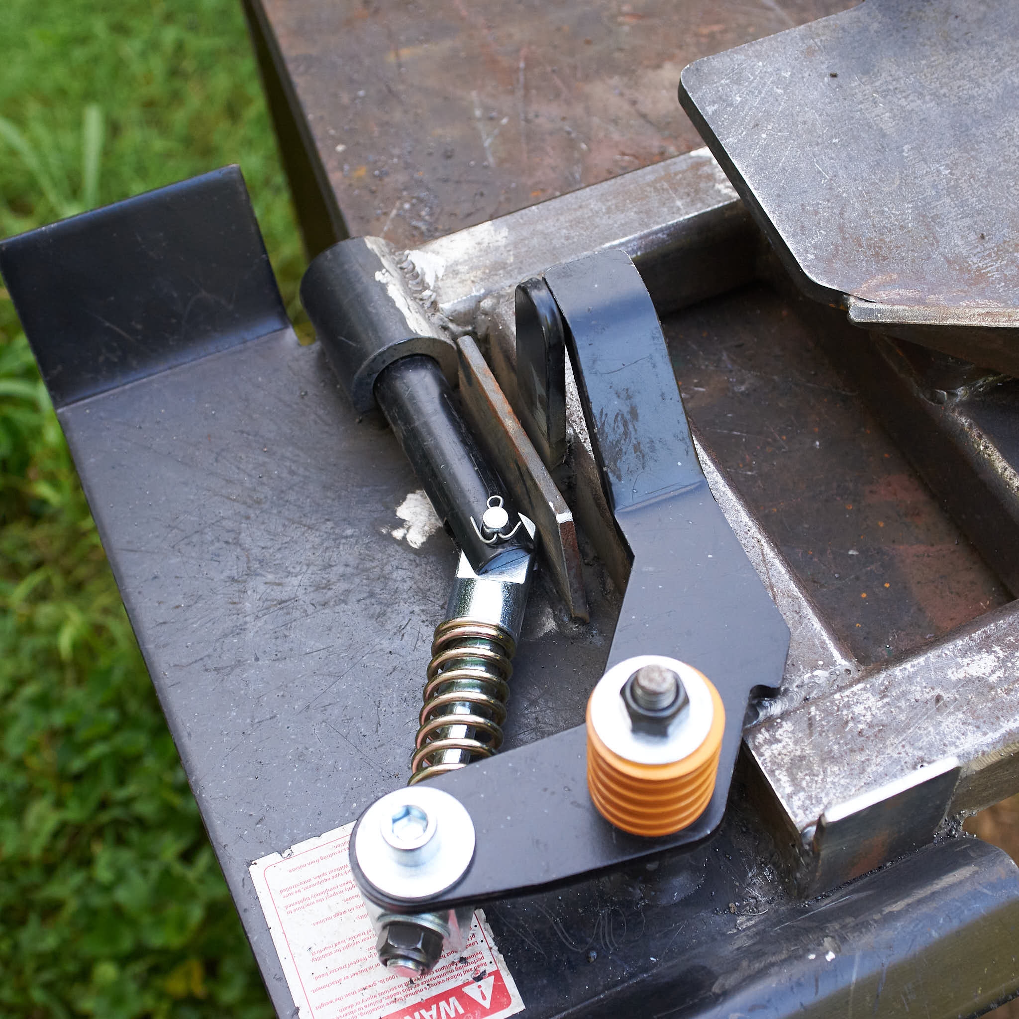

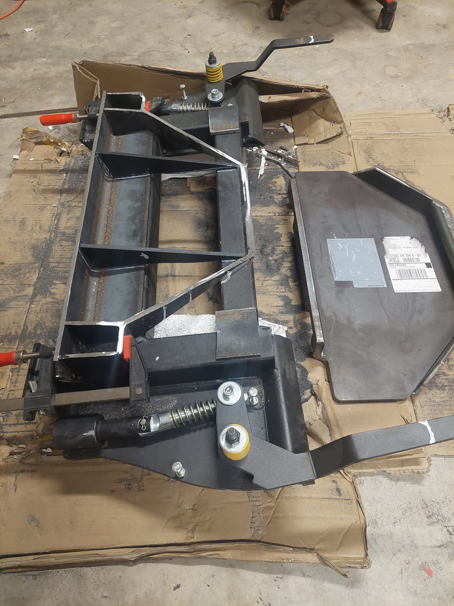

That's right 2many--no turning back--full steam ahead!

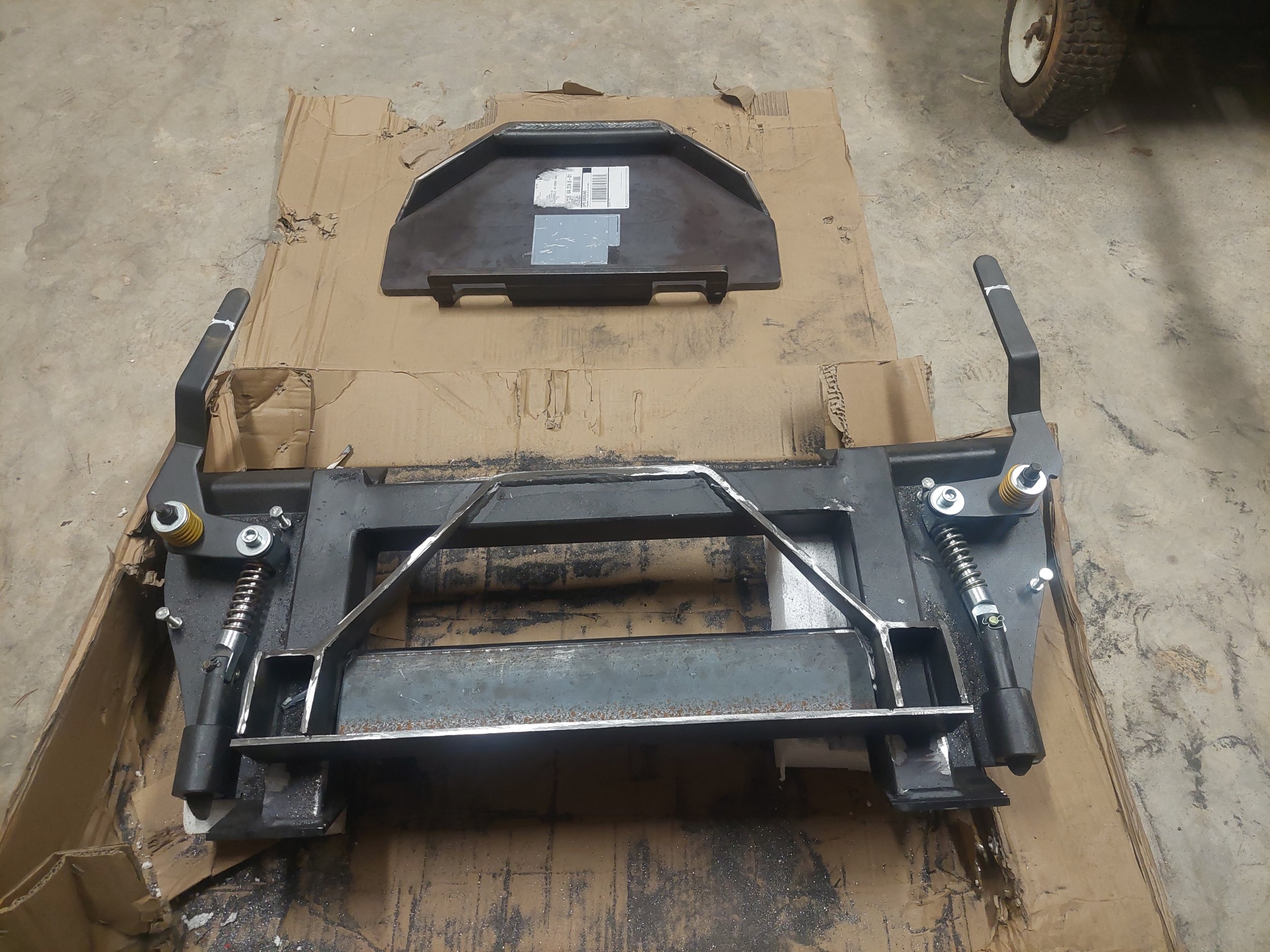

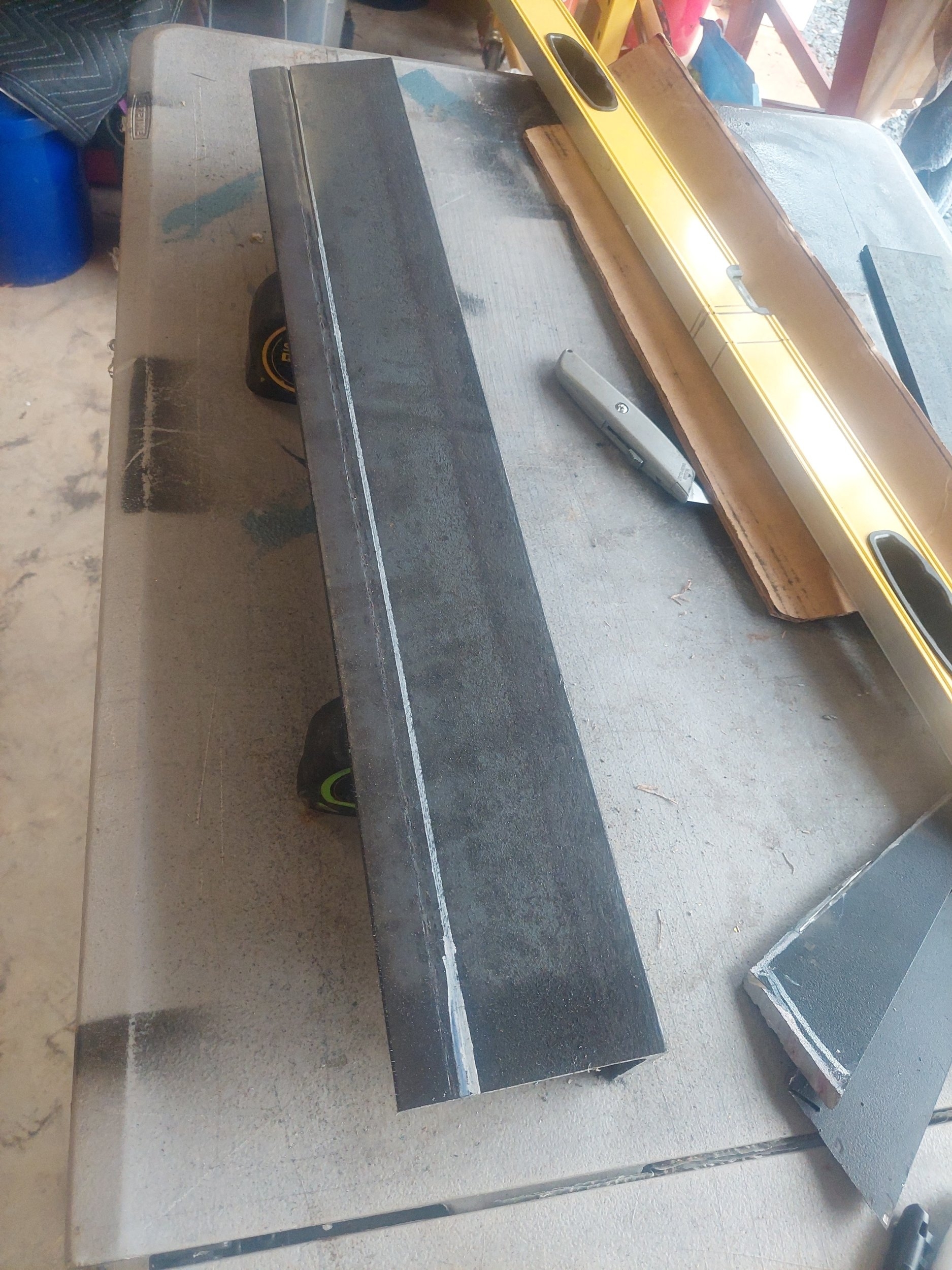

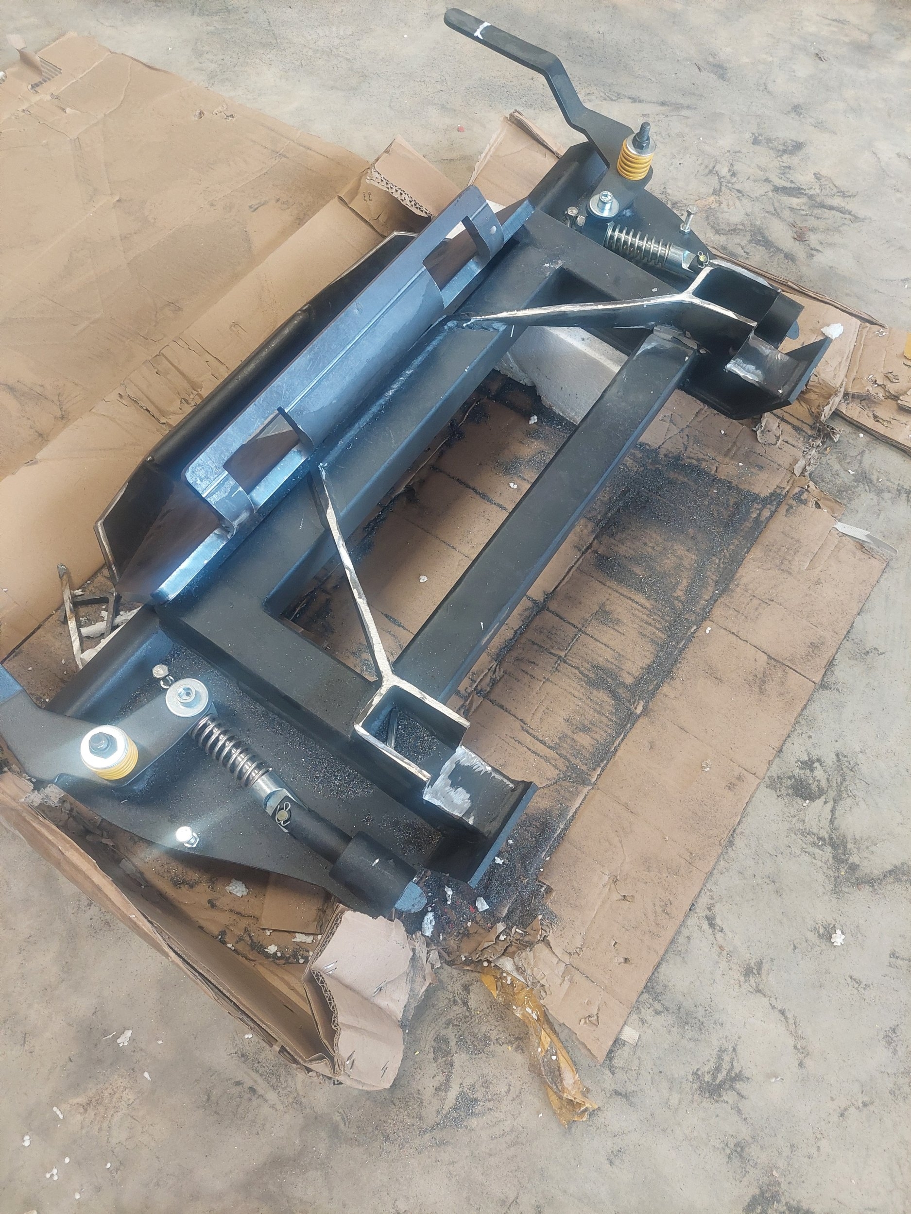

Finished up the angles and cleaned up some unnecessary bits of the 3pt. portion of the ssqa.

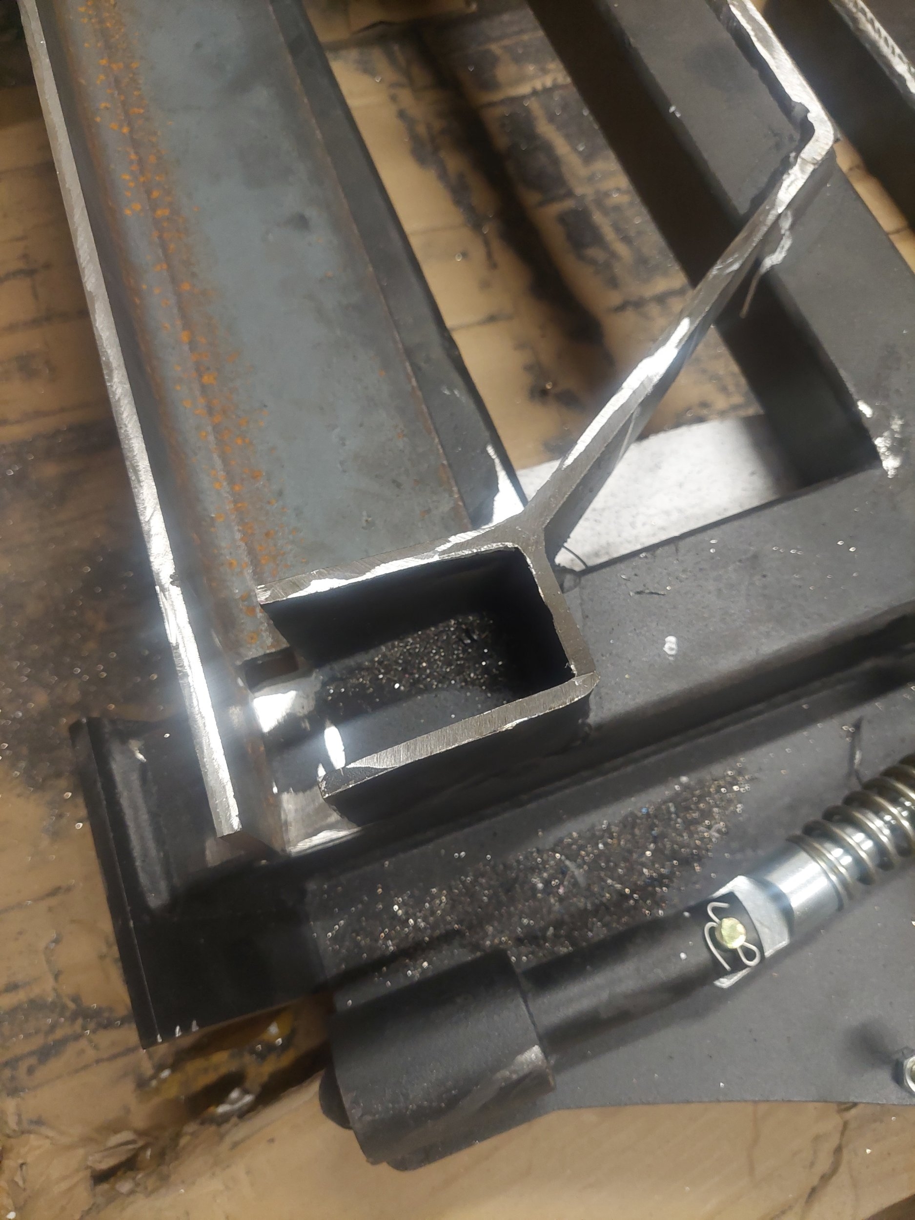

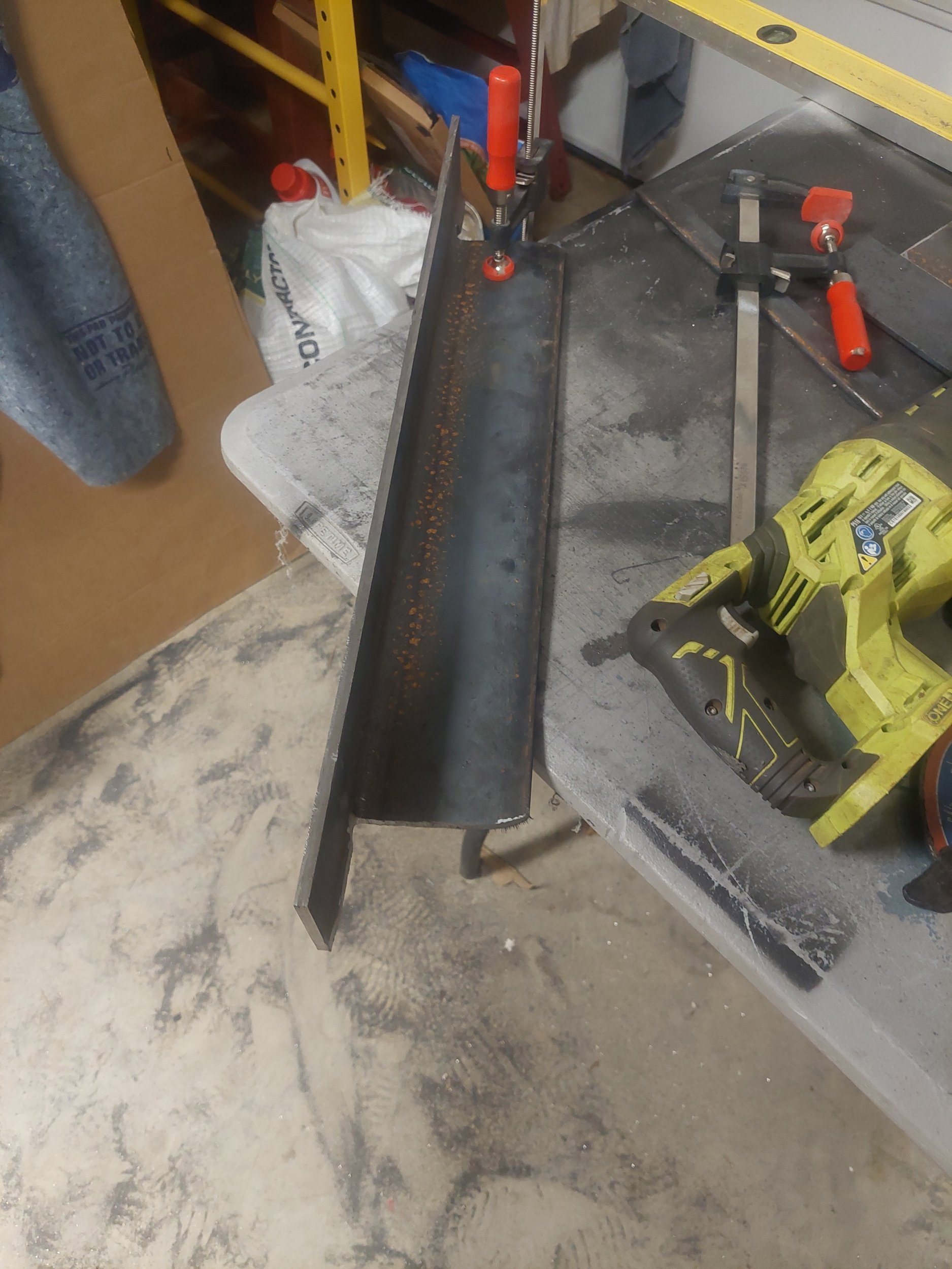

Moving onto the bottom support angle iron. Bought some 4 by 4 angle iron at the local metal shop. There were very nice to me and cut this piece to exact length and sold it to me without having to buy the whole stick.
Notching the bottom of the angle iron to fit up to the old 3pt side supports and trimming one side so its at the right height and the PT plate can rest on it and get welded to it.
I am happy with the concept and the fit up.
Ready for welding. Don't have a welder and never welded before. Wish another member was close by and could teach me?

Looks great!
What kind (brand and type) of welder do you have? If you have the patience, there are some good welding channels on YouTube, some like "I c weld" use a variety of techniques, some like "cutting edge engineering" (mostly MIG, but easily the best welder that I have ever seen) or "Welding tips and tricks" (mostly TIG). Fireball tools have some welding videos, but they are heavy into using their own jigs and tools. However when the rubber meets the road, it is also a manual skill, and tips on surface cleaning, alloys, wire & rod choices, current, heat response, pre-heat, and setup only take you so far. At some point, you need to go do some, and then critique your work, and go back to the training materials with new eyes, and then back to the metal with new eyes and hand coordination. I remember a story about a beginning potter who was instructed by his elder teacher to throw away his first 3,000 pots. Think of how many shots Steph Curry takes day in day out... I will say that computer controlled welders, especially of the synergistic variety do lower the barriers, as does HF start welders for stick and TIG. I.e. you can buy yourself some expertise. I made myself some copper spuds for backing shields and high power edge to edge welding when I was just starting. I will take any help that I can get.
If you are wanting to learn, how about a local vocational or junior college class or two?

You've already done all the difficult fabrication work. I would think your local welding shop could weld this up quickly and inexpensively?
