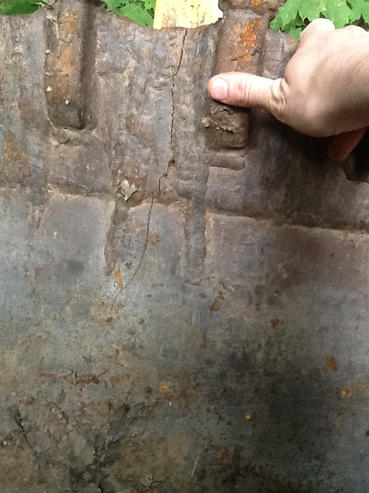

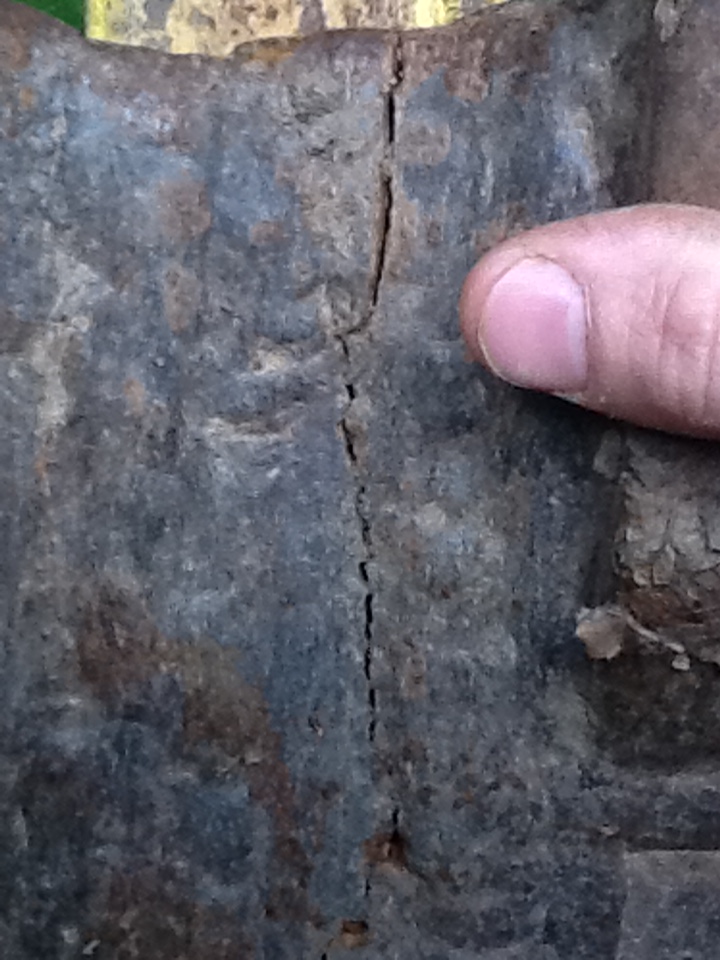

Showing some pictures of what your trying to fix would be very helpful.
   / Precautions while welding on tractor
IMG_5065.JPGIMG_5064.JPGI will post them tonight.
Here are the pictures of the backhoe bucket crack.

<img src="http://www.tractorbynet.com/forums/files/welding/441948-precautions-while-welding-tractor-img_5065-jpg"/><img src="http://www.tractorbynet.com/forums/files/welding/441947-precautions-while-welding-tractor-img_5064-jpg"/>I will post them tonight. Here are the pictures of the backhoe bucket crack.
Looks like someone has already been there a few times before you and yet the crack keeps coming back. I would be looking for the root cause: bucket lip worn thin, abusing the bucket, poor welding etc. Your welder isn't up to the task, plain and simple, unless that bucket is pretty thin and then that is likely the reason they bucket continues to crack

I've only been welding a few weeks now. But I think the first thing I would do, is drill a hole at the end of each crack.;)
   / Precautions while welding on tractor #10
I agree...stop drilling should end the propagation...and definitely do bevel the crack for best penetration.
   / Precautions while welding on tractor #11
Lot of weld already been laid on that bucket. Cant say much about the quality of the weld from pics, but it aint looking good. I am guessing the weld was just laid down on top of the metal without proper grinding. I would forget using the 140am mig and look for someone that has a 200+amp mig or a good stick welder to fix the crack. I would also drill the end of the crack, but certianly grind a good vee along the crack and then weld it up with multiple passes as I already described. I would also ping the weld with a hammer after each pass with the welder to take out some of the stress of the metal heating up and cooling off.

View attachment 441948View attachment 441947I will post them tonight.
Those pictures show the crack at the high wear area of the bucket. The steel the teeth are welded to is not just mild steel like the rest of the bucket. The way I would do it is to vee out the crack. preheat the area to 400 degrees Fahrenheit and weld with 7018 electrode. And maintain the 400 degrees while welding. after it has cooled I would vee out the other side and repeat the process. As others have said, the welder you have is not the one for this job.
   / Precautions while welding on tractor #13
I just saw the pics, and came to the same conclusion.
And it may be hard to see the real end of the crack. Grinding the surface beyond where the crack seems to end, then applying some acetone, and wipeing the surface dry, may reveal the true end of the crack. There are kits that are made for crack detection that may work better.
