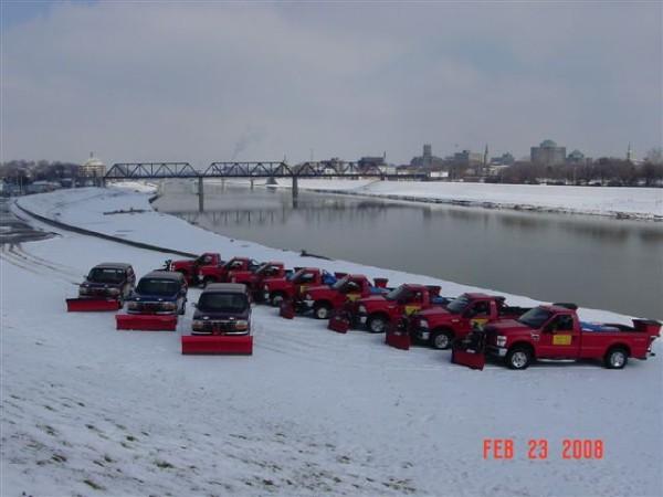

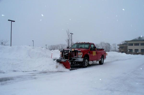

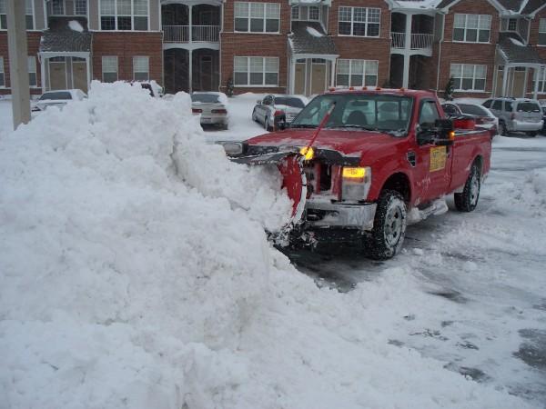

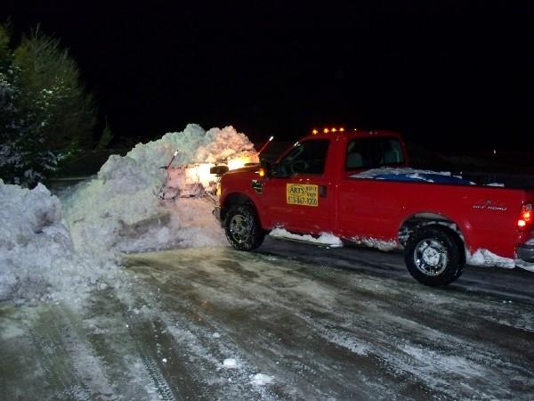

I would still not rule out the V-10 Ford. I know lots of guys with them. My uncle has had 2 with zero issues. None that I know of have had any problems. My buddy Art, a boating buddy, runs a F-350 Diesel, 3 5.8L Broncos, and these 8 2009 F-250's powered by V-10's all with plows. They get worked hard and no issues
The F-350 is not pictured. The picture was take from it.
They are very popular around here. Many boaters like them because of the Ford towing capacity and the cheaper price of entry vs the diesels.
Chris
