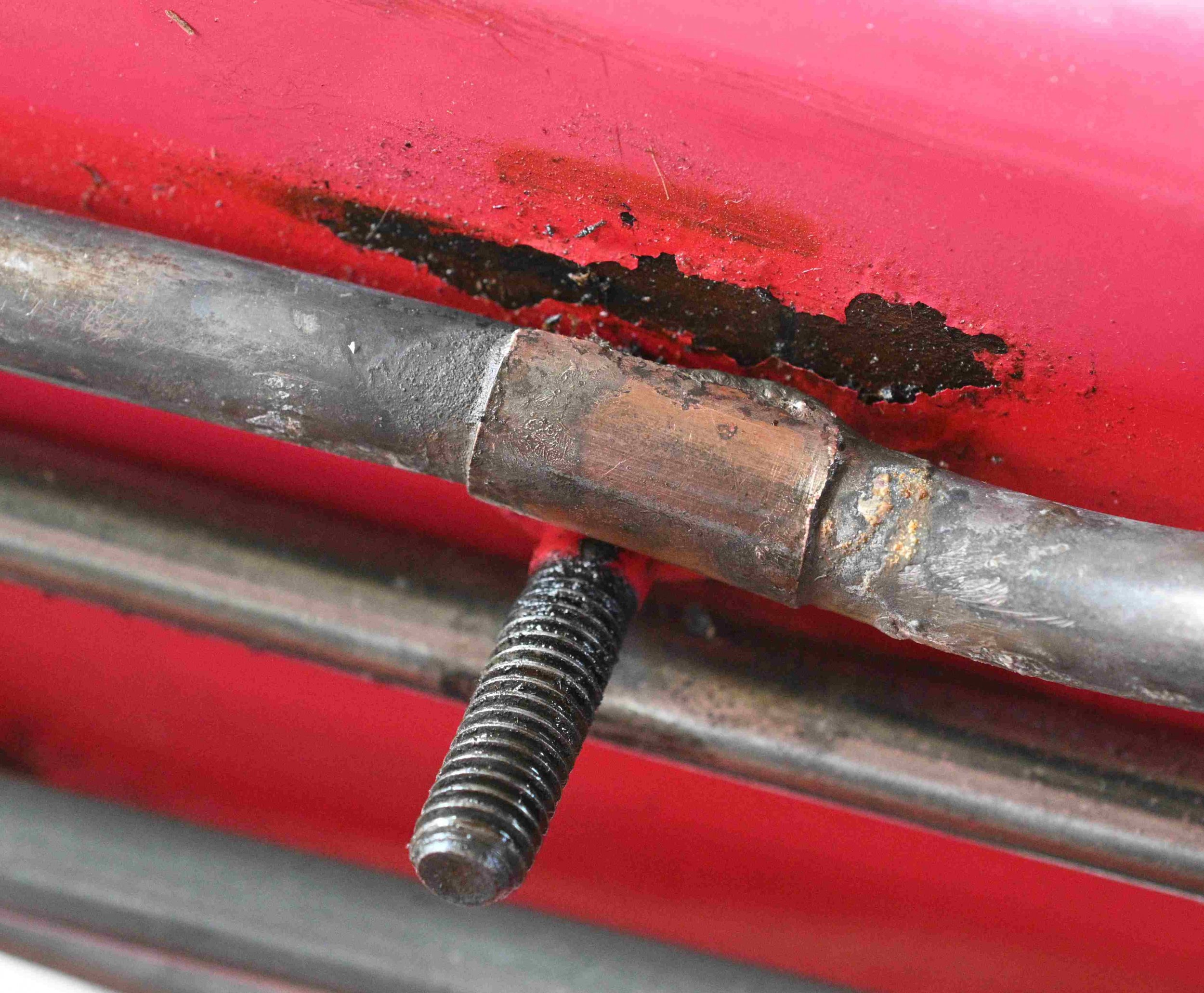

Trying to answer the questions that have been asked....
I bought a Harris silver braze kit maybe a year or 18 months ago. Tried to braze it once already and then the leak returned. I think this is the kit I bought. https://www.amazon.com/Harris-Solde...37530&sprefix=silver+braze+kit,aps,359&sr=8-5
Here are two pictures of my patch job. Does it even look like it will hold or is it obvious to the trained eye that I need to do it again?
The line isn't hard to remove. The issue I'm having is cleaning the tubing and then not having any experience with silver brazing like this.
The only steel material I think I have on hand that would comform to the shape of the loader line would be some 1/2 galvanized pipe or black pipe used for gas supply line. I tend to think not to use the galvanized?
Locally, we don't have a shop that fabricates hard lines like this. There is a place that can do custom hoses. I'd prefer a metal line, but could I substitute a hose if I can't repair the leak?

I agree with you steel lines even patched ones look better than hoses running down the boom.
You bought some very good silver braze wire.
if it leaks which I am afraid it might you need to start completely over and sand the tube back to clean metal.
Find some flat steel and bend it around a bolt or 3pt pin.
copper may work, I don’t know I have always made a small patch out of steel, it don’t have to be very big.
Looking at your photos I think maybe you got it too hot, the right heat and cleanness is the key.
I have fixed a lot of them in the field, quicker than running to town and getting a hose made. You couldn’t get a new steel line made any closer than 200 miles from here.

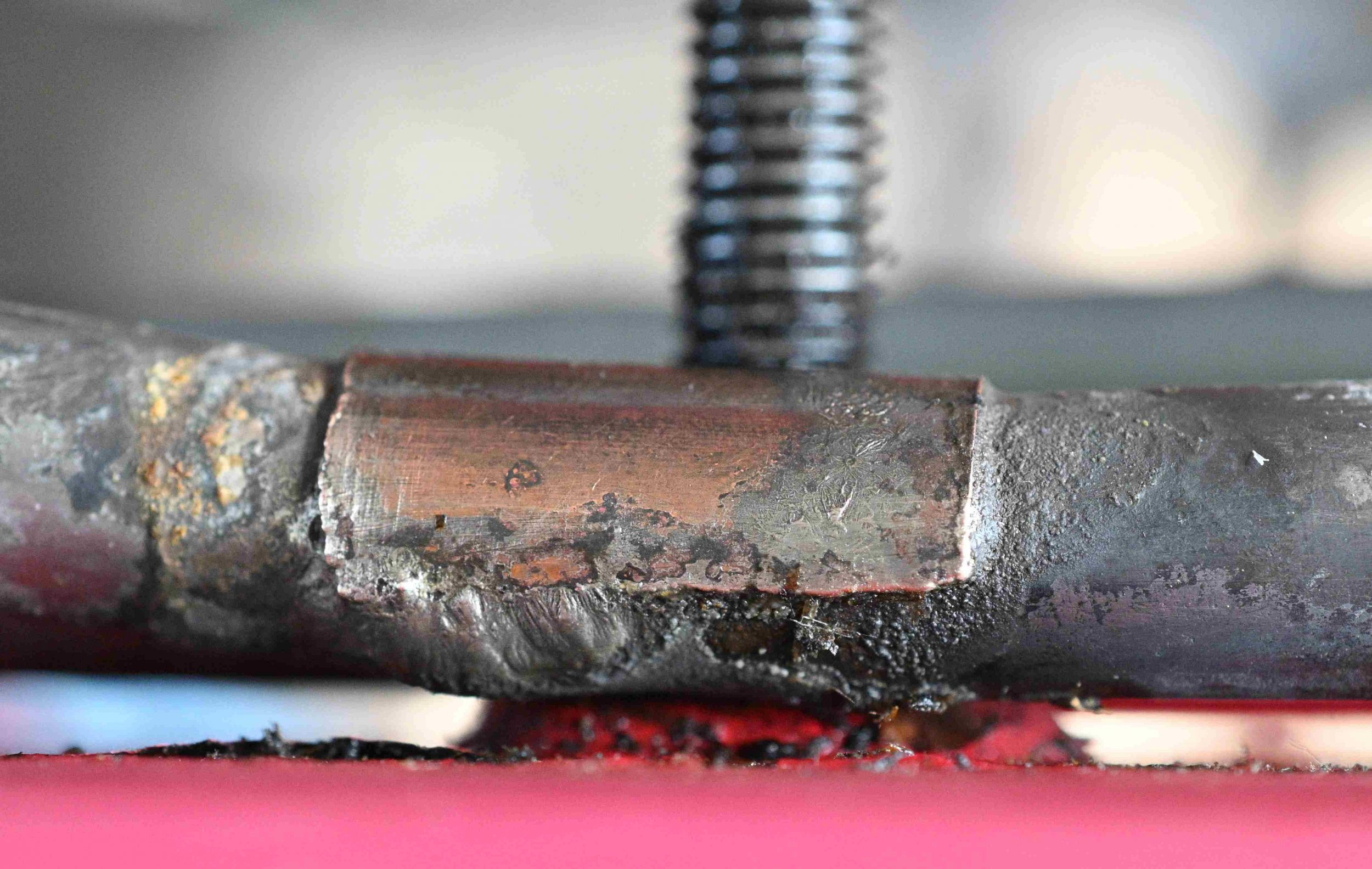

Well if "The line isn't hard to remove." I'd simply remove it and get a replacement. Most auto parts stores have steel brake line all sizes and lengths. You could even get a longer one that diameter, cut ends putting correct fittings on and flare it.
Here we have a NAPA store that custom makes hydraulic lines of all sizes.
Trying to patch I could see so many problems especially spraying, cylinder collapsing, etc.
   / prep work to silver solder braze loader hydraulic line #19
What is the OD of the tubing?
If a new tube isn’t in the cards the best approach is to cut out the bad section and sleeve over the existing tube, then silver solder, braze or tig weld.

Well, it was a totally bad idea to put copper on a steel line because of galvanic corrosion. Should have thought of that before. There's a hydraulic hose fab shop about 30 miles away. Will give them a call to ask if they do steel tubing.
