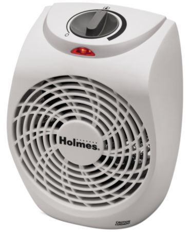

Up here, the smallest 120vac heaters seem to have ceramic elements. I like the ones with 3 heat settings (typ. 500w, 1000w, and 1500w). Anything UL or equiv. approved should do the trick for you - down your way I'd be surprised if you need to run one higher than 500w for that application.
Rgds, D.
something along these lines
Holmes HFH131-TG Personal Fan - Personal Care - for the home - Macy's
1714517_fpx.tif
One has to space it away from the backrest so that it gets airflow and strap or bungee it in place so that it does not fall over.
WOW. The heater in the link is 1200 watts! Am I allowed to buy a small heater from Macy's to put in my truck? :laughing::laughing::laughing: I would think the heater needs some camouflage or a touch of green to go in the truck. :D Shockingly, Cabela's does not sell a similar unit. :laughing::laughing::laughing:
I would think 500 watts would be enough to warm up the truck enough to clear off the glass. Just saw this one on Amazon, Amazon.com - Lasko #100 MyHeat Personal Ceramic Heater which has good reviews and I would think 200 watts would be enough to warm up the interior. Certainly it is cheap enough to try.

Its got a thermostat.. Once the cab temp reaches the level set by the thermostat, it will cycle the heater on and off while the fan keeps blowing. Very few companies make 500W heaters since that would be a very niche market. Some of the heaters have 2 heatting stages and you can turn on 1 or both.
Dont forget the timer ? 1-2 hours is all you will need to have a comprehensively defrosted car. Then you will be able to see where you are going and any slush left anywhere on the outside will be easy to remove and not glass hard.

Price is right. I know you've seen a bit of snow down your way in recent times, but probably don't see -40.
Try the 200w one - can always kick the timer on earlier if an hour or 2 isn't enough.

200W = 2 old fashioned light bulbs. I highly doubt that is going to have much impact in a real midwest cold spell.
Given that about any house wiring I have seen will run a 1.5kW heater, I don't see the problem.
With my F250 I have the block heater and the cab heater running on the same circuit. It works pretty well. Certainly takes a LOT longer to get going if I forgot to plug in when I get home.
