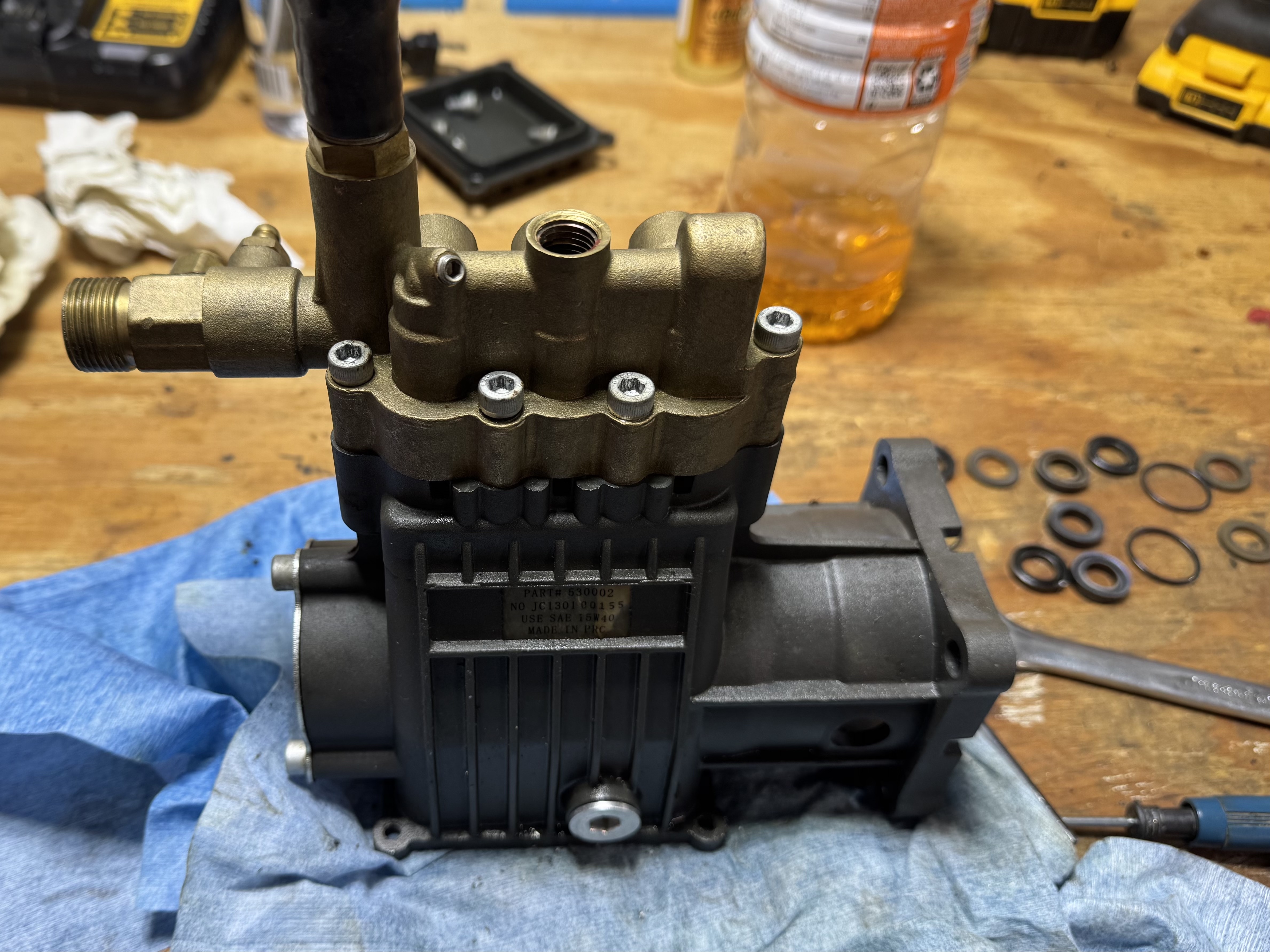

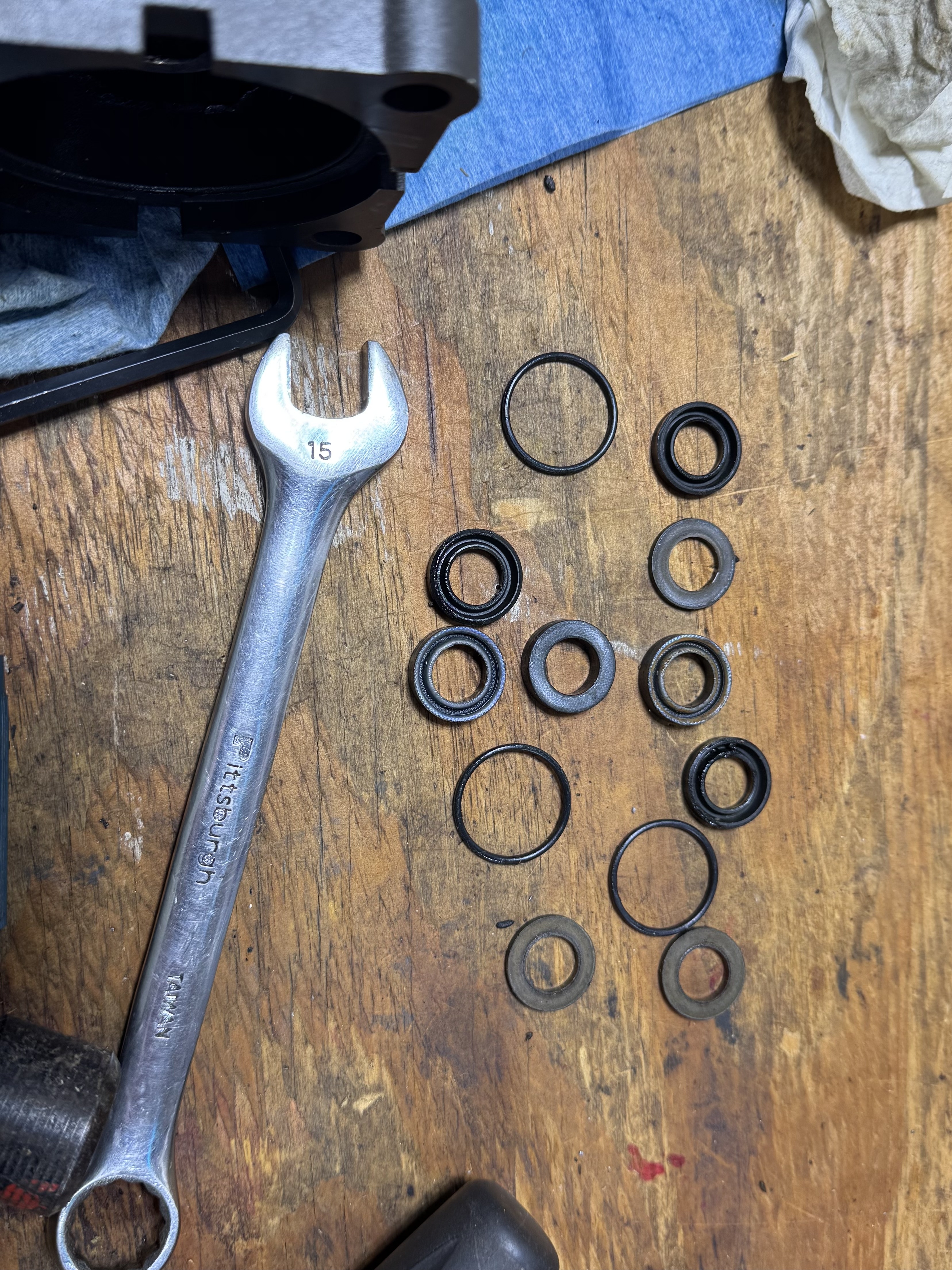

I got a seal kit for it and luckily found a YouTube video where he installed seals in a pump like mine. Took about and hour to do it. A picture of the old seals and the pump mostly put back together.

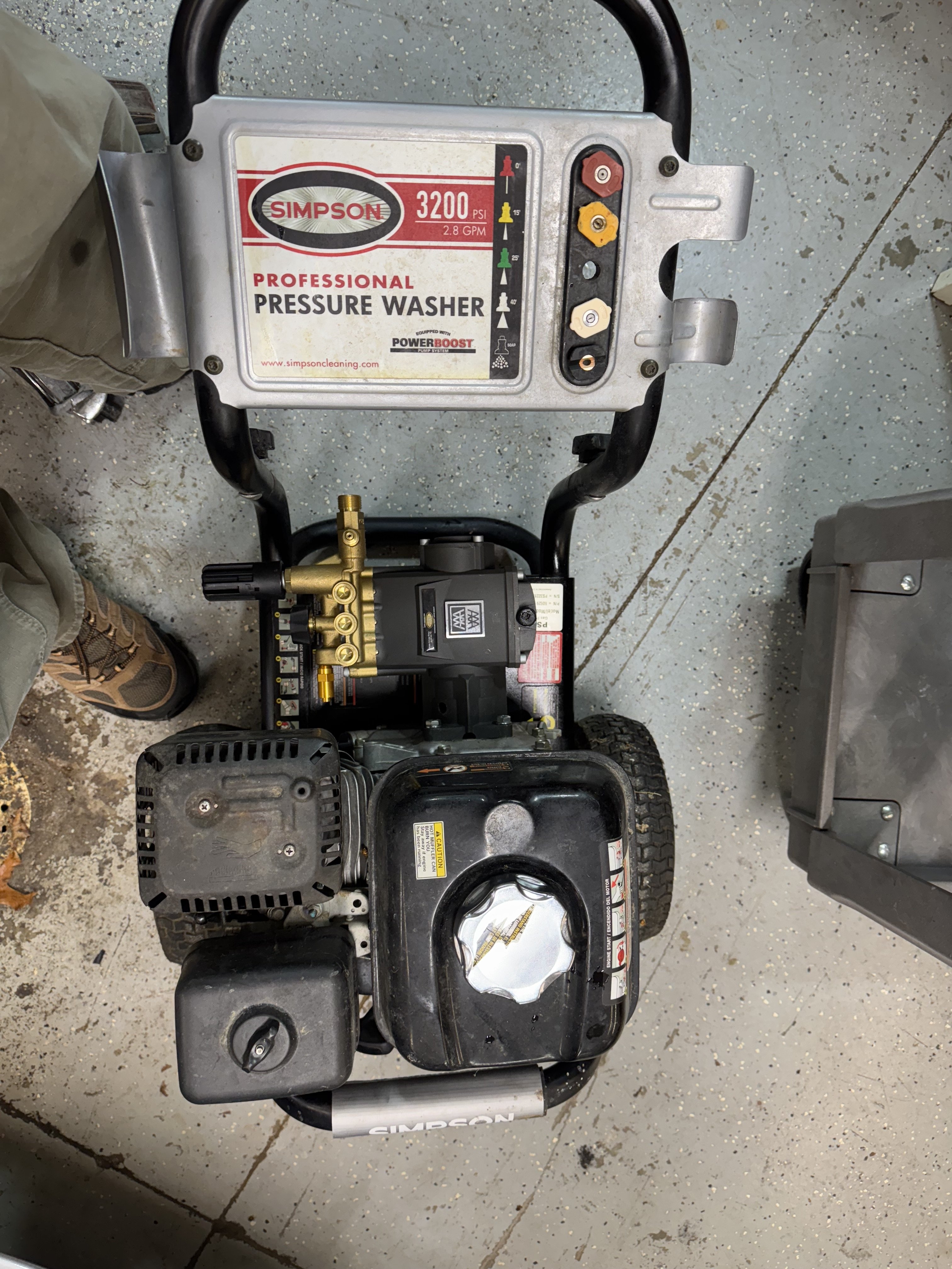

I’m not really disappointed in how long this pressure washer lasted. I’m not sure how old it is but 15 years or more. It was a “better” one at Lowe’s. One thing I couldn’t really find any info on line other than a video on how to fix it.

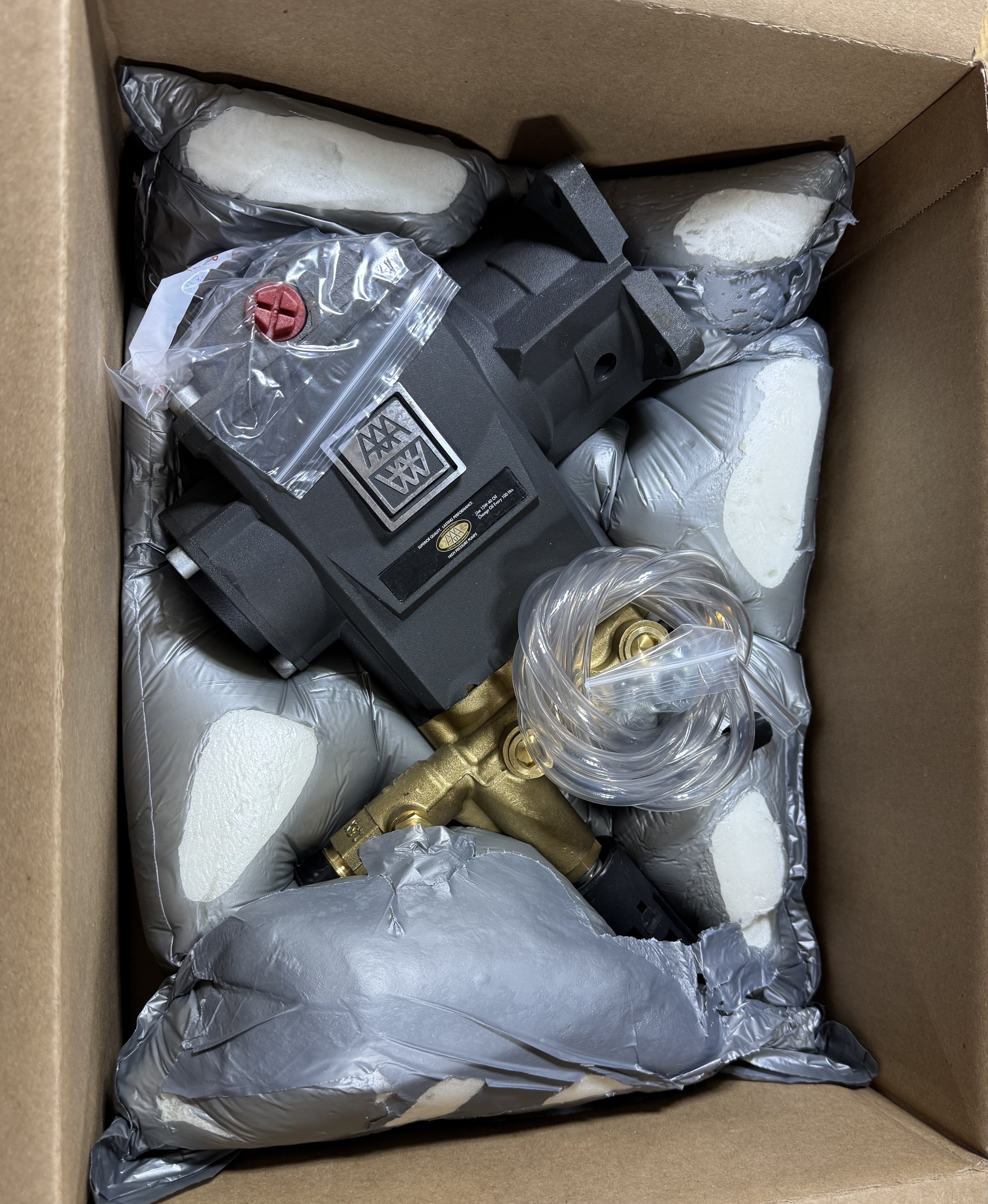

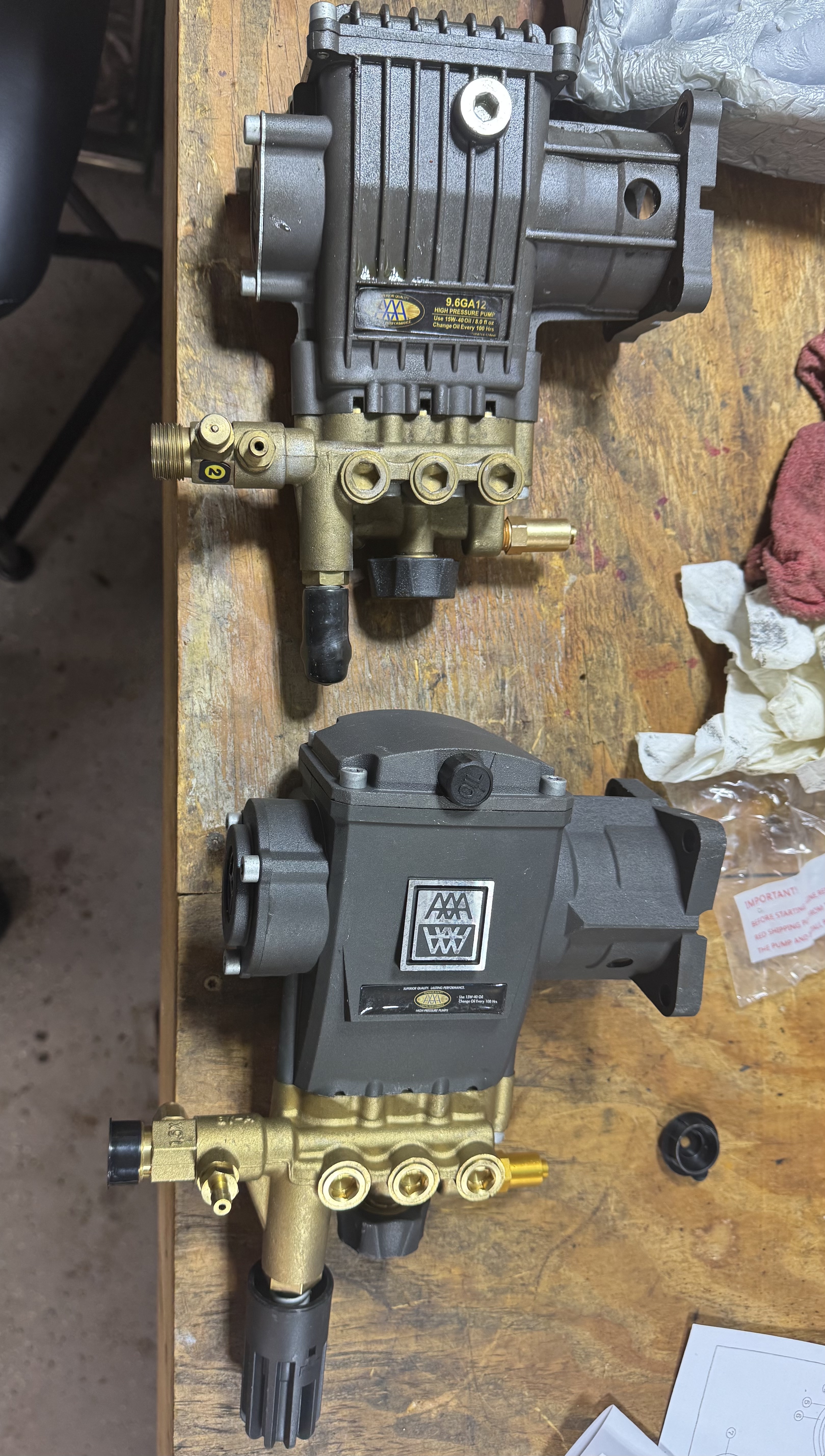

I’ll resurrect this again, I got a new pump last week and installed it today. A little over $300. It’s too cold and snowy to try it but it should be as good as new.

It most likely is the same as when you bought it brand new. Probably half the expense as a new one. They say keep a good stream of clean water supplied to it for best results. And keep the trigger pulled. I seen that on UTube
