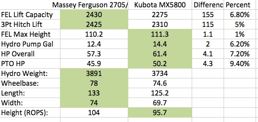

They appear to be very close in specifications from what I see. They both appear to be light for utility tractors, very close to the compact tractors (within 100 lbs.) I have currently. Did you price these tractors with rear hydraulic options and 3rd outlet for mid hydraulics? Also did not see pressure rating for hydraulics or loader specifications, did you research all of this?
I have done a lot of comparison and has lead me to the conclusion of these two. Here is a spreadsheet of some of the details on your questions.
   / Pretty Sure I have Narrowed It down to Two: Massey 2706e or Kubota MX5800 #12
Both of these tractors should be able to physically handle a grapple and trees in your other thread. I would recommend you have at least two rear remotes for later use on the tractor you choose.
I would be interested in how the controls are set up for the third fel function on these tractors. It would be beneficial to have a rocker switch or similar arrangement on the joystick. I would find it very irritating to have to operate a separate lever on the side console if the grapple is 80% of your work. That would be a bigger concern to me than which brand of tractor.
   / Pretty Sure I have Narrowed It down to Two: Massey 2706e or Kubota MX5800 #13
Regarding your stats... Look further into the hydraulics. Massey typically has the best hydraulics. That number you posted for the Massey should be "implement" flow (loader and remotes) while the number you posted for the Kubota I believe is total flow (implement plus power steering) ... The Massey total flow may be closer to 17 total.
Another number to consider is that the Kubota will have slightly higher PTO HP.
BUT in truth, you probably won't notice much, if any, difference, between all of the numbers in real life use.
