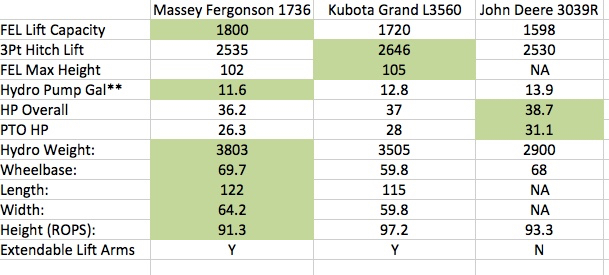

Okay, I couldn't take it anymore LOL ... Looked up the actual Specs for the Hydraulic Flow.
The Kubota L3560 HST Lists: Implement Flow: 8.1 GPM. Steering Flow: 4.7 GPM. Total Flow: 12.8 GPM. 3pt Lift @ 24" = 2,650 lbs
The Deere 3039R HST Lists: Implement Flow: 8.6 GPM. Steering Flow: 5.3 GPM. Total Flow: 13.9 GPM. 3pt Lift @ 24" = 2,200 lbs
The Massey 1736 HST Lists: Implement Flow: 11.6 GPM. Steering Flow: (?)....... Total Flow: (?) ........ 3pt Lift @ 24" = 2535 lbs
The Massey total GPM numbers are not easy to find online for some reason. However, if you have an operators manual, it'll all be in there. For example, my previous 1648 had 11.6 GPM @ the remotes, and 4.9 GPM at the Steering Pump, totaling 16.5 GPM. My 1652 has 12.3 GPM Implement & 5.2 Steering GPM, = 17.5 GPM total. I'm assuming the 1736 is similar to that.

Haha! In the back of my mind I thought it might irritate the tar out of you when I posted that incomplete data. You also now know I could not find all the MF info too. ;-) Sorry for my lazy way (thus the double asterisk), it really is a credit to you as I believe what you have been talking about from the beginning with regard to MF having higher flow. Thank you for the 3pt lift at 24" too.
