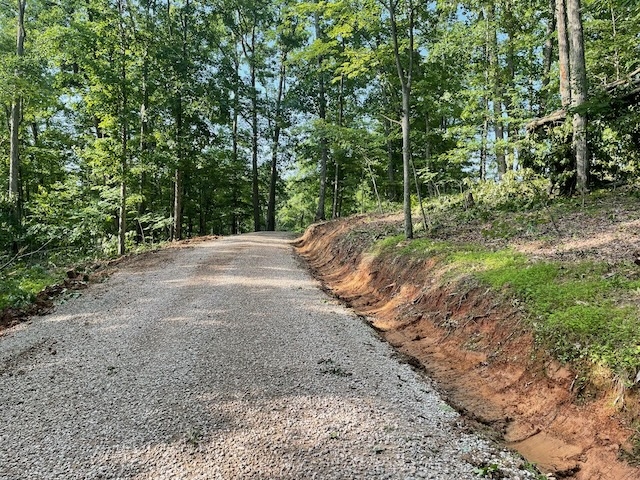

Yes, very easily. I recently did a 1/4 mile of road with our mini and a 36" smooth trenching bucket. It will not take you all that long especially if you can dump it within the swing of the excavator (or in a dump trailer/truck).
Amazing. Just to clarify, bigger excavator is better for this task than smaller? I thought smaller would be enough to create this drainage.
I did install a few drains/pipes to take water under the road and made sure to crown the road to aid in drainage.View attachment 868057
Just beautiful! Wow!
Did you do it for yourself or are you a contractor/professional? This looks like commercial work.
If you did it for yourself, how many hours of experience to get to this level of quality?

Thanks. I just have a mini ex (Kubota KX91 - roughly 7500lbs) machine for home use. I had under 20 hrs on it when I did my first ditching job - they all looked the same but with a lot more hrs on the machine I have gotten a lot faster/smoother. That was done with a 36" smooth bottom bucket. We have a shared private road and I mostly take care of all ditching and road maintenance so I do get plenty of practice on ditching and tree removals. lol
With some time in the machine, you will quickly see it is really easy and a "large" machine is not needed for simple ditching. The problem with larger machines is they do not have room to move to keep things leveled and smooth while doing your ditch. Also, the blade on a mini is not just for pushing dirt, it is great for changing the pitch of the machine/bucket for doing some slope work. If you take your time I think you will be surprised at the results you are able to achieve. Plus always feel free to ask questions, several of us have machines and will be glad to try and help in any way we can.
