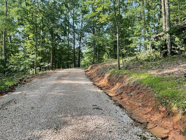

Yes, very easily. I recently did a 1/4 mile of road with our mini and a 36" smooth trenching bucket. It will not take you all that long especially if you can dump it within the swing of the excavator (or in a dump trailer/truck).
Here is another older sample of how I cut a shallow ditch/swell that has worked great for about 2 years now. The hill to the right goes up about 50' and this swell/ditch allows me to control the runoff to the point the road has never received any damage from storms since installed. This is also about ¼- 1/5 of a mile and I was able to do it between lunch and dinner to give you a time reference. (I hit very little rock, however)
I did install a few drains/pipes to take water under the road and made sure to crown the road to aid in drainage.

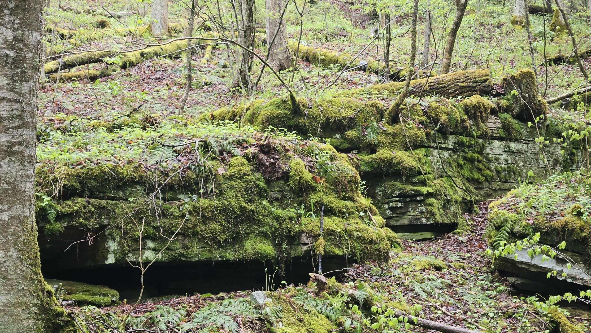

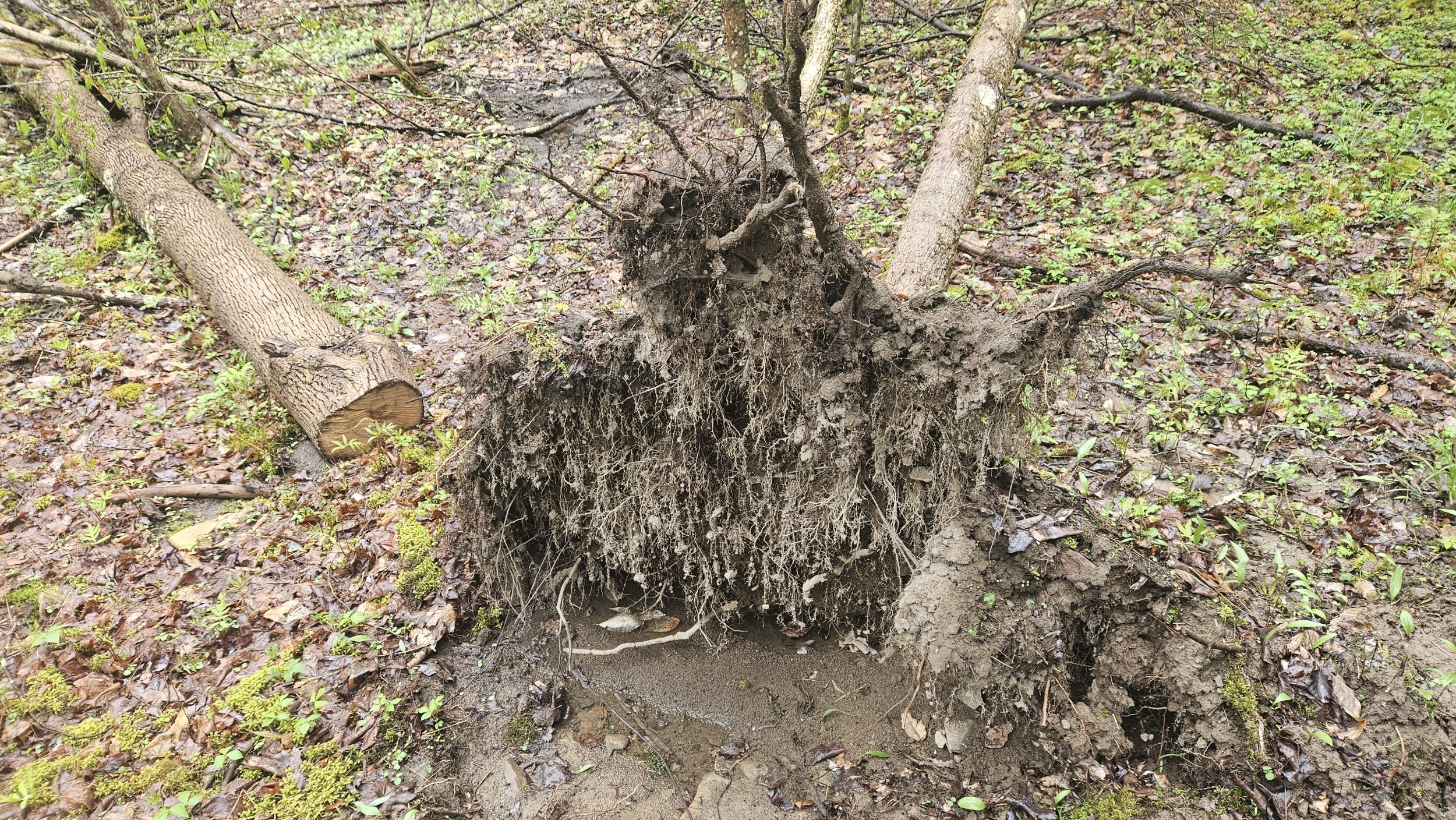

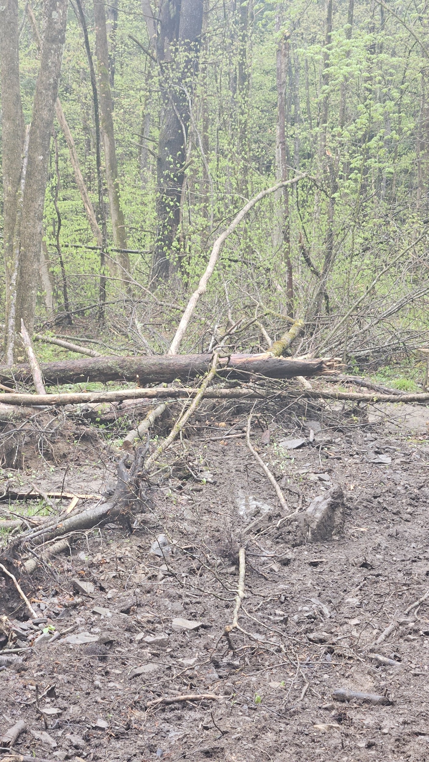

The entire place seems to be infested with rocks. I need to talk to an expert that can explain what type of soil we have up here.
But here is how it looks after the timber sale, when they bulldozed trees around:

And here is how it looks at certain places:
