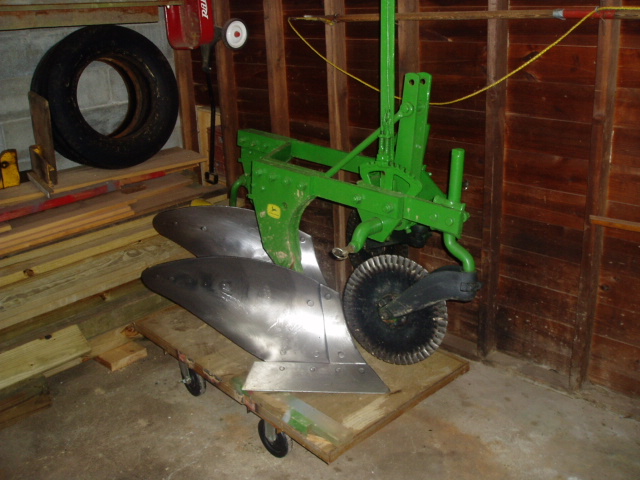

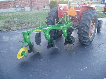

Uhhhh, let's see................... I do?
That's why "small plows" (i.e. under 5-bottom) stayed popular even after high HP farm tractors became the norm. As an example, this area has a lot of small fields connected by PUBLIC roads, Lots of hilly terrain, Odd shaped fields, and mre than the average number of small farms. When plowing was still done on a yearly basis, it was much more practical to use plows that were sorta small for the tractor that was dragging it and go faster with it. And do we ever have clay.
In an earlier post, I was commenting on how plows had a basic frame that could be added to. Here's my Deere 415 in 2 and 3-bottom configurations. This IS a lightweight plow by most standards. It was built to go on the back of Deere 40/420/430 2-bangers. By the way, they're not the best plows in the free world. No clearance. They plug BAD in cornstalks, and don't like sod. Best mounted plows? Ford 101 Close 2nd, Massey Ferguson #66. (They may or may NOT have been the best mounted plows EVER, but they're the best NOW. Parts are available for them. That can't be said for all plows)
Something to ALWAYS keep in mind with any plow. 12" plow/6" to 7" deep. 14" plow/7" to 8" deep. 16" plow/8" to 9" deep. In a perfect world, if EVERYTHING is done by the book, a 3 X 12" plow pulls easier than 2 X 16". It's not a perfect world ;)

Oooh! Nice and shiny! Where's the dirt? It's easy to run at 5mph if you keep the plow in the air! (Um. That's too funny to put a smiley face on that one!)
Nice pics! What is the little yellow wheel in the back? What does it do?
Bob
   / Problems if you get an attachment that's too small for your tractor? #17
Bob
Tailwheel. Also called Rolling Landslide. It takes just a tad bit of pressure off the landslides. They, along with that wheel equalize the force of the moldboard pushing against the soil.
It keeps the plow running straight.
I've bought a LOT of paint in the last couple years.
How do you keep the shares from rusting?
