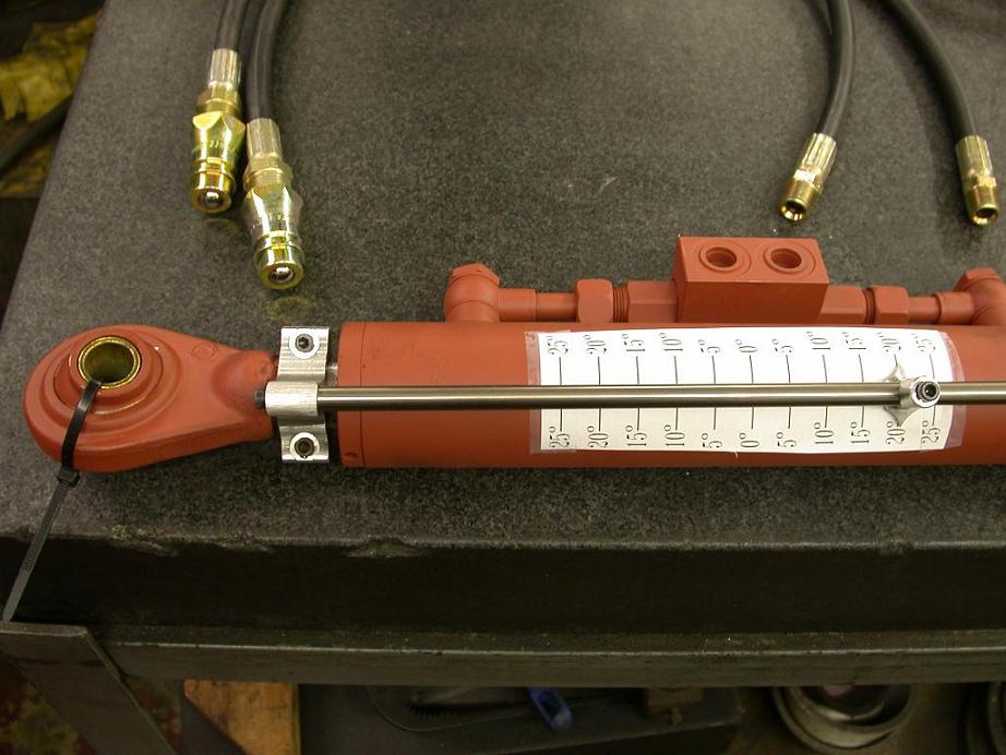

I've used a hydraulic top link for a couple seasons now. Last spring, I plowed a couple old hayfields with a 3-bottom mounted plow, never once moving the top-link after finding that "sweet spot" where it was in proper adjustment. The top link is equipped with pilot operated check valve. That keeps it where you put it. The hydraulic top link works like a charm. Bigger mounted plows (3 bottom and bigger) are sensative to top-link adjustment. A turn or two can get the back bottom in too deep or out of the ground while the front bottom is exactly where it needs to be. The hydraulic top link lets you get that spot on while never leaving the seat.
Like so many things, a hydraulic top link is a great item to have IF it's done right. Without the pilot operated check valve, it would tend to drift. With it? Not a hint of unwanted movement.

Is this check valve something that comes standard w/ all hydraulic toplinks or do you have to specifically ask for it? What exactly is it?
   / Problems mounting 2 bottom plow... #35
Investorguy,
Off the shelf hydraulic cylinders generally do not come with check valves. You'd have to buy and install them. I bought mine from CCM and his comes with the check valves. That's the ONLY way to get one. (with the check valves, that is)
Here's a picture of mine. I made that level gauge for it.
