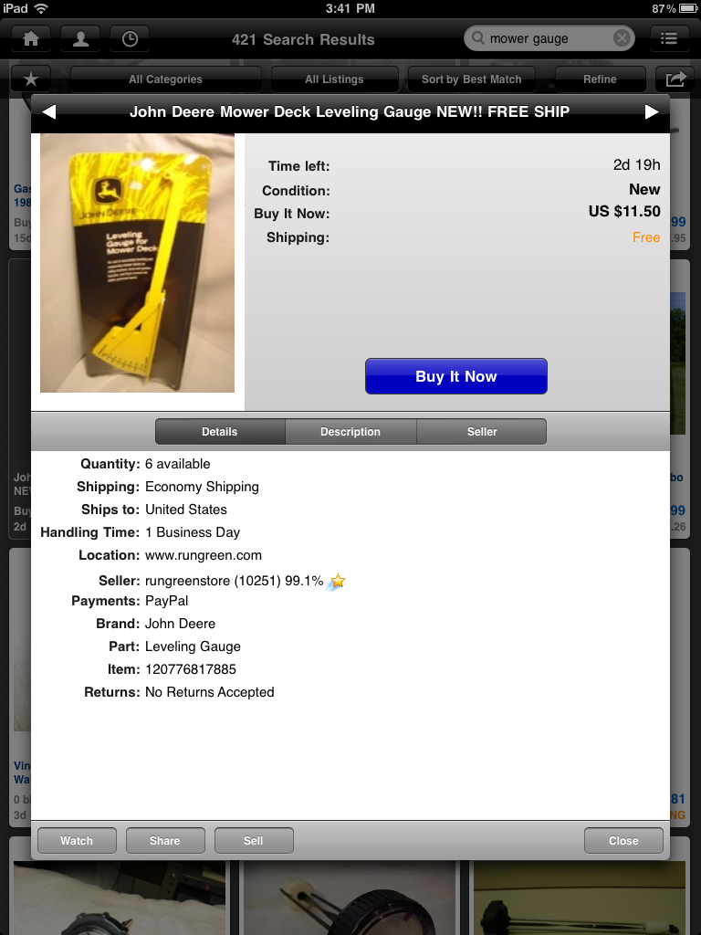

You really need to have someplace to measure that the entire tractor fits on. The deck is a floating deck not ground contact so the tractor tires make a big difference in the measurements. Also there is a gauge available from John Deere for less than $20 that is great for this task. The measurements should be done at cutting height also. The blades being level front to back will definitely leave a poor quality cut.
Next time im handy a deere dealer ill pick one up. As i mentioned earlier i dont really have a good reference surface to measure off right now. I basically took quick and dirty measurements to see if something was REALLY off.

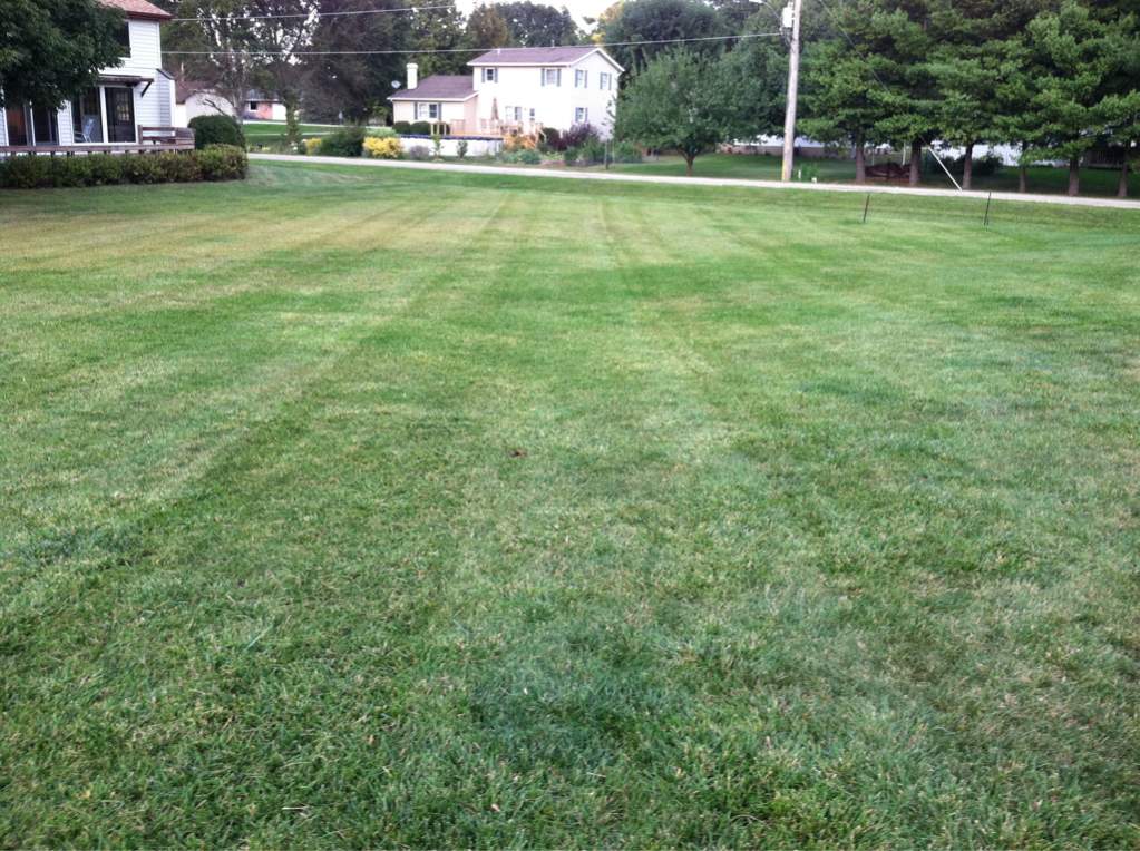

I experience this problem on my BX with the 60 deck, standard blades, no mulching kit. I think your guide wheels need to go down 1 or 2 notches so only 1 or 1.5 holes are protruding up. I mow at the 3.1 and 3.2 setting, which can get the grasss pretty short, and at full throttle like manual says.
I think what is happening is the part of the grass that isnt cutting (or looks like it isnt) is actually in a dip, lower than the surround grass. What I do in this situation, because my yard has a lot of them, is mow parallel to that "strip" and use the left or right side of the deck (depending if its on aa hill or not, and left it "hang". This always works for me and cuts the grass that is growing on ground that is lower than surrounding areas. Overall Im impressed with the cut of the 60". I used to have a JD 345 with the 54" deck, and yes, it did mow better, but that was really a dedicated mower. The kubota cut isnt as good, but the difference is so minimal for all the benefits of the BX its fine for me.

I have a BX2660 with the 60 inch deck, no mulch kit and terminator blades. I have my deck 1/4 in lower in the from and I set my deck wheels so the front just barely touches the ground and the backs roll with the resistance of the grass. I have found this gives the best quality cut for me. I mowed tonight at a pretty high rate of speed and I think it turned out pretty good.
