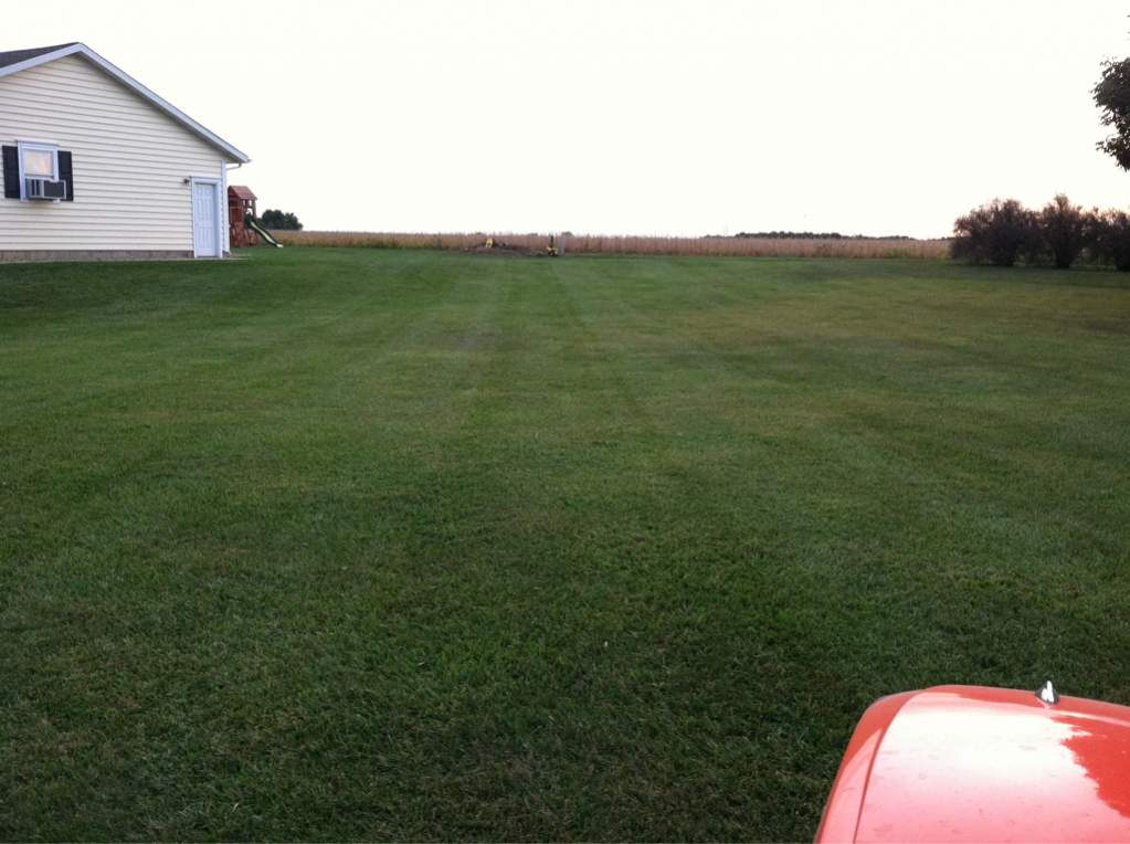

I have a BX2660 with the 60 inch deck, no mulch kit and terminator blades. I have my deck 1/4 in lower in the from and I set my deck wheels so the front just barely touches the ground and the backs roll with the resistance of the grass. I have found this gives the best quality cut for me. I mowed tonight at a pretty high rate of speed and I think it turned out pretty good.
Good looking cut. Id be happy with that amount of rutting. Nice and flat otherwise. What was your cut height?

I was cutting at 2 3/4. I also have the R4 industrial tires. The mulch kit might be causing a little trouble but I think leveling will do the most. When you lower your deck and set your gauge wheels, park in a flat area and see how even the deck wheels are to the ground. The fronts should be just a little closer to the ground or touching than the backs are. You might try loosening the front hanger bolts a little (evenly) until you can see that the front deck wheels are slightly lower than the back. That should help.

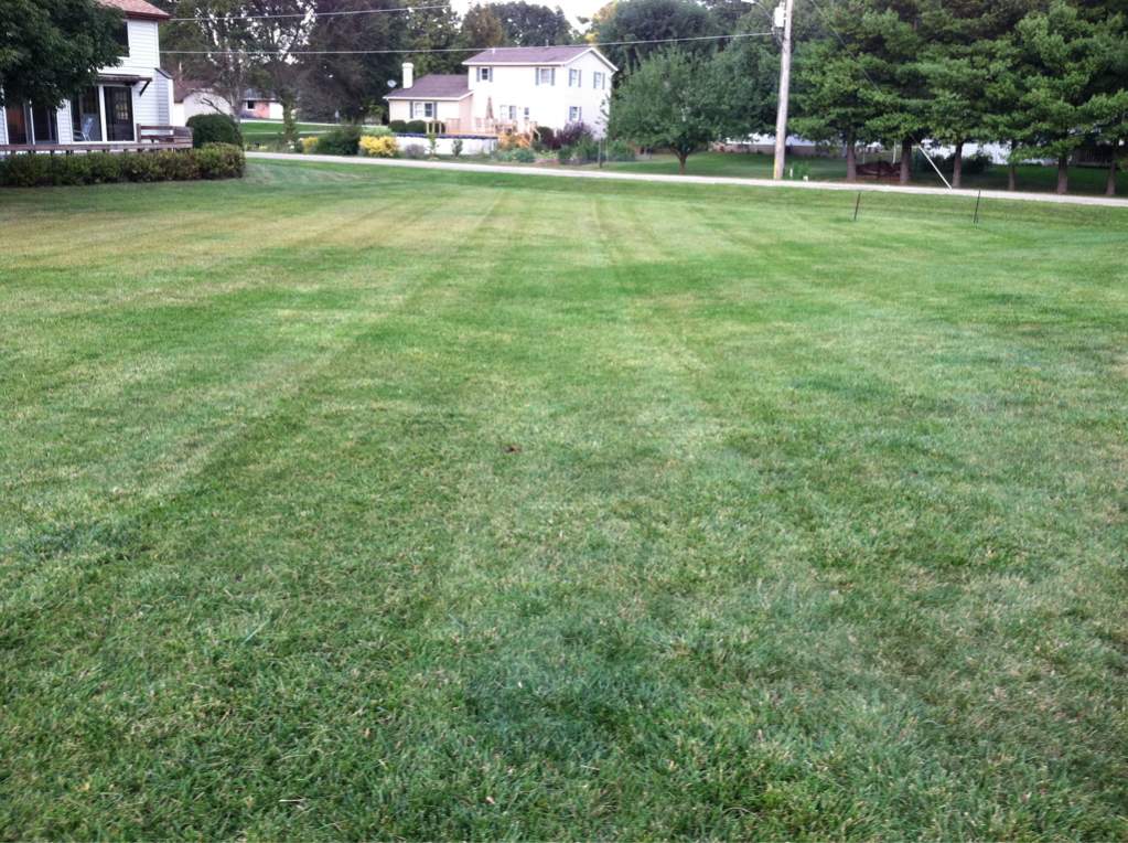

I have my guide wheels set about the way Coldmaxx does and have good results. Today I mowed, grass was about 4-5", I set the mower at 3"....
This is a different area, grass a bit longer, mower set at 3 1/2"...
All mowing done in high range @2800 rpm.
Might want the sharpen blades, mow differently and add some fert...brown.
