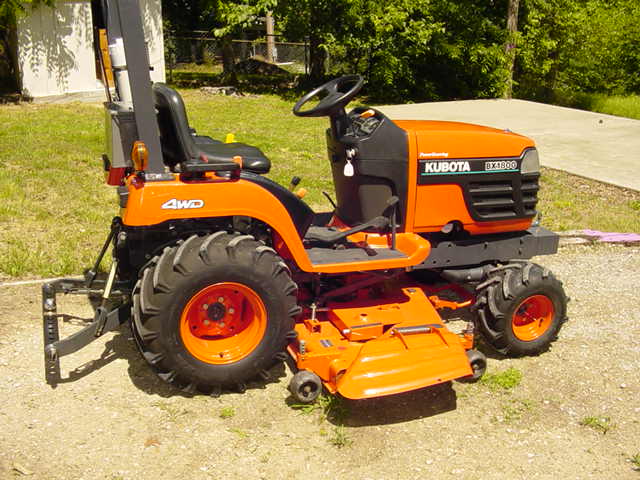

I've just got a bx1800 with the 60" deck and I'll admit, that it is a pain in the butt to do all the book says to get it right. I think this tractor had this deck added to it, because everything on the adjustments is outta whack.
I am taking the advice here, an getting the JD mower gauge at $7.38 tax included at my local JD Dlr. Its just to hard to do otherwise.
On another note, I mow our RC plane field, an I have found that with the deck chute up an hooked back, the grass will blow out farther an in a wider area than with it down.
Even when the grass is wet, it will ball up with the chute down, but still blow out good with the chute up.
I just drilled a small 1/4" hole in the end of the chute an use a bungie cord to hook it to the stop bolt for the HST pedal when I want to have it up.

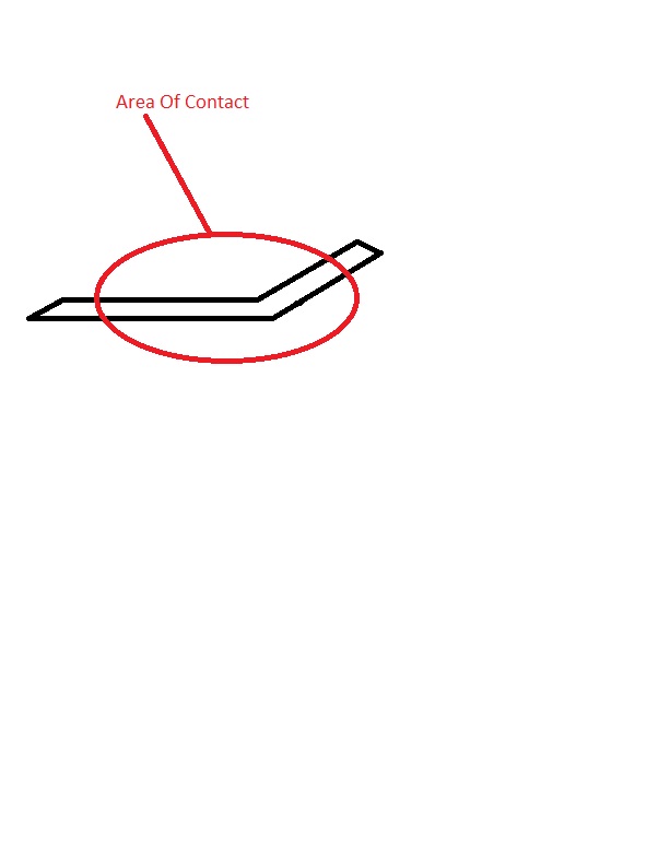

The install DID NOT go without a hitch! The right hand and centre blades were making slight contact, but only with 1/2 of the blade. I didnt notice this until the deck was installed and even then, not until the blade was up to max speed. I tried it manually and at low RPMs with no contact. AS you can imagine it made quite a racket!
Had to remove the deck and inspect.
The two blades are only making contact in the wing area, and then only in one specific position.
I had to grind the facing edges of the right and middle blade to get clearance. Thankfully, i didnt have to modify the cutting edge. I did have to re-balance the blades as I probably removed close to 3/32" to get enough clearance.
If anyone installs the Gator blades, you MUST install them as a test first. Slightly loosen the centre bolt on each blade so you can rotate them easily without moving the remaining blades. Im not sure what the exact cause of my issue is, but I suspect it's Oregon's Quality control. Both the centre and the RH blade were out the same amount. I suspect the centre hole is broached slightly to one side, I did not take time to confirm it however.
I should also point out that the sharpening job from the factory was pitiful. It was neither sharp nor straight and there were large gouges cut in the bevel of the blade like too course of a machine cutting tool was used in the factory to form the bevel. I had to sharpen them before installing.
Hope to try them out in the next few days. Will post up when I do.

yeah. id say the gators are significantly heavier. They are 3" wide vs the factory 2.5.
I should say that after modifying the areas of where the blades were hitting, there is no longer any contact.
