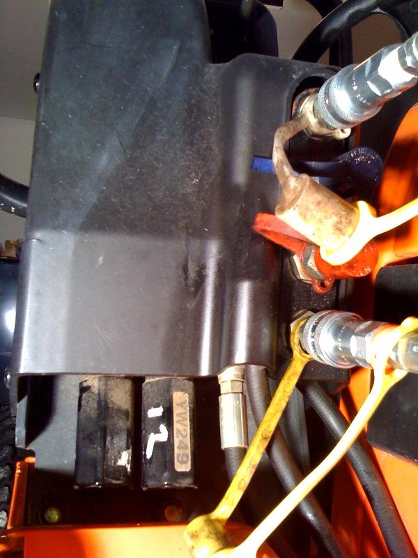

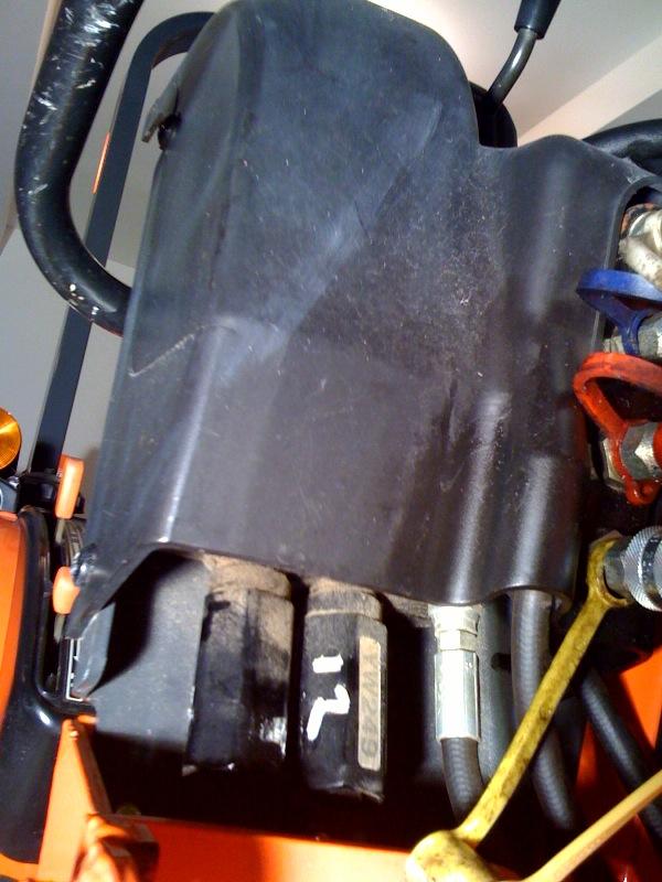

Here are 2 pictures of what I assume are the parts I need to make a hole in to drain any moisture and take off and open to make sure there is no rust or broken parts ... I just cannot seem to unscrew them from the machine...
And by "here are the pictures" I mean the 2 black hex shaped cylinders, one with tool marks on it (me trying to get it off the machine) and the other has a "12" on it...

I'm not sure what the 2 black hex "dodadas" are - take the plastic cover off and then do a photo.
As Kennyd says they should be held on with two cap screws or two philips screws - like a little cover.

Okay, there are just 4 small screws that hold the plastic cap on to cover the valve etc up. I plan on taking that off when I get time, just did not get time last night. I will see if I can figure it all out tonight and post pictures if I need to.
