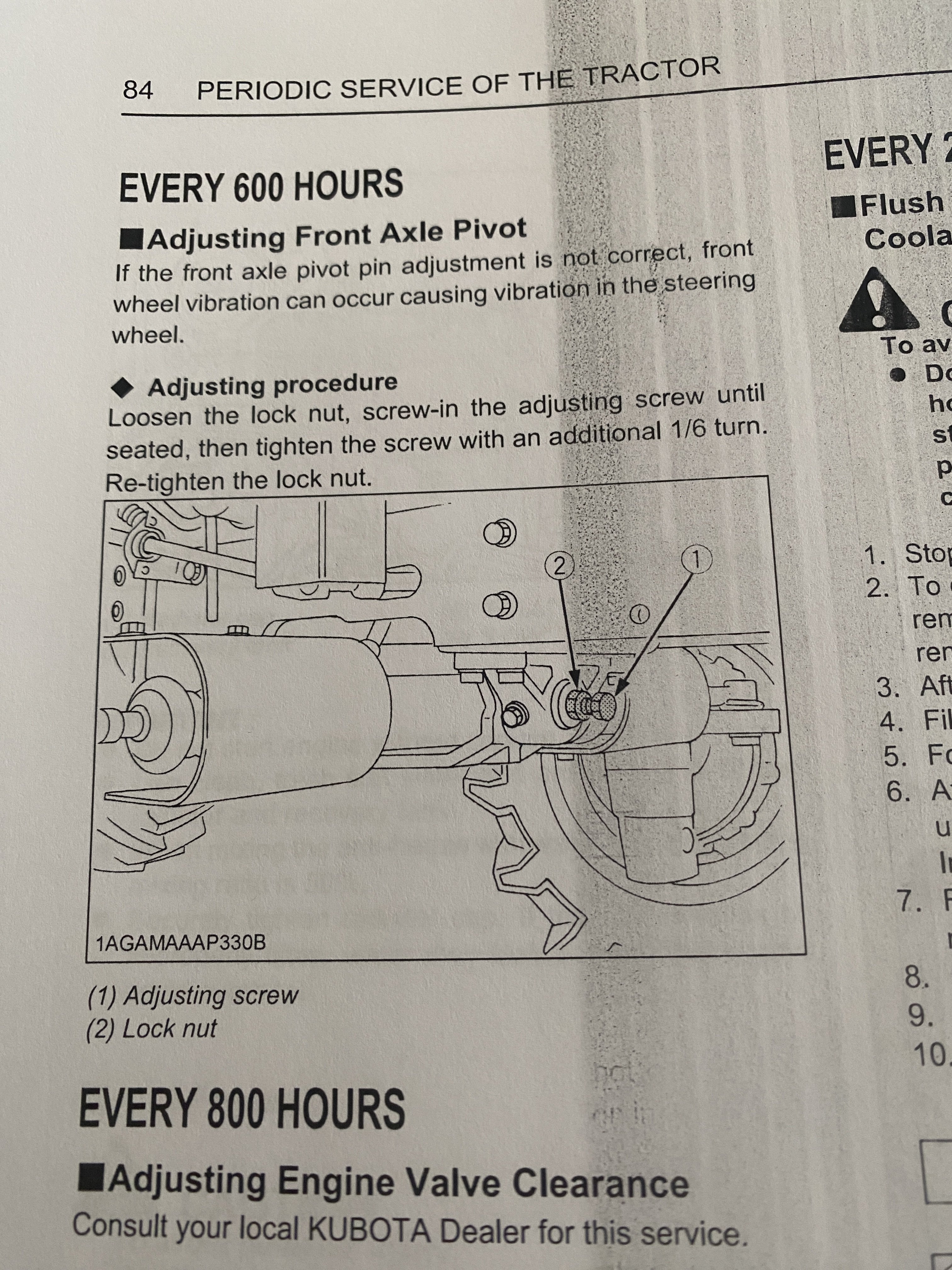

/ Steering Wheel Vibration #15
#16
Check the front axle pivot pin adjustment, it can cause steering wheel vibrations.
A good thing to check but that's not likely the problem. Vibrated since it was new, along with all the Kubota tractors I've owned. It's me, not the machine. It wasn't an issue in my younger years.
I'm glad you mentioned that adjustment. I've adjusted that that pivot pin on our Kubota several times now and was surprised how much it wear it had. Adjusting it made a big difference in front end feel & bounce over bumps.
Our steering wheel doesn't vibrate, so can't speak to that.
