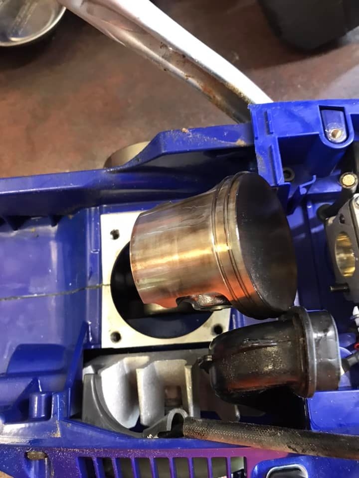

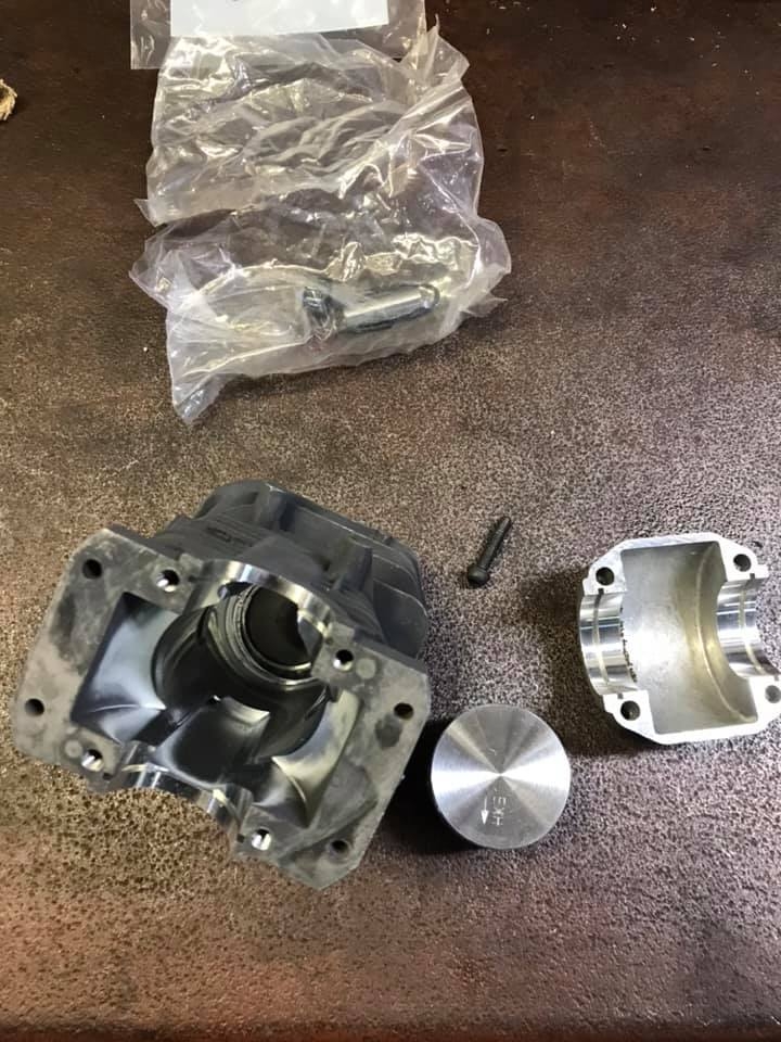

Still can rebuild both the plastic cased and the better mag cased saws. It's just if you only need to do a piston change on mag cased just pop the cylinder and remove piston.
Plastic cased saws most times (unless efco and some other small saws) you have a clamshell and will be removing crank etc etc to just do a easy job.
First mag case easy piston swap.
New clammy shown without crank, bearings, seals etc.
