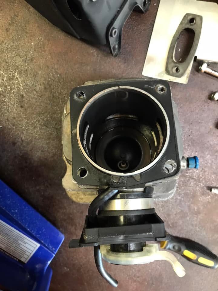

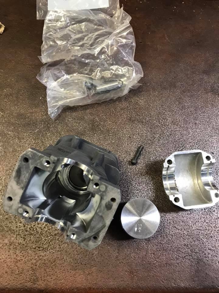

I also own a MS250 and MS 261. I burned up the 250 so I bought the 261. I rebuilt the 250 for about $100 and I remember taking both out, I was cutting pretty good sized oak into rounds for firewood. I used the 250 first and it was running good and cutting well. I thought I’m such a fool for spending money on the 261, the 250 is just as good as the 261. Then I picked up the 261 and thought “oh yeah, this is what a saw should be”. For what is about the same weight the 261 makes 4hp vs 3hp for the 250.
Lighter weight and more power is what shows up in the pro saws. I agree with what others said about upgraded components. One I notice between the two is the air filters. The 250 is kind of chintzy and the 261 much larger and better. Bigger fuel and oil tank, bar nuts that don’t fall off when loosened (captive), less plastic and a bunch of little things that add up.
