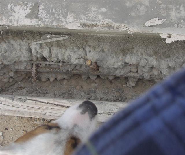

I knew the job was sloppy from the quality of the finish, but why was the stregth so low? Did they say? Those numbers really suprised me. Especially since they seem to cover various areas. I expected there to be pockets that would be bad, but that sounds like the entire slab is bad.
Too bad you could juse get rid of this guy and start fresh, but with him paying for the new pour, and you making sure he does it right this time, maybe he'll do a better job.

Yikes - 1700 PSI concrete is hardly concrete, more like grout/mortar. Certainly would not carry much load w/o spalling & cracking. You're doing good to get it torn out & replaced. J bolts can easliy be installed prior to pouring concrete if the carpenters take some time to build a template w/holes matched to the colum baseplate holes. This is usually done w/2x4's and plywood. If the contractor does not have the skills to do this, and or you don't have access to shop drawings for the column baseplates going w/epoxy is the 2nd best solution. Just don't use the hardware store 5 minute variety of epoxy. Go to someplace like Granger or Fastenal (no plugs just places I use) & buy the real thing from Hilti (again no plug just what I've used before). Make sure you use real anchor bolts not cheap grade 2 hardware store stuff & drill the holes in the concrete the correct size as recommended by Hilti (or who ever you use as an epoxy supplier). They MUST blow the holes out after drilling or the dust will prevent the epoxy from bonding to the concrete. Leave enough bolt thread sticking up to get a washer & 2 nuts on & you'll never have to worry about anything getting loose.
The above from over 25 yrs in heavy industrial construction. Might be overkill for your building but done right is done once!
/ project update... If only!!!! Long #43
When the contractor saw how weak the concrete was, they probably didn't complain much about having to rip out the bad slab- it probably crumbled into chunks relatively easy...

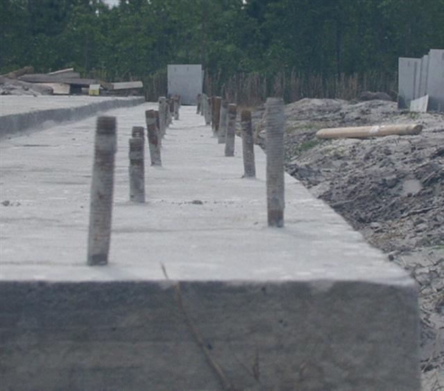

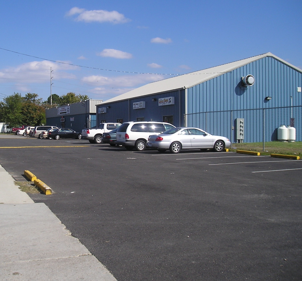

Glad to see things are working out for you. Adding the J-bolts afterwards is the best way to go. When we do foundations at the machine shop we build pockets and attach them to our forms (a lot of work)and pour the concrete around the pockets where the bolts are suppose to go. This way, after the concrete is cured they have plenty of room to postition the bolts where they want to make sure the machine is where they want it. The way this guy did things made me laugh. Hopefully, having inspectors on site this time around will force him to do a good job and hopefully he will bring in someone that knows a little something about concrete.
I posted a thread about the last foundation we did there and you can see the pics in the thread http://www.tractorbynet.com/forums/projects/12062-new-foundation.html For the type of foundation you are doing it wouldn't work out too well but who knows it might help someone in the future.

The strength was low because of the water that was added. The water was what started this whole thing. I "found" tickets for the concrete in the field that showed the added water amounts. Which lead me to ask for all the tickets and that's when I found I had 38 yards of concrete and 360+ gallons of water and considering that the concrete company will only stand by 10 gallons per load which would have been less than 40 in my case means too much water. This was added directly to the truck which compromised all of the concrete not just some of it.

Hardly concrete, just what I thought. It's got what I call spider cracks but no true cracks but there is no weight on the slab either. As for the J-Bolts they typically should be easy to place. You may not have seen the earlier pics, maybe take a look they should still be there. here are approx. 130 bolts for the building and he originally had made the plywood template and lined them up (3 times) then when they poured smething came over him and he removed the template and the bolts and reinserted incorrectly. Only a few actually line up. And yes the baseplates where onsite the day of and before he poured. You mention column base plates, JSYK it's a "quonset" or round as I call it. Not your standard metal bldg. Thus having many more areas for potential problems.

He didn't complain much. I can't say he was eagar to rip it out either. After I had it tested he had another testing company test the footers, can I say his friend works there. The results were much better than the ones I got but he said that he would do whatever it took to make us happy. So far he is attempting it.
Yes it did come out in rather small pieces, although there were a couple larger chunks but we had a ton of rebar in the slab.

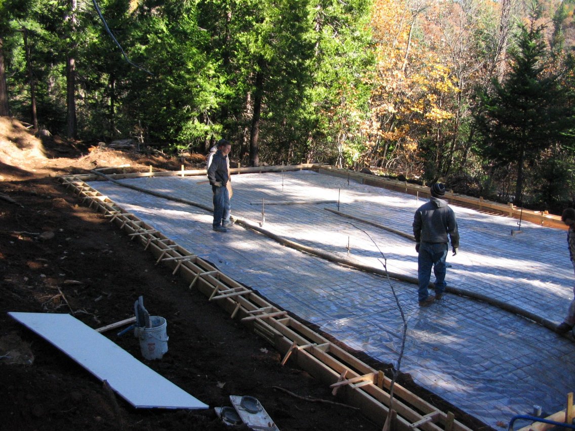

The slab has been repoured, the footers were done last Friday and the slab was done last Tuesday. The contractor himself won't come out, he sent his crew to do the work. Was hoping he'd atleast want to make sure it was done right or be here to solve any issues. We did not have him install the bolts, we will do that when we install the building. I'll post new pics in the next day or 2. He has not / will not cut it. I'm trying to get my neighbor to do it this weekend, his dad is a concrete guy. I know, should have hired him but we all know about hind-sight.
Day 1
In light of the past I hired a testing company to monitor this past pour. It was the same testing company that did the core tests on the first slab. The day before the pour he called me up telling me he wasn't going to pour because he didn't have the money for the concrete, wanted me to pay for it again. I told him to pour when he got the money. I had the testing company on hold pending further notice. The next morning, the day of the pour, I called the concrete company who informed me he was coming to pay and they would be out soon. So I called the testing company and told them to come on out. This was no surprise because he wasn't thrilled with the testing company coming out. When he got here I was talking to him about the slab and showed him a few minor things that needed to be fixed. He reluctantly fixed them. He informed me it would be a flat pour with no recess. I told him it just needed to be as the prints say. He then called his guys and told them not to come out and he left, in a hurry might I add. From the attitude I was sure he was not coming back. He was obviously not happy. I told the testing guy that he could guy and a few minutes later I called his office. As I was speaking with the lady she told me that they were all coming back to the property to continue. I'm just shaking my head and thinking this is not going good at all.
So did I say earlier that Steve (the testing guy) arrived at 9:00 am. Yes, the day started @ 9 am and the concrete got here @ 3:30 pm. By the time the concrete arrived the contractor had left for a second and final time. He was no where to be found. The concrete arrives and the the concrete guys didn't realize that it was getting tested and they weren't happy when they were told they could not add water, none was to be added. The first truck was sent away with 1+ yds left as it had taken too long to get out. The second truck which was only four yds arrived with a slightly higher slump but Steve allowed it because it was late and it would have left us with a cold joint in the footers. He made cylinders of all the trucks.
I had learned over the weekend that there was no fiber in the footers, which there was suppose to be. Not by design of the prints but because I paid for it before and if I had it then I wanted it now. So Monday I called the concrete company to let them know if it doesn't have fiber it will be sent back. I also let the contractor know how I felt. He agreed and it did arrive with fiber.
Day 2
Steve arrives at 7 am and the concrete shows up @ 7:30 am . They were allowed to add 13 gallons of water to the first truck but it came out at a 3" slump, the second truck was not allowed any water as it was at a 5". When the 2nd truck emptied the were short about 6+ yrds. The contractor was not here and once we were able to get ahold of him he very reluctantly went and paid for another 7 yds. (cash only account). The last truck came out at just over a 3" so he allowed 10 gallons of water. He made cylinders for all the trucks for later testing. The pour was done by 11:00am. They spent a little too much time finishing it and it's not as flat as it was before but atleast it's integrity is not compromised. Except for cutting it. I guess all in all it's a much better slab.
