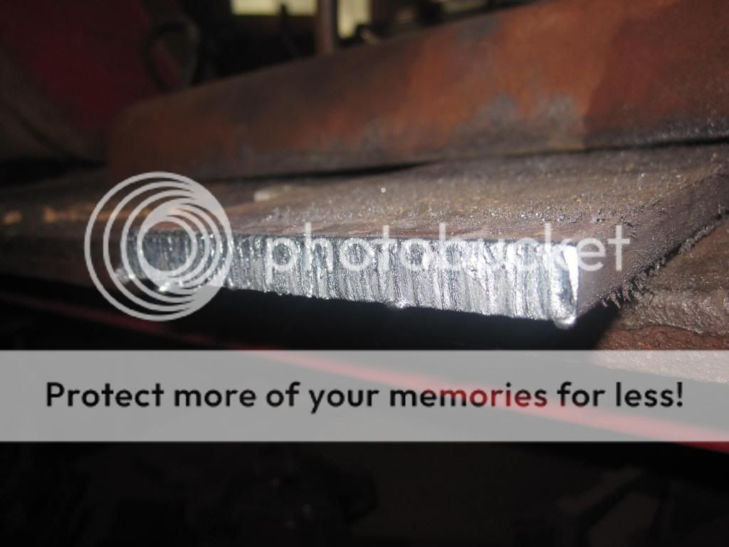

Just got through converting from acetylene to propane after finding out that my LWS has raised the cost of size B from $55 to $85:eek: as a result of the explosion of the plant which provided 80% of the carbide in North America.

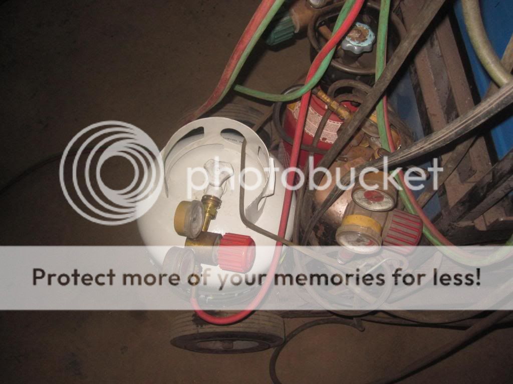

Cost was $8, only because Air Liquide uses a unique fitting that had to be changed and $20 for a new propane torch tip. I had a second regulator for the propane tank
Everybody said, dont do it. Its slow. Not as hot. doesnt make clean cuts.. on and on. This isnt the case in practice. It may be a slight bit slower coming up to cutting temperature, but during the actual cutting, its as fast as ace, plus you can (should) keep the torch higher which means better visibility. There is a reason that many old school burning tables run oxy propane, good cut and cheaper. It cuts fine, dare I say as well as or better than acetylene, for 1/5 the cost. Plus fuel is as close as the nearest BBQ :)
Fits on the cart, with the other gases.

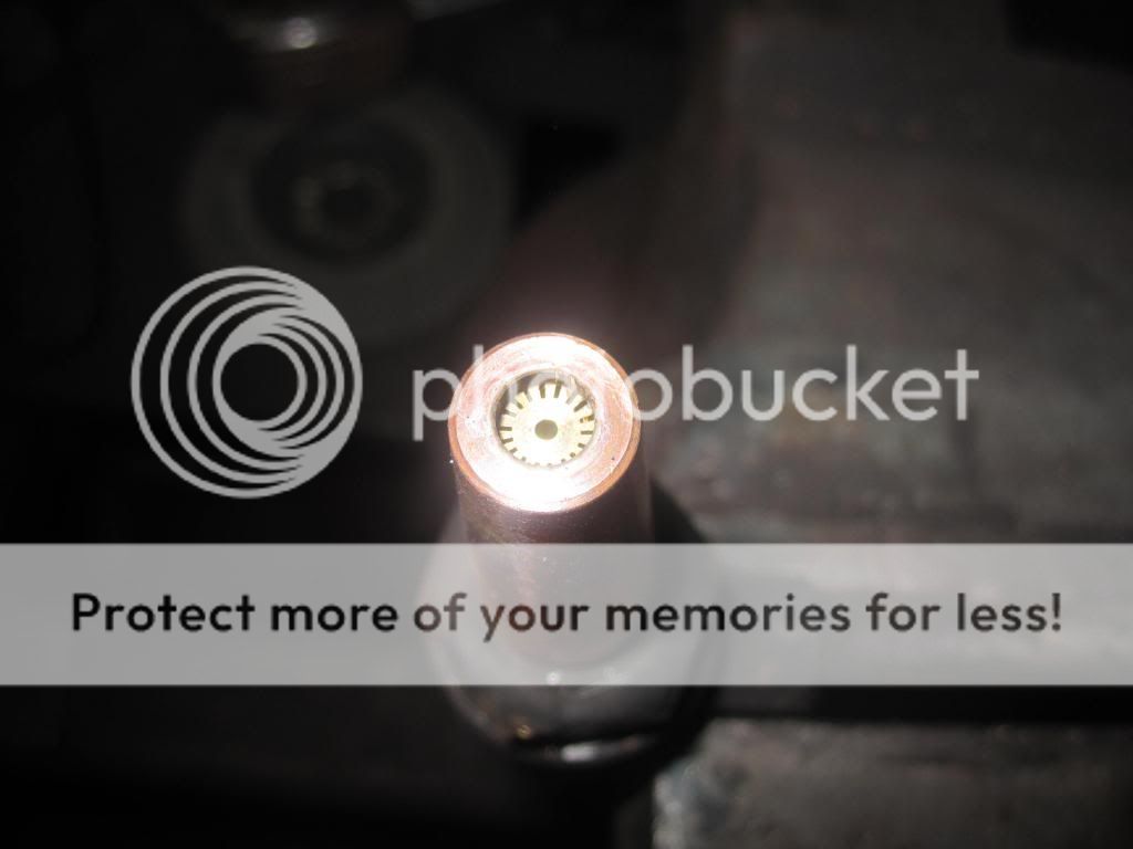

youll need a proper propane two piece tip, which is different than an acetylene tip

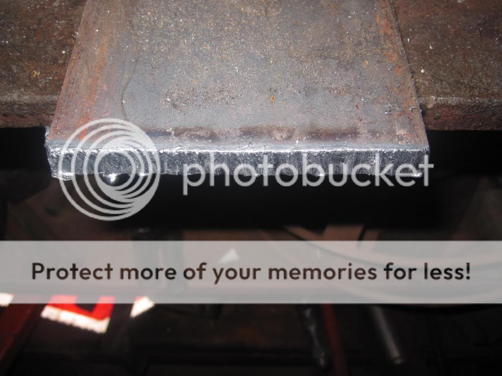

A cut as good as anything, in 3/8" flatbar
For you guys still running acetylene, make the switch! Acetylene is only going to get more expensive

Keep your tip about the same height as an acetylene tip. Propane spreads the heat out more. You might have been using a slightly big tip for that cut. The top edge is rounded from getting too hot or going too slow. Another trick is to angle the torch in the direction of the cut if the tip is a little too big. Burning tables use propane and natural gas because they are usually going through a lot of gas and with a motor controlled torch, speed can adjusted just right and it runs very smooth. On thicker plate propane has an advantage because the heat spreads out more and helps preheat a little more in front of the cut. Forgetting cost, I can do the nicest cuts with acetylene. It's easier to see what you're doing because the tips are smaller in diameter.

Tip was a #1. Up to 1/2". Only propane tip on the shelf other than a #3 . Travel speed was OK IMHO. Had a slight tilt in direction of cut. Couldnt go much faster or Id get ahead of my heat. May have had a bit too much propane pressure (12psi). Heat does spread out more for sure vs ace. Takes longer to get the preheat in there, but it seams to heat up more of the steel. Ill get it dialed in. What Ive read on tip height was to keep the tip higher due to the fact that propane's hottest flame is at the tip not in the inner cone like acetylene.
Overall im very impressed.

So can you use a standard ace regulator, with that adapter? I have an extra regulator, do you have a part number for the adapter? My supplier wanted to sell me a complete new propane torch set when I asked about converting over. Thanks

There are also 1 piece propane tips that offer a little tighter flame. The regulators are the same CGA and will interchange just fine. The only difference is the Acetylene regs have the 15# red line. For the most part you wont go over 15# anyway ( unless you hook up a large Rose Bud ) and the cutting pressures are very close to the same as Acetylene. Now days they try to get you to buy Grade T hose that will outlast the regular rubber hose 3 to one. They did however use the regular hose for the past 100 years and they got by. MAPP isn't the same as Propylene. MAPP has some Acetylene in it and Propylene does not and it is a synthetic. The old MAPP was better than the new version that they recently started making again. All in all if you don't torch weld, Acetylene is not needed and the savings of an Alternate fuel is 5x over the cost of Acetylene. Not much chance of a flash back and you can open both knobs and light the torch if it's windy. Here is the kicker, I remember converting Fab shops, Farms, Factories etc over to an alternate fuel and all was well. I would go back a year later and they were using Acetylene again. I would ask why and they would say, " I don't know "..Everyone loves Acetylene and that also contributes to it's cost. I use both. It's hard to dial propane down for soldering and brazing and I get into some small touchy repais and only acetylene will work. Try an alternate fuel for cutting and decide for yourself. Lastly, Look it up and you will see that Propane has more BTU's than Acetylene. good luck.
