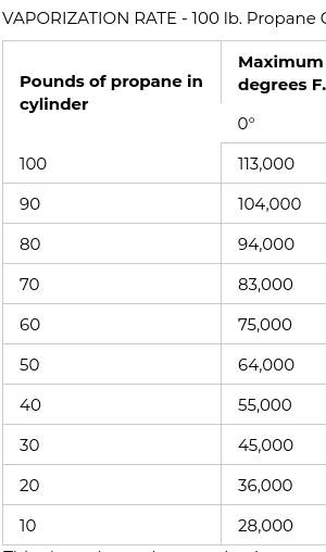

First, the size of tank has nothing to do with the internal pressure of the tank. The pressure is solely dependent on the ambient temperature and can be upwards of 200 psi. The pressure is controlled by a regulator and depending on the distances involved there may be more than one regulator. In my case the regulator at the tank steps it down to 10 psi (which is considered hi pressure - for propane) at the house is further stepped down to an 11 inch water column (somewhere around 1/2 psi) The size of distribution pipe matters as well on providing enough gas to meet the BTU requirements.
You will need to add up all your gas appliances to get a total BTU count - this is an important number! You will also need to know the coldest temperature you expect to see. You can then use the tank size you want to use with the ambient temperature to see if it will vaporize enough gas to meet that total BTU count. (Propane gas is in the form of a liquid in the tank with the propane gas above the liquid.)
Vaporization rate
There are charts for the different tanks. Vaporization depends on the surface area and temperature of the liquid propane, so a horizontal tank will have it's highest rate when half full because it has the greatest surface area at that point.

a 100 gallon tank at 20' F and at 40% capacity will vaporize up to 235,000 btu/hour. A 100 lb tank has about 22 gallons in it and will vaporize about 79,000 btu when full but much less as the liquid level decreases. Owning your own tank means you can shop it when you need it. You can manifold 100 lb cylinders just like 100 gallon tanks and use the same regulators and POL fittings. If your tanks are next to the house but away from any windows below the top of the tank you probably have a twin stage regulator which takes it from tank pressure to 10psi then to 11-14" WC. Swapping out 100LB cylinders when they are empty and then transporting them to be filled and then reconnecting them is risky. By code a leak check has to be done and documented every time a tank is swapped out or run dry. Not far from here a blacksmith swapped out his own tank there was a fire and his insurance company still hasn't paid out on his claim.
