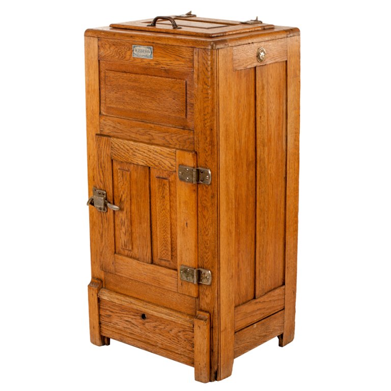

I remember the ice and milk being delivered by horse and wagon in the fifties and didn't live in the sticks. Times have changed.
We have one of these ice chests in similar condition as this google picture out in my shop that I coincidently told my wife last weekend we need to bring into the house.
