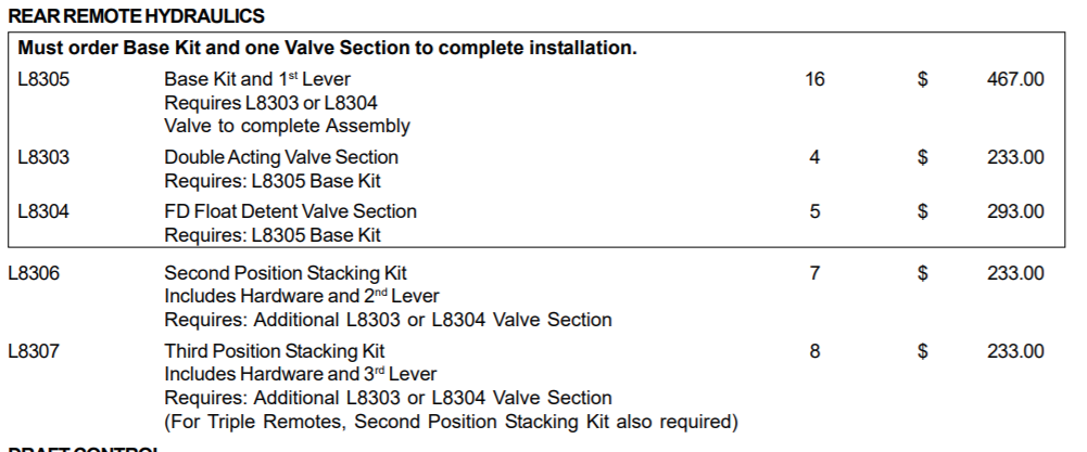

Hi Forum,
A while ago, I got a 57″ Standard Ditch Bank Flail Mower, FH-AGL145
Via asking this forum and digging through to documentation, I determined that I need a 4-way hydrolic control.
I was advised to contact my dealer , but unfortunately our local dealer(Winchester Equipment) never followed up via call or email on separate inquiries.
Where can I get an authoritative answer on what "standard" equipment is needed that I can install myself.
Where can I also order said parts online so I don't have to rely on the local dealer?
Once i have the part numbers, I can research this forum on what people have done to customize their setup (e.g. I've seen some posts using 3rd party parts to supplement or replace certain Kubota parts)
Thanks forum

Edit: based on research and confirmed with image below..
Start with L8305 base kit (includes 1st lever), which must be paired with L8303 or L8304
Add L8306, which must be paired with L8303 or L8304 if you need 2nd lever
Add L8307, which must be paired with L8303 or L8304 if you need 3rd lever
L8505: This kit includes the levers, tubes, brackets and all hoses back to the QDs (everything but the valve)?
Difference between L8303 and L8304 is detailed below (float or no float). Forums recommend going with the float as $$ difference is not significant.
Prices as of today off Coleman's equipment site
Part #L8306 2-5 DAY LEAD TIME $254.44
Part #L8303 2-5 DAY LEAD TIME $273.28
Part #L8304 2-5 DAY LEAD TIME $319.96
Part #L8305 2-5 DAY LEAD TIME $485.94
If you look at the image 2 posts below, you'll get same info "officially"
This part list is good for L3130, L3430, L3830, L4330, L4630 and L5030 tractors, which is detailed on 1st image below.
Also, called another local dealer (Keyser WV) and it was about $100 less expensive vs Coleman pricing above (L8305 + L8306, + L8304 x2 = $1286)

This post has instructions manual

Hoses from the couplers to the implement are never included. Some applications use hoses from the valve to the couplers, that's the only time you will get hoses with a tractor remote valve kit.
How would anyone know the length of the implement hoses you might need, or what style and size fitting on the implement end?
   / Proper part numbers for a 4-way hydraulic control for Kubota L3430
I expected hoses between lever kits and some existing valves, but maybe I don't fully understand yet what these hook up to.
   / Proper part numbers for a 4-way hydraulic control for Kubota L3430 #8
You will have everything you need unless there’s a shortage in a kit. No “extras” to buy.
